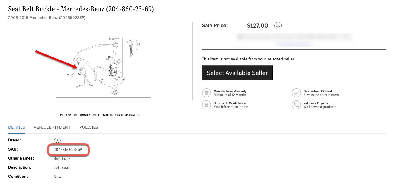

Crap! I wrote something but apparently forgot to post it. Watch this video. It's for a W203, but the W204 has the same problem. I had it happen to me. Once fixed, a good Mercedes scanner (e.g., XENTRY, LAUNCH Creader Elite BENZ, etc.) can clear the code and light.
https://youtu.be/ZYsMYki8hUw?si=8JpZvq2_LfZ9HiAA
Same. Driver side malfunction at 12 years and 154k miles. Passenger side malfunction 3 years later at 217k miles.
