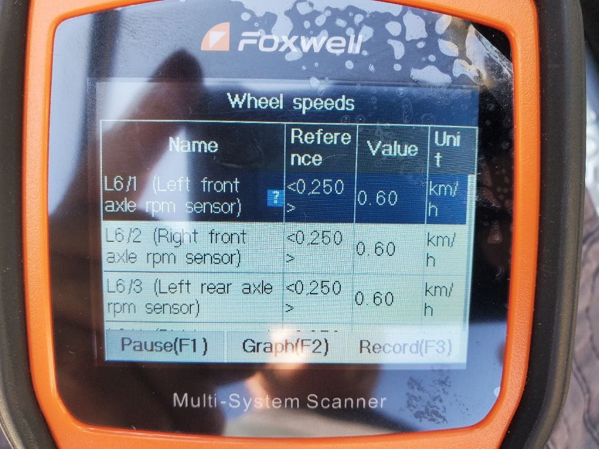

The scanner came in today and I was able to get the data of the wheel speed sensors. Is it safe to say that these are the problem? I notice that the left side seems to be off a bit and then smooths out at some points. I attached a video, let me know what you guys think. I was trying to attach a long vid but the website said it was too large.
Looks all right...
sensors
sensors
It seems normal. Do the following: enter the secret menu and check the voltage before and after starting the car. One of the problems your car is experiencing is related to low voltage.

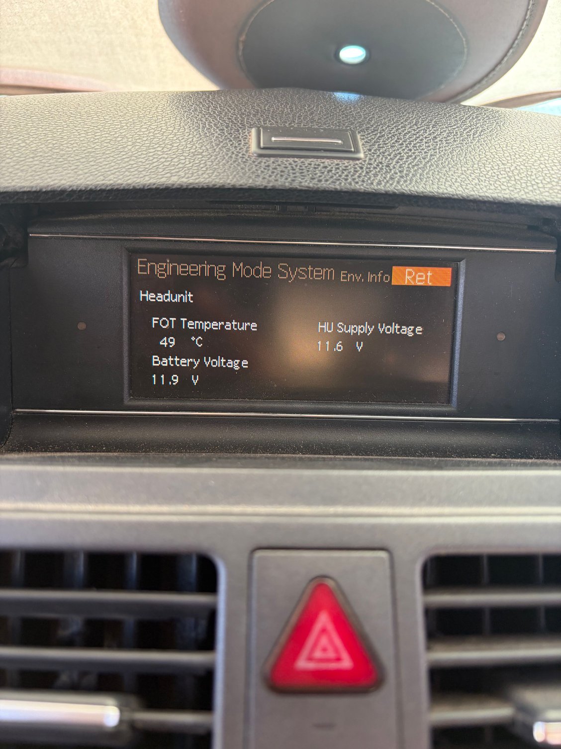

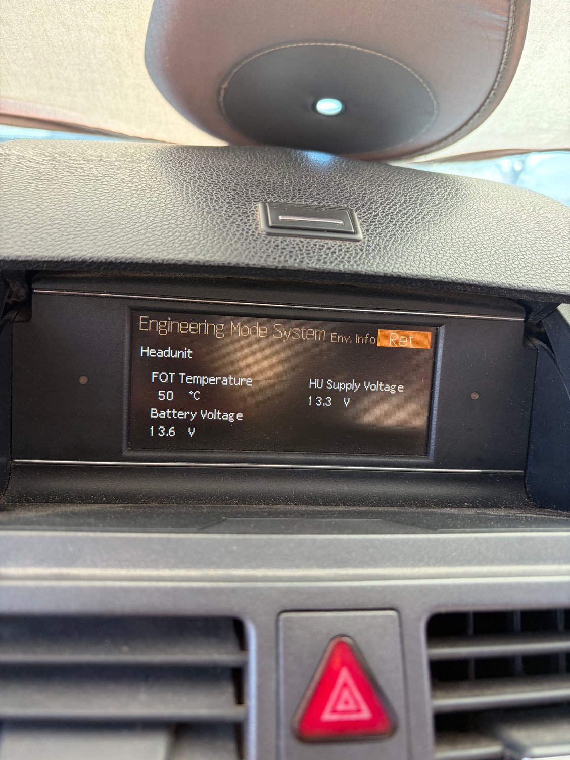

Alright secret menu now. Shows voltage of 11.9 with just key in, and 13.6 with the car on. I’ve had this battery for about 2 years now, any feedback on the battery? I’ve heard that a good battery should sit around 12.6v off, and about 14v on. Let me know, thanks. Also attached some photos.

keep voltage up
Good job activating the secret engineering menu. Everything looks okay.
The starter battery could use a good float-charge but it's not bad.
The Alt. is powering the whole car with better than 13Volts.
Try to never use battery power while the engine is stopped. The chassis is really power hungry: the radio + amp is a high load.

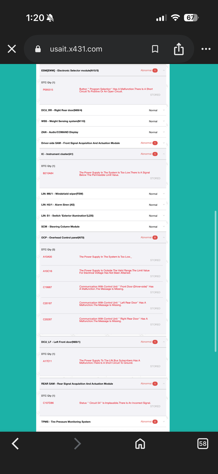

Launch Elite 2.0. I got quite a few DTCs actually but I’m pretty sure some of them are unrelated but I did attach the ones I’m worried about. Maybe that circuit 54? Let me know what you guys think

only STORED faults
notice that NONE of the faults are reported ACTIVE but STORED.
Clear all and rescan.... relieved??

Originally Posted by drizzyjay07
Ok, menu secreto agora. Mostra uma voltagem de 11,9 com a chave na ignição e 13,6 com o carro ligado. Tenho essa bateria há uns 2 anos, algum feedback sobre ela? Ouvi dizer que uma bateria boa deve ficar em torno de 12,6V desligada e 14V ligada. Me avisem, obrigado. Também anexei algumas fotos.
The errors that often occur are due to low voltage, and since this information is only stored and not active, it makes perfect sense. How did you get this information to appear on the radio display?

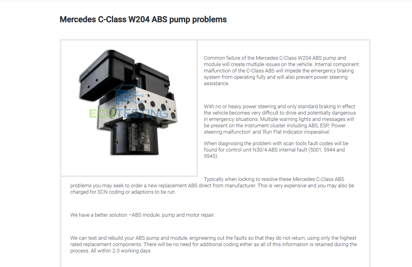

I had the abs warning pop up. Happened maybe twice since owning the car for 5yrs. Long story short it went away on its own and I havent done anything to "fix" it yet.
1st time I was actually on my way to get my cars yearly inspection when it came on. I turned around and got my scan tool and erased the code. The warning came on again while driving so pulled over and erased the code again. It finally stayed off so I immediately got my car inspected.
Then it started coming on again this past September. I stopped to get gas then the warning popped up. It kept coming on after starting the car and reaching around 15mph. This went on for 5-7 days maybe then just went away.
I was not too concerned because the car drove exactly the same, no loss of power steering. If the car did drive differently then I would have been more concerned. if the warning kept popping up i was looking in to two options:
1- Buying a used module and trying to reprogram it to my car using a Launch obd scanner. I currently have a Foxwell scanner and while it does alot it only lets me read the module and not make any changes. I have read that launch scanners have more capabilities.
2- Sending my module out to a repair shop that specializes in these things.

Wheel speed sensors seemed to be reading ok. I was only checking there operation to rule them out.
The only fault code was the 5001 for internal fault of N30/4.
When I was seeing the warning coming on this last time I was thinking the fault code was telling me what was wrong, there is an "internal fault" in the module. Something wrong with the software or circuit board. Damaged circuit boards are a bit out of my comfort zone for working with.
I found a few places to send the module out for repair when looking thru the W221 threads. A few people had good luck sending them out for repair. I forget the names and would have to go look again.
