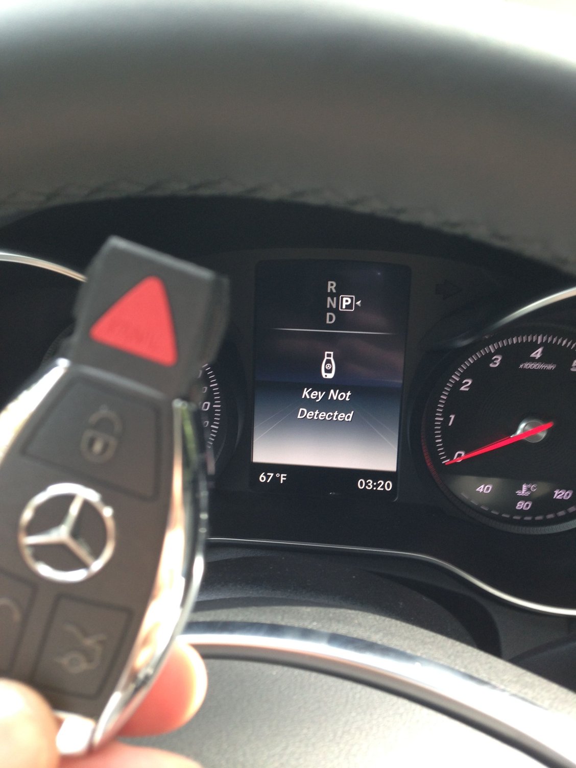

  #269
jcmarx's Avatar
Joined: Jan 2015
Posts: 11
2015 C400
Key fob recognition issue
[QUOTE=robbroy;6257374]
Originally Posted by jbbeauso
I'm experiencing a new problem. This problem has happened 2 times over the past month. I would approach my car with the key on me and try to open the door like I normally would with keyless go, only the door doesn't open. Same thing when trying the other door handles. Then I took out my key and tried using the remote unlock....didn't work either. In fact, none of the key functions worked and I was locked out of the car. This is pretty embarrassing and frustrating. After a minute of no luck, I am about to try opening the car with the mechanical key (which i'm told will set off the alarm system), all of a sudden the key works again like normal. Has anyone else experienced this? I imagine it will difficult for the dealer to troubleshoot this problem when it happens so infrequently.....[/QUOTE
I have this exact same problem, yes, embarassing. I have never had to use the mechanical key, the problem goes away if I keep clicking unlock on the remote. I wonder if the app could open it. I will try that next time I have the issue. So far I have only had it twice. But that is twice too many for what I have heard about MB quality.
Old Jan 21, 2015 | 04:36 PM
  #270
DerekACS's Avatar
Joined: Mar 2007
Posts: 1,146
From: Vancouver, BC
2015 E250 BT 4M
[QUOTE=jcmarx;6303144]
Try replacing the key battery with a fresh one, Panasonic CR2025. Even with a brand new car, the batteries supplied with the keys may not be fresh. I had to replace both of my key batteries several weeks after taking delivery of my 2015 E250BT.
