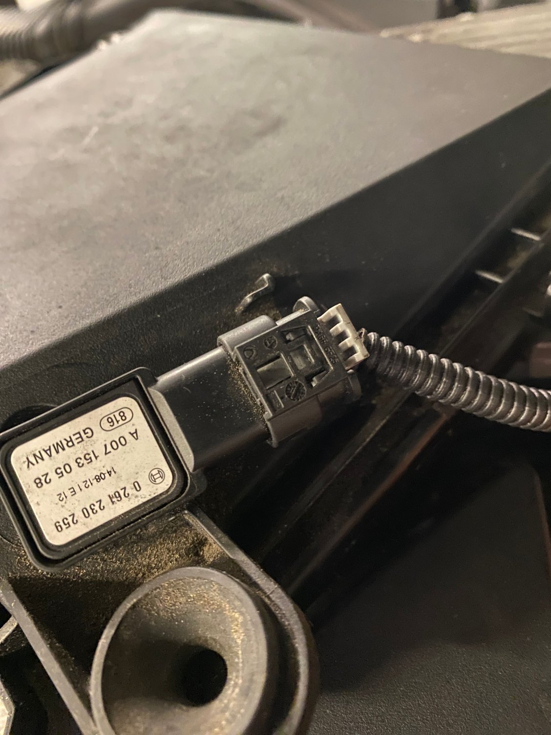

I slid the gray plastic piece over. Unfortunately I cannot remove the plug. What step am I missing?

I slid the gray plastic piece over. Unfortunately I cannot remove the plug. What step am I missing?https://cimg8.ibsrv.net/gimg/www.mbw...f56a69110.jpeg
Originally Posted by Nicholi2007
https://cimg1.ibsrv.net/gimg/www.mbworld.org-vbulletin/2000x1504/image_80242f68a367a6bf884335f382cb4ef91291bbca.jpg
If OP is trying to change the air filter, all needs to be done is to loosen the torx screws, no need to remove it from the housing, rotate the cover (do not flip it, as the screws might fall out) and replace the filter.
As for if still want to remove the sensor connector, like most MB connectors, it is a two step process, that clip as mentioned is step 1, second step is lift the tab on the other side and simultaneously pull outwards.

normally after step 1 you push down on the pulled out tab downwards and pull outwards but those are infamous for breaking, it is flimsy plastic. So hence why I recommend going from the front and using a hook tool to lift the tab then pull outwards instead.

After all, OP the tab you loosen as per step 1 is what holds that step 2 tab/clip.

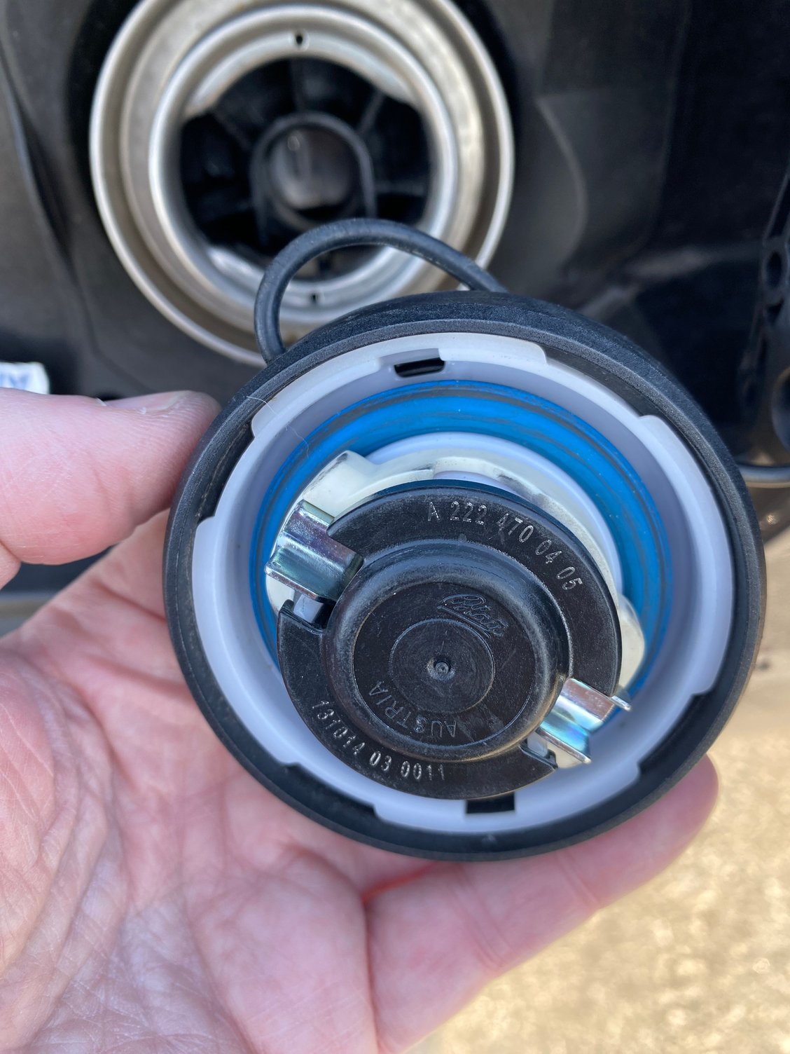

Here’s the gas cap. Lot of dirt.

How did that (dirt) get in there?
I don't know. It's very tough to turn. Super stiff. The seal does not look bad per se.
I guess some rubbing alcohol.
Hmmm, that is so strange. Especially given the fact that gas cap has a string so you can't accidentally drop it on the floor and contaminate it. So how did dirt get in there.
I took out the seal and cleaned it. It seems slightly better. Mechanic thinks the metal tab of the tank receptacle might be bent
but I don't think that's right. It's clearly too tight.
A new seal is $6.00. A new gas cap is $56. I suppose the cap could be defective when they make 1,000s.
