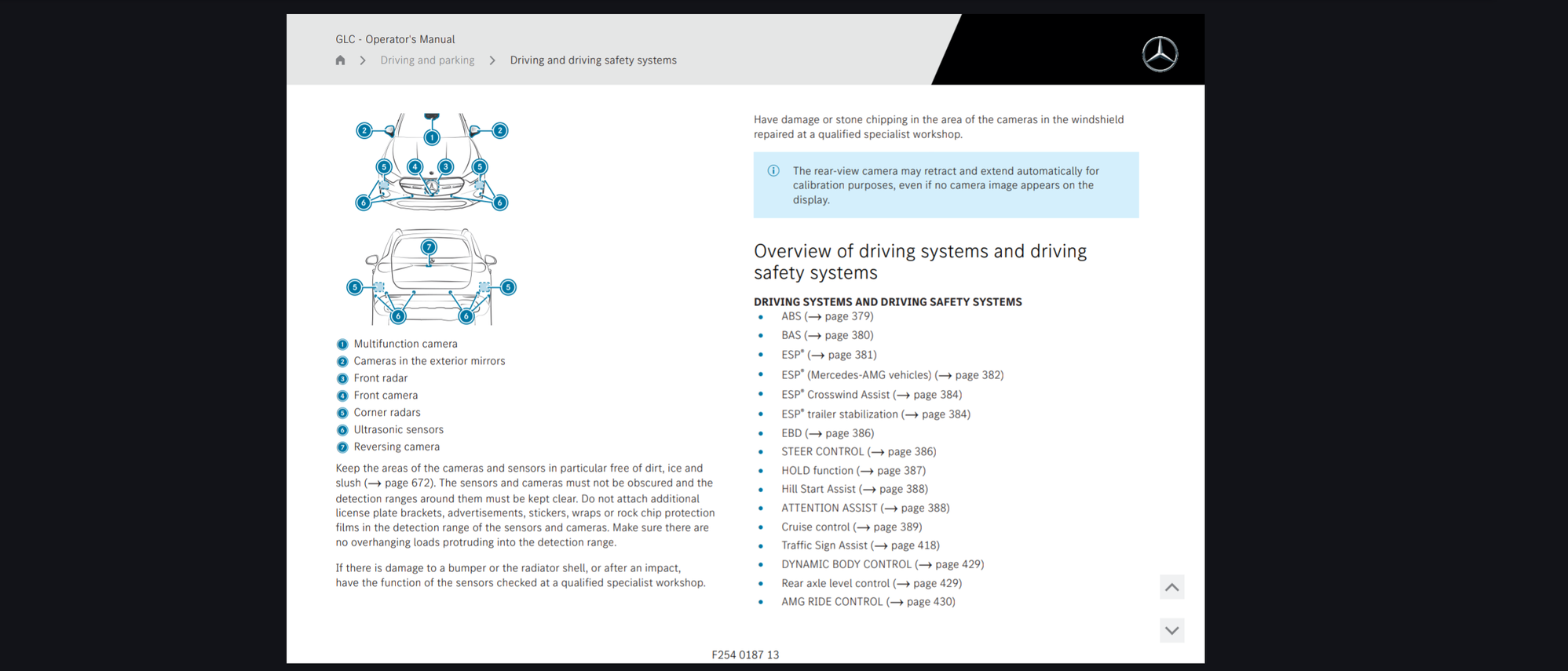

If it helps, this message appears to be included in the operators manual of the 2025 GLC in the Driving and driving safety systems. So its a known thing for Mercedes.
The rear-view camera may retract and extend automatically for calibration purposes, even if no camera image appears on the display.
That we know but it wasn't necessary though. Never had an issue with calibration before the change with older MB models.
