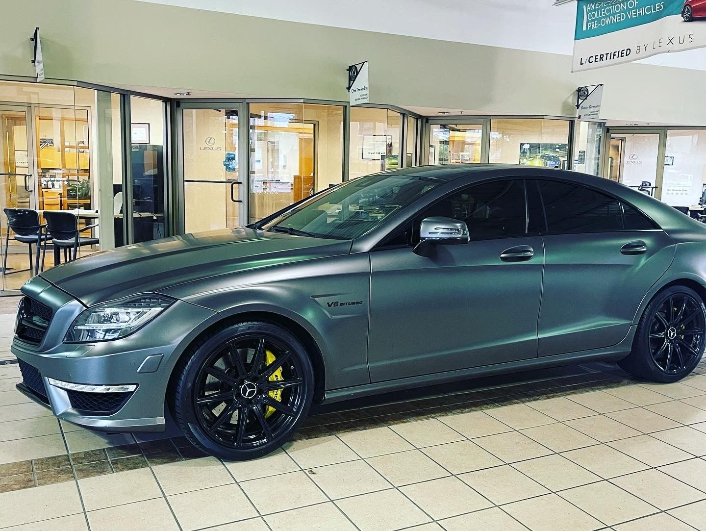

2014 CLS63 S AMG
Driver’s Side Front Axle Creak/Squeak
I just picked up a 2014 CLS63 S AMG a couple of weeks ago, and I have noticed a squeaking/creaking noise coming from the front left axle. It occurs when entering/exiting the vehicle, while driving the vehicle, and if you just push down on the hood or rock the vehicle while it’s sitting. Anyone else experience this?
