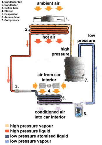

Got your message. I understand refrigeration & Aircons & a bit about thermodynamics. I don't know the C32 particularly well or your mods. That said - can we try and establish exactly what we are measuring here. Is it Inlet Air Temp or refrigerant temp & where is the sensor in the circuit - I will do some scratching but will you please try & establish this. Does your coolant temperature creep up in unison with IAT or Refrigerant temperature? (maybe not as much but do you see a rise) Do you have a touch thermometer and are you able to take a temperature at the Aircon condenser unit at the radiator? May be difficult to get a representative reading with radiator influence??? An evapourator temp would also be useful.
Is the (radiator) electric fan operational & does it kick in during these idle periods? (It should not 115F is only 46C). I doubt that changing the coolant will make any difference. Are you however sure that there is no air in the system & that it has been properly bled?
Is your aircon operating normally?
I presume your worry here is IF this is a raise in IAT it will compromise power output? Let's understand what you are really chasing here or is it just the difference between your & Mike's cars.
I really think that this is some minor heat soak while stationary.
Let's go back to basics see pics below:
Can we establish what we are measuring and at what point we are measuring it.
Attached Thumbnails opinion on refrigerent temp/IAT temp read out-aircon-diagram.jpg   opinion on refrigerent temp/IAT temp read out-air-20con-20motor.gif
