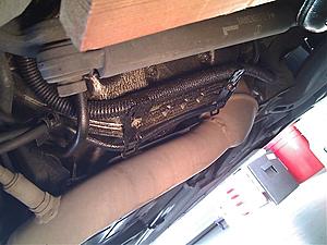

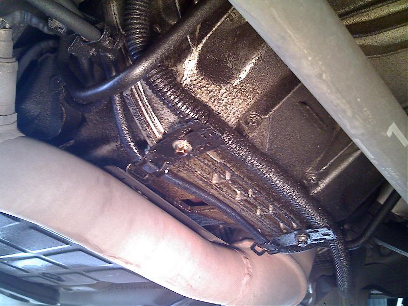

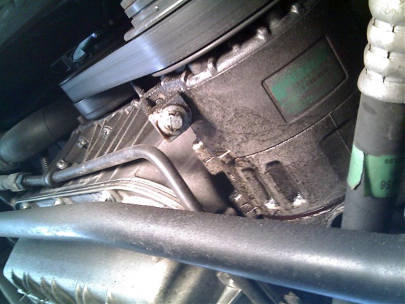

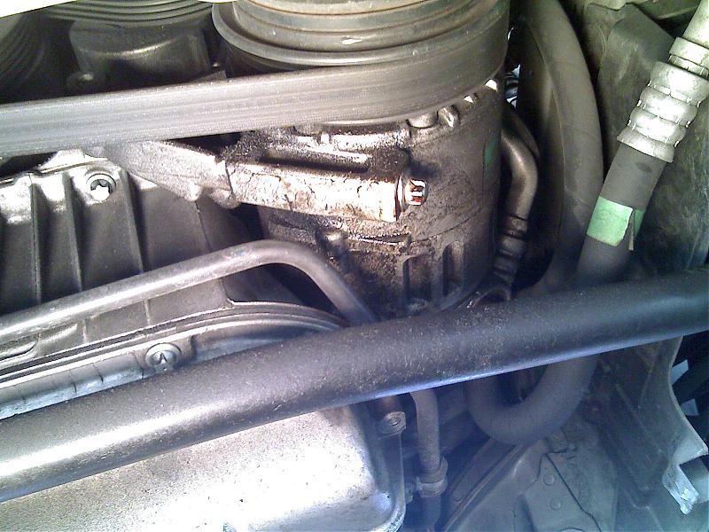

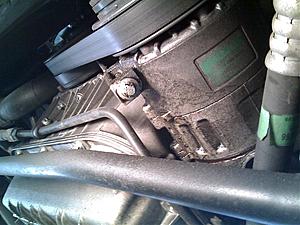

Hey Guys,
I changed my oil today and noticed these two areas underneath my car to be coverered in a shiny oily liquid. I've noticed it before but it seems to be getting worse for some reason. One is behind my oil pan and the other I think is the AC Compressor. It doesn't drip on my garage floor, so that's a good thing I guess, but it just seems to be covered in this layer of goop which does not make me feel confident in it's condition.
Could somebody let me know what exactly I've looking at and if it is serious enough to make repairs? How much will these parts/repairs cost me?
Thanks guys.

just spray the area with berrymans or pj1 then run it for a day. you'll see where the leak is.

rear main seal-very common on 112 an 113 engines-front leak is possiblt from front cover psi plug cap running down

On the CLK55, there's an oil cooler next to the filter. I believe the o-rings harden and leak with age. Do C43's have that same oil cooler? If so, and the o-rings are leaking, I remember reading a "how-to" in one of the CLK55 forums. It was a rather simple fix.

Right, i have the same leak on mine, the oil is coming from the cooler just before the oil filter and fall on the AC compressor...

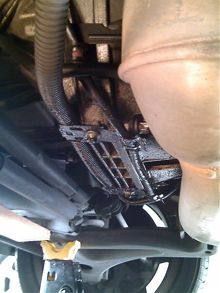

Reading through the replys I think I'm going to check my rear main seal as I still have a little oil on the trans like in the picture...

based on the amount of oil I cleaned up on mine I would say your leak is more than the oil cooler alone. It was very specific to the front area. I say this because mine is dry and the tranny pan still has a little oil on it, which I need to investigate.
I would get a mirror, check all sides of the oil cooler and clean it good. Check the bolts for tightness, then proceed. It may just be that the bolt(s) could be a liitle loose. You may get lucky.
