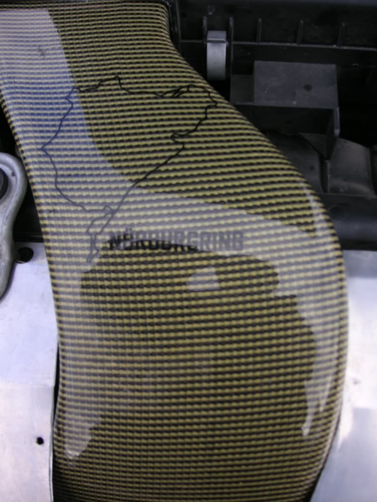

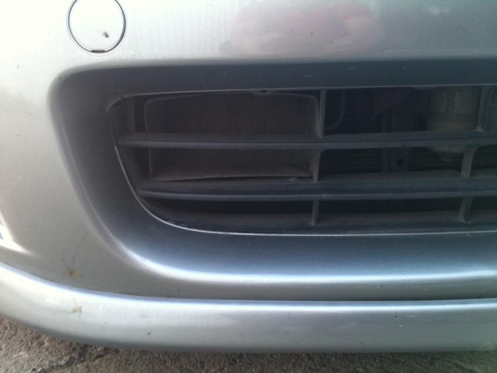

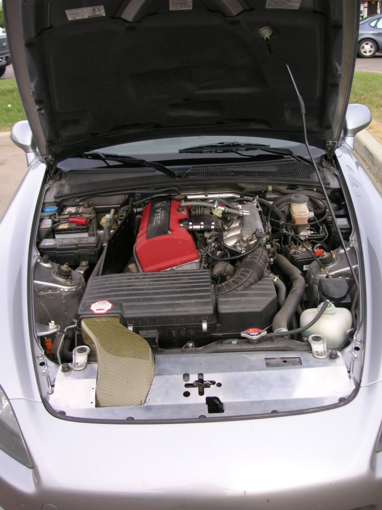

Here's some pix of my S2000 for comparison. The intake is a Spoon replica - same shape, same mounting point, without the JDM pricetag! Nurburgring sticker adds 50hp too.
Anyway, the intake sits quite low to the ground, much lower than the grille on the C43. I'd be surprised if opening up the area on the C43 grille results in much more crap getting into the airbox. At any rate, all the stuff is stopped in the airbox by the filter.
I remember one of the S2000 guys, with a similar Spoon style intake, finding a dead mouse in his airbox. Ewww...it does provide an access point into the airbox for little critters.
Yesterday at Home Despot I picked up a roll of screen door material. I'm going to fix that to the intake on the S2k, and maybe on the C43 too.

I see you have the 50hp sticker on the CF intake pipe. Nice and clean job.

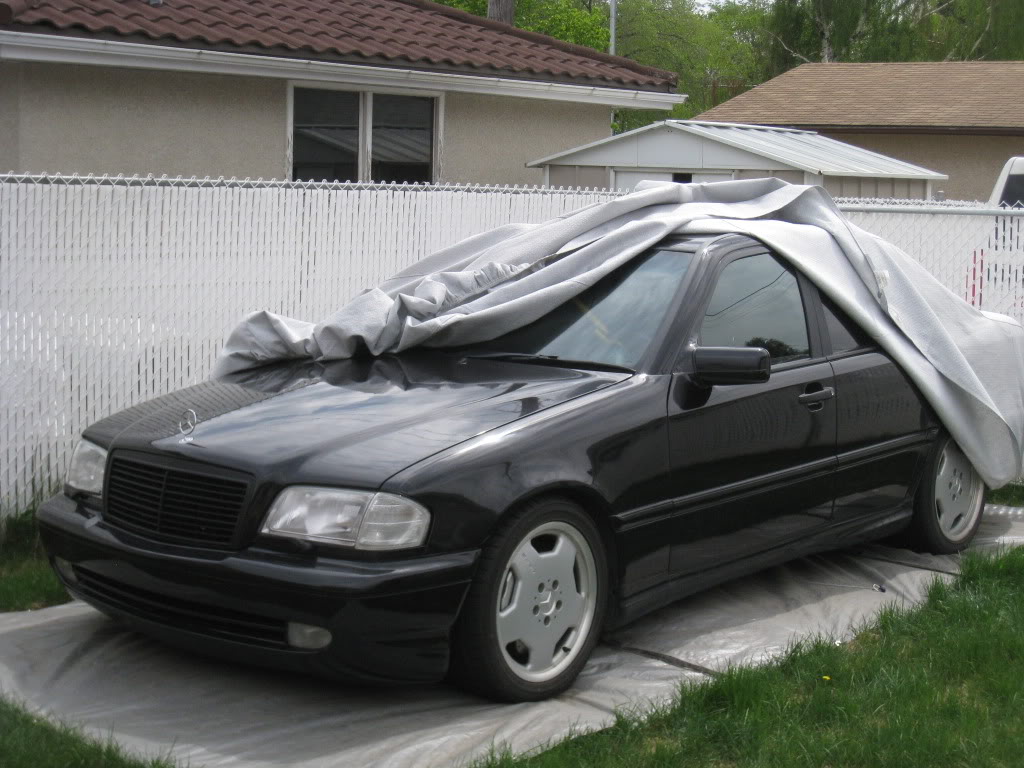

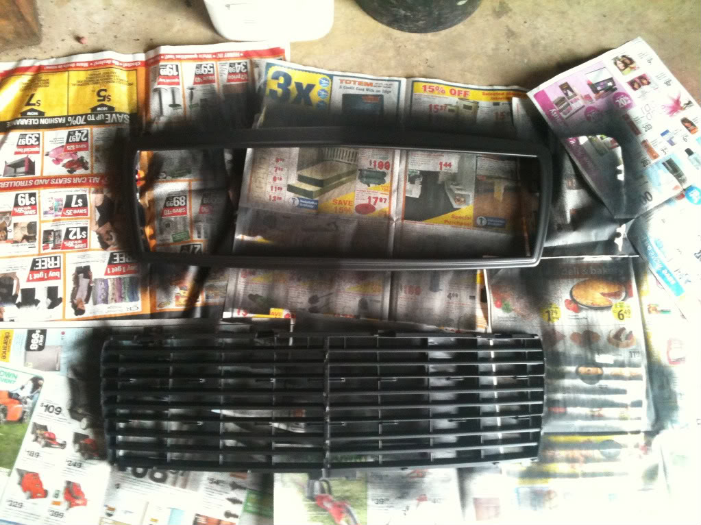

Back to AMG talk, here's a pic of the grille after two coats of Plasti-Dip.

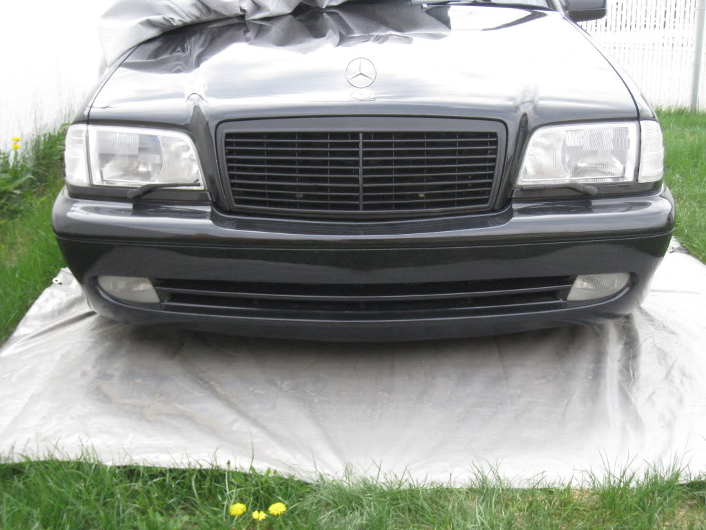

Got the grille fitted back to the car, and thankfully too.
I didn't manage to finish my supercharger install on the S2000 over the weekend, so I'm driving the C43 this week. About 90% done, just need to tidy up some wiring and hoses, and should be good to go. Didn't want to rush last night, so going to finish it off this weekend.

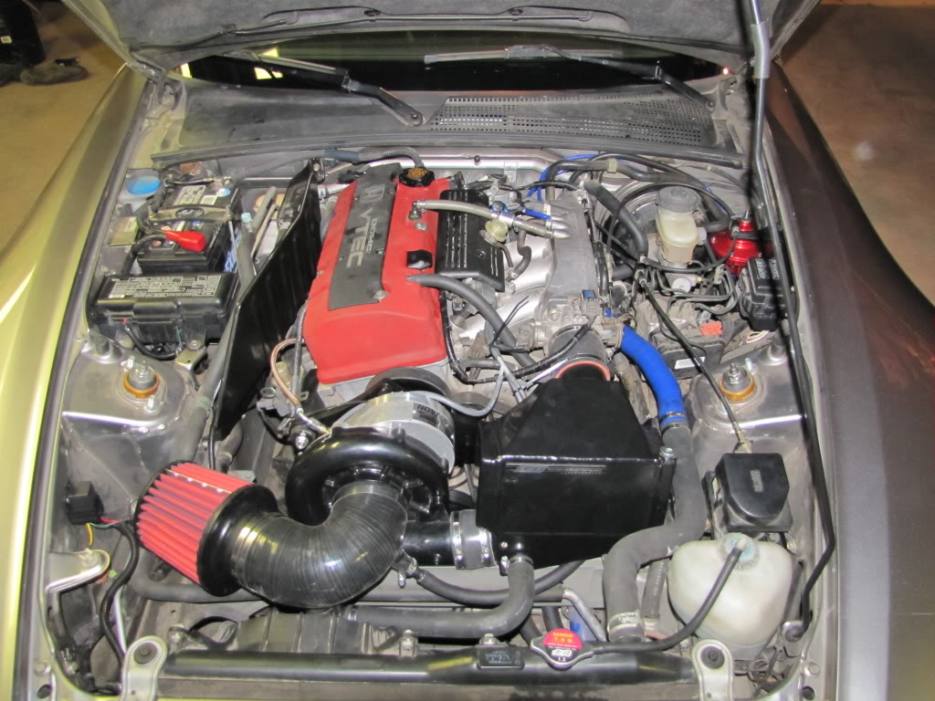

Here's a pic of the grille and some pix of the charger install on the S2k:

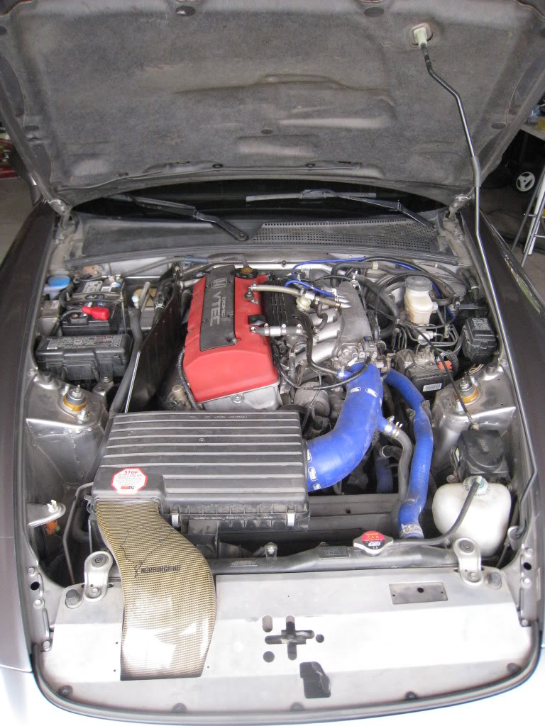

Starting out with an NA S2k with some mild mods:

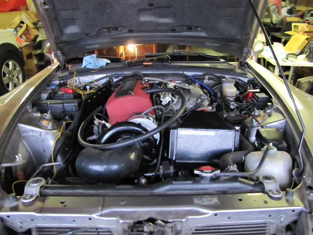

...to nearly finished supercharger kit install!

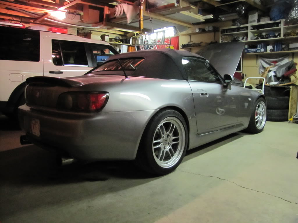

Here's the finished product on my S2000:
and another photo for kicks:

So hows the power??? Are you satisfied with the finished result?? How does it compare to the C43?
Old May 31, 2011 | 07:56 PM
  #289
Saaboteur's Avatar
Joined: May 2009
Posts: 1,846
Likes: 29
From: Canada
eclectic assortment of cars
Yes, very cool, I like the charger a lot. It doesn't fundamentally change the character of the car, just adds power in a very linear way, just with a lot more of the same.
A lot of the larger components utilize OE Honda fasteners, which was very impressive. Unfortunately, once installed you can't see a lot of the bespoke brackets made by Science of Speed, the maker of the kit. They are gorgeous anodized black aluminum pieces.
Compared to the C43....the S2k is still feeble in the torque game! Stock the S2000 has about 155 ft lbs of torque (the torque spec to bolt up the crank pulley 192 ft lbs!!). With the charger, that's up to about 250 ft lbs, so stock the C43 still has more torque, but of course weighs 700 lbs more than the S2000. The S2k now should put out about 300rwhp, give or take, about a 100hp jump from stock.
Still have to wind up the S2000 to make power, but that's fine, that's the character of the car and why I like it. The C43 is very different, which is why I'm glad of having both.

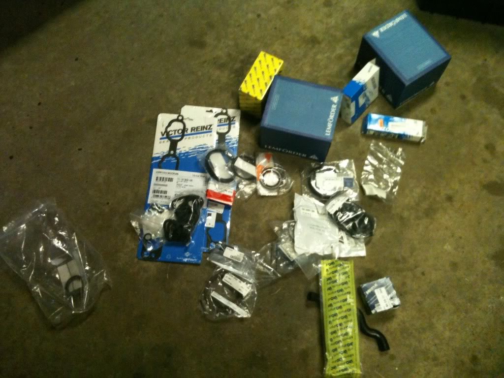

Went on road trip to Vancouver and northwest Washington, came back with piles of goodies!
There's about $300 worth of seals, gaskets and engine mounts in that photo (might have some S2000 stuff mixed up in there too though).
Now I can start tidying up the 55 motor and get it ready for the swap.

me lajk the LEMFÖRDER parts.
Deutschen qualität über alles

Yeah, the Lemforder is good stuff. Unfortunately, some of the parts were Meyle. I had one of their replacement fuel pumps and it was crap. Hopefully they can make a half decent seal though!

Nice black grille by the way. What exactly is "Plasti-Dip"? Is it a brand name?
