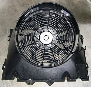

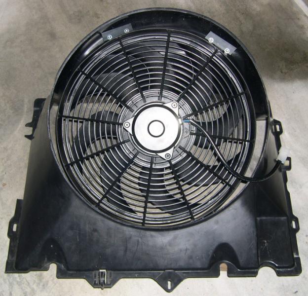

Let me see if I’ve got this right, someone dyno’d their car, swapped a pulley, dyno’d it again and picked up 15 HP. On an NA car. The alternator, water pump, cooling fan, AC compressor (which freewheels when it’s not on), and PS pump are "slowed down", and THAT freed 15 HP?
On most cars with a mechanical fan, that is the biggest drag. I’ve built and tested electric fans (not for MB). They work.
Attached Thumbnails Anyone have an underdrive pulley kit installed?-temp-efan.jpg
