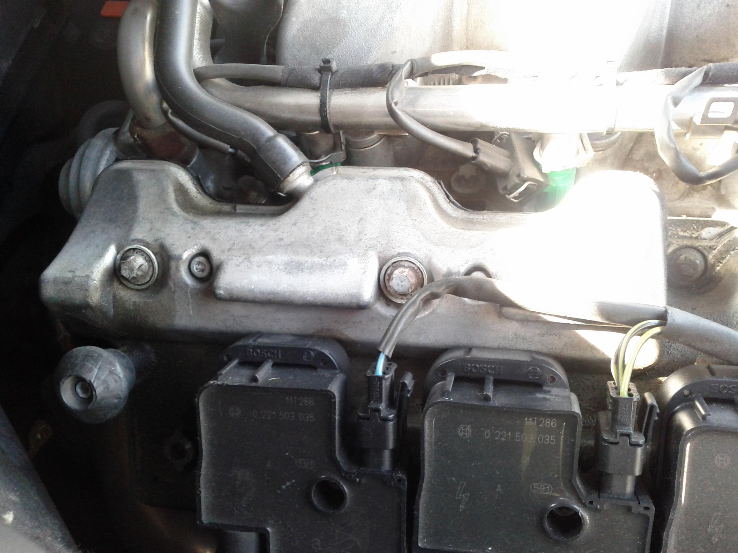

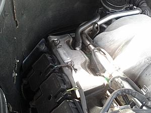

Could someone help me identify this part? I'm guessing it is the pcv valve but I may be wrong. I need to replace the gasket between this part and the valve cover. Any help is appreciated.
Thx

Do you mean the mushroom head at the back..?

The full metal cover with the hose attached to it. The other end of the hose connects to the MAF sensor. Thx

This is a breather cover (part of valve cover), it's one of the most common oil leaky failure during the age..!!

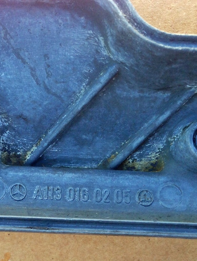

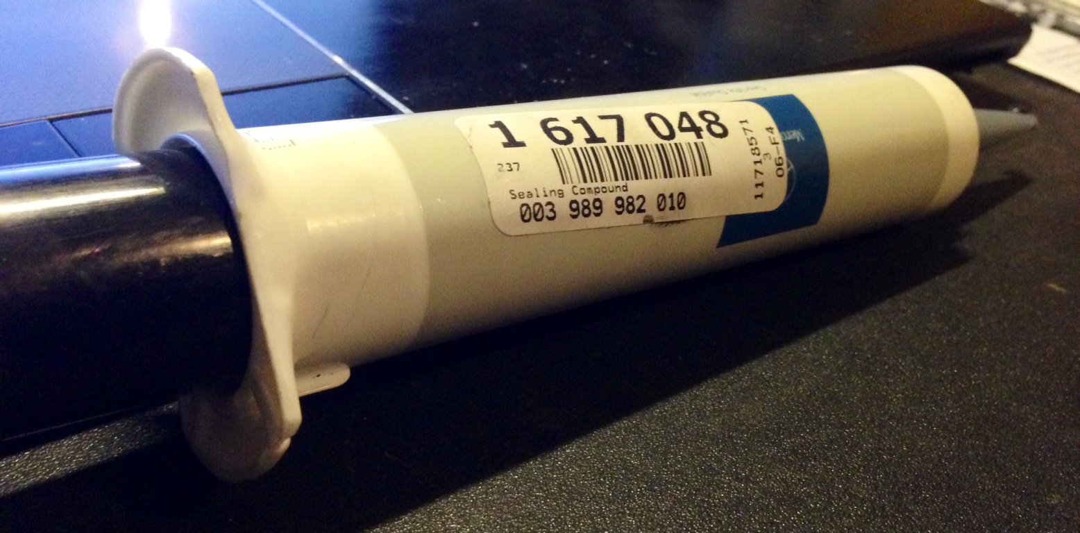

The gasket used to seal the breather to the valve cover is a black sealing compound PN 003 989 982 010 comes in a 50ml tube around $18 should be enough to do both breathers.
When I did mine I took pictures of the PN of both breathers..
Driver side = A113 016 02 05
Passenger side = A112 016 05 05
Attached Thumbnails Part identification?-photo-1.jpg   Part identification?-photo-2.jpg   Part identification?-photo-3.jpg
When I did mine I took pictures of the PN of both breathers...
Passenger side = A113 016 02 05
Driver side = A112 016 05 05
Thanks so much! You saved me from having to search the part #'s. I appreciate your help!

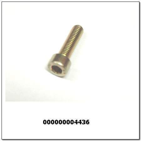

Just a little FYI. The (5) aluminum bolts are NOT reusable. There are 2 on the passenger side breather cover and 3 on the driver's side breather cover. They are replaced by newer stainless steel bolts. Part# 000000004436.
Cheers
Old Jun 11, 2014 | 12:58 AM
cm60k's Avatar
Joined: Aug 2006
Posts: 7,053
Likes: 398
From: A.D., U.A.E
Good info. D..,
of course SS bolts are Excellent,,

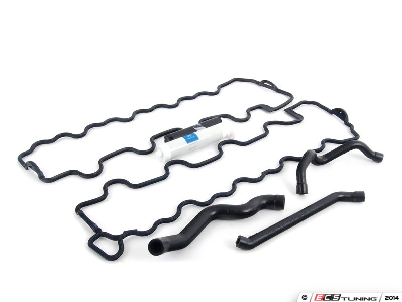

We have Valve Cover Gasket Kits available on our website for your C43. These kits include both left and right valve cover gaskets, breather hoses and genuine Mercedes-Benz sealant.
You can get to the Valve Cover Gasket Kits by clicking HERE, or by clicking on the photo of the Valve Cover Gasket Kit Below.
We also have the replacement breather cover bolts available as well. You can get to them by clicking HERE, or by clicking on the photo of the bolt below.
