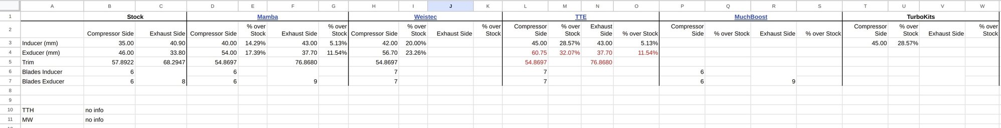

Actually, one of the main reasons (apart from power) for me was to keep the engine off the stress of that extra power as much as possible.
That's why I also want to add the auxiliary radiator in the right wheel arch, and perhaps if not enough, also the "horizontal" one see my thread here where I talk about these radiators (in Image 1 that is the number 1 radiator), and even perhaps split the transmission and intercooler circuits via the MW or ZAC kits.
I did also some research on the available turbo upgrades and from the information available I thought that the TTE upgrade should be best, especially for its price, note that the numbers in red are implied based on the Trim values from the Mamba and Weistec upgrades.
For Weistec I used the image they provided on their website and counted the difference in pixels between the two images to get to the size of the compressor wheel (given that I knew the stock values from the Mamba upgrade). There is really not much info on the rest, but I suppose I understand their reasons.
About the deliberate placement of smaller turbos on this engine - I agree, this engine is very capable, it could very easily rival the 278 and 157 especially due to the fact that they are very prone to scoring if you tune them, also their Garett turbines turned out to be really weak (hot side cracks, Tasos documented both issues extensively). What I think is that the 3.5 liter version of the m276 with larger turbines would easily beat the m278 in both reliability and performance. By the way Garett (for gasoline engines) turned out really poorly for Mercedes; IHI in the M276, and BorgWarner in the m275/279 and m176/m177 hold well.
