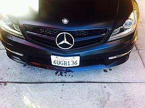

Well, I got bored and blacked out the horizontal bars in my main grille today. I didn't want to have to modify more than necessary, so I wanted to remove only the chrome front pieces. As it turns out they come off pretty easily: Just slide them towards the outside and push out the outer chrome trim ring a little to give them clearance to pull towards you and release.
I sanded the pieces with 120 grit paper on a rubber block and then sprayed them with a couple coats of Dupli-Color gloss black and a couple coats of Dupli-Color clear. They match the glossy plastic backing bars almost perfectly.
Anyway, here's a poopy cameraphone shot of the results and I'll post some better pics tomorrow after I get a chance to shoot it with my real camera:
Josh

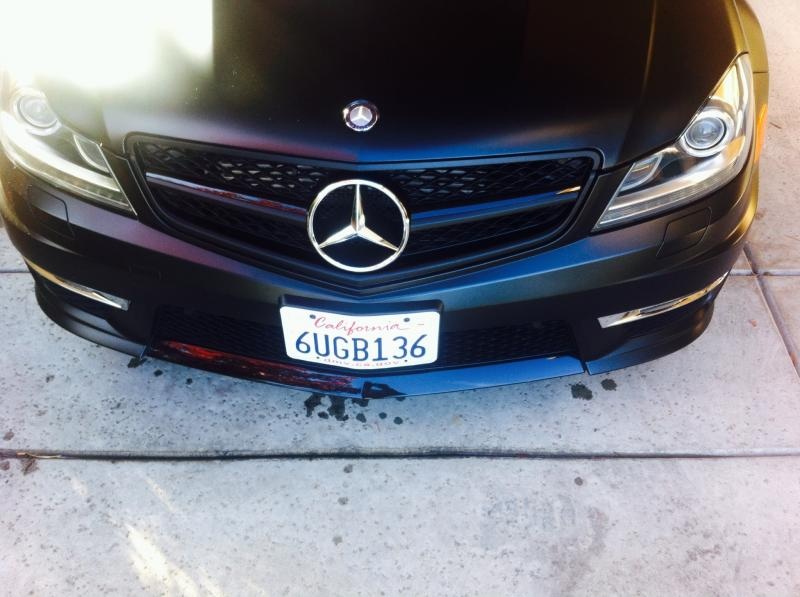

I know this is an old thread, but I thought the OP's instructions on how to remove the chrome grill bars was very helpful. I don't have pix yet but removal was very easy, which made vinyl wrapping much easier. Just be careful with the tabs because their are a little fragile.
Reply 0
Nov 15, 2013 | 10:49 PM
Here are my photos. Sorry it's already dark outside. Thanks to emeric for sending me his leftover glossy black vinyl!
