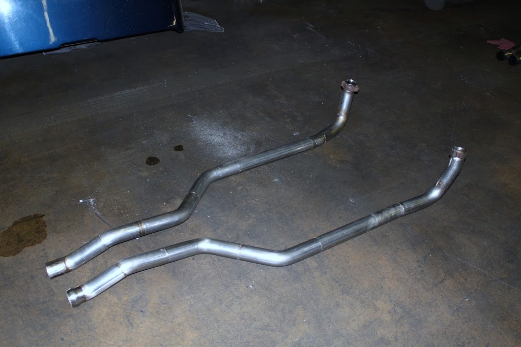

Many of you know that I've been on the hunt for a down-pipe solution since getting the car.
My goal has been to 1) pickup an additional 15 RWHP/RWTQ for track days and 2) have a 100% bolt-in/bolt-out solution.
A local master tech (well known to a few of us C63 owners in the PNW) took on the Super-pipe project yesterday. I'm quite impressed with the early outcome.
Below are some pics of the Stainless Steel Catless Down-Pipes/Test Pipes. They are 2.5" in diameter; same as the OEM pipes. These are unfinished (only tack-welded) but wanted to give you guys a sneak peak.
This is 100% bolt-in from the exhaust manifolds to the resonators. No welding or cutting to your stock system is needed. Install/Removal can be done in 30-45 mins on a lift. They'll work with the stock manifolds or PLM manifolds.
Note: I'll be using mechanical O2 simulators (DIY risers) for the rear sensors to prevent a CEL. A quick Google of "Mechanical O2 Simulator" will give you an idea of what I'm using. I'll post more in my write-up when complete.
The O2 bungs and final welding will be done tomorrow. Final photos, dyno graphs, timeslips and a full write-up will come Wednesday night!

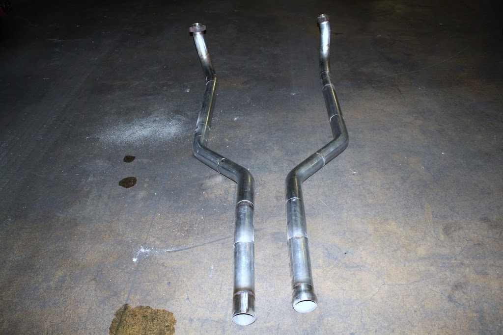

The pipes:

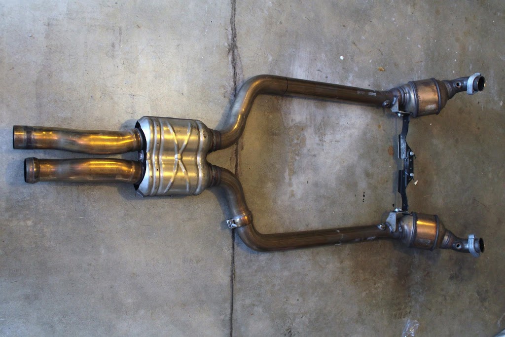

What they are replacing:

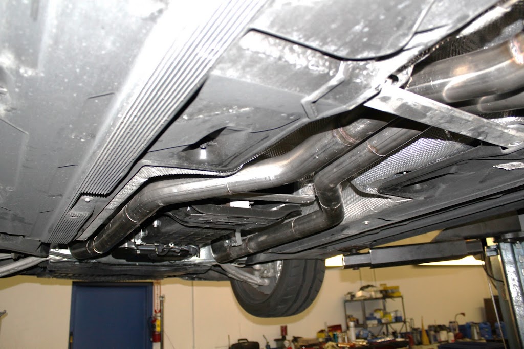

Test-fitment is spot on!:

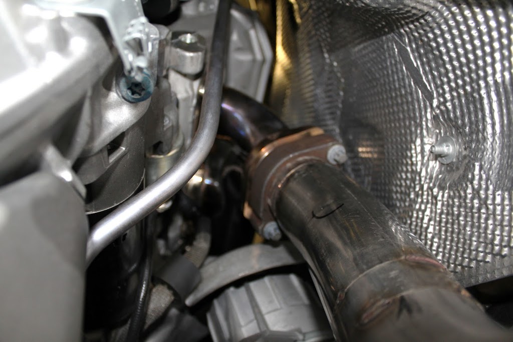

Mated to the PLM manifolds:

Will they work with KLEEMANN manifolds??
I am very intrested...
Old Jul 19, 2010 | 02:02 AM
superlubricity's Avatar
Super Moderator Alumni
Joined: Dec 2009
Posts: 2,189
From: USA
2011 GLK 350, 2013 GT-R, & 2013 RAM 1500
Negative.

Superlubricity,
The product looks far beyond what I expected, very nice indeed. The problem that I see is people putting something similiar on a bone stock car and really messing with the AFR very bad.
On a bone stock car removing the 4 cats and putting a 02 simulator got to screw the AFR readings badly, would you agree? my .2c
We'll see what happens with AFR on Wednesday. I have a hunch the ECU will adapt.

From: Vegas and Vancouver, BC
Can't tell from the pic, but is there any room to put in resonators or will it be too close to the body/heat shield?
Old Jul 19, 2010 | 01:38 PM
Joined: Dec 2009
Posts: 2,189
From: USA
Yes, there is room to add high-flow cats, resonators, or even bullet mufflers. Coming up with a swappable solution for sound control is next on my list.

Nice work superlubricity. This looks awesome and looking forward to your write up and videos. That is exactly what I would be looking for if the set up is not insanely loud. I hope your friend is willing to duplicate your set up for a reasonable price.
It appears that the end of the custom pipes fit on the stock resonators. Am I correct?
