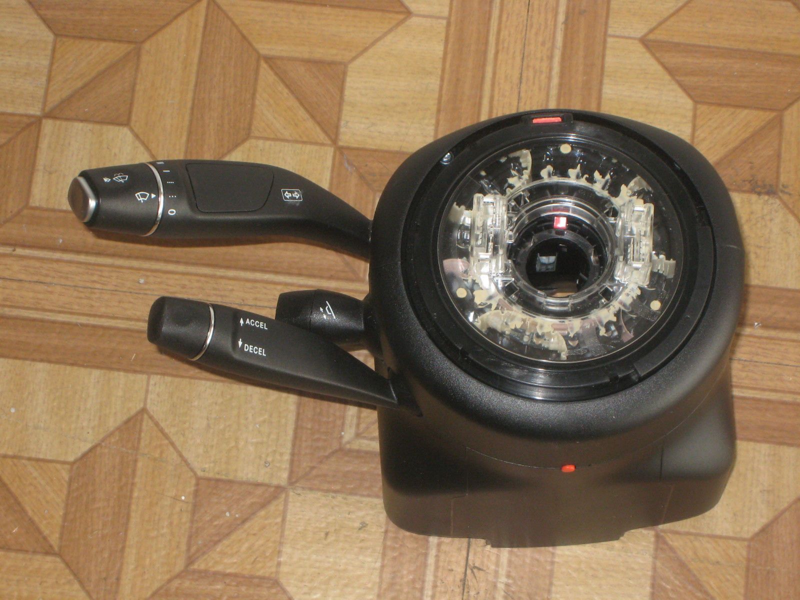

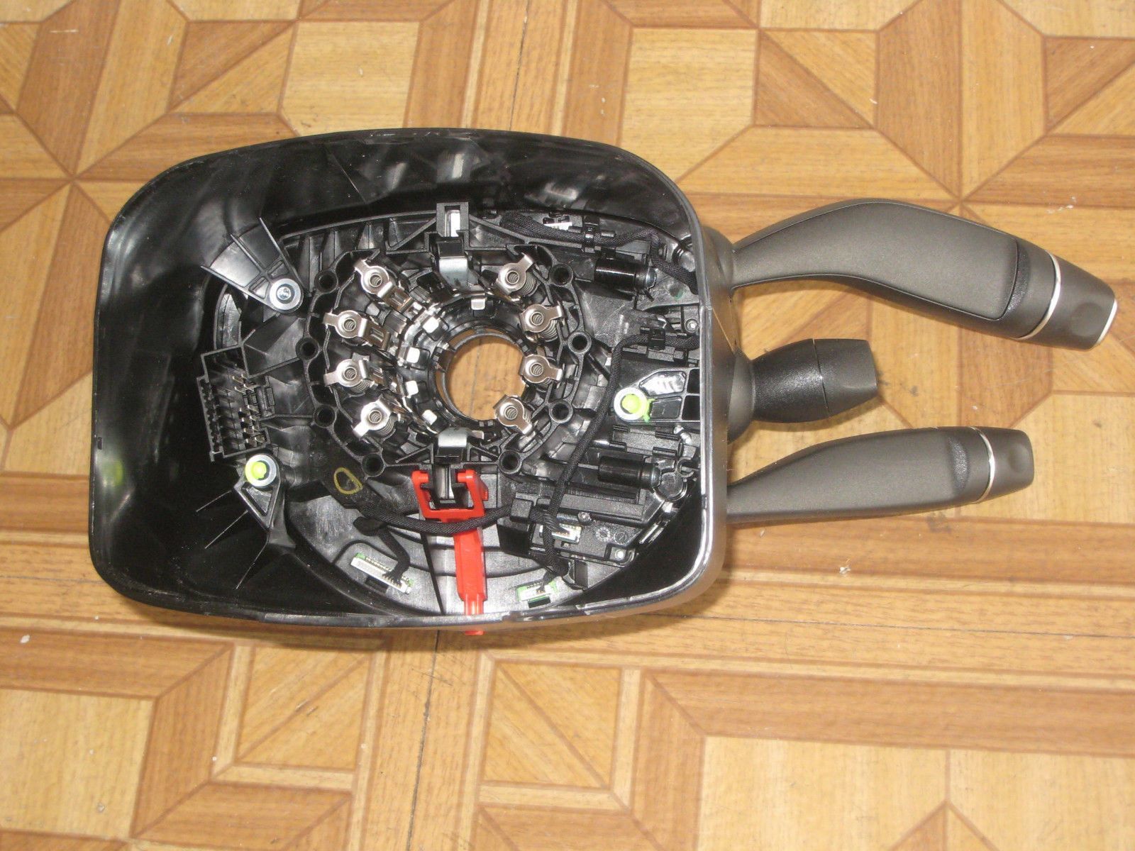

This is what i bought. That part number listed above didn't work for me:

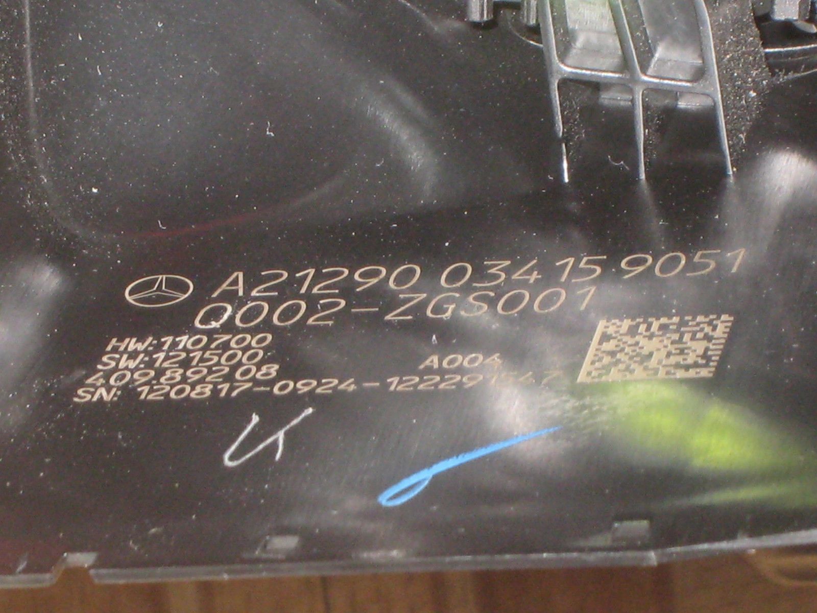

Thanks gain abcut973 and others that replied, I too was having trouble with that part number, I am in Australia so maybe they are different part numbers, pictures are great, I was not sure if it was one assy. i came up with 20790033009051,
