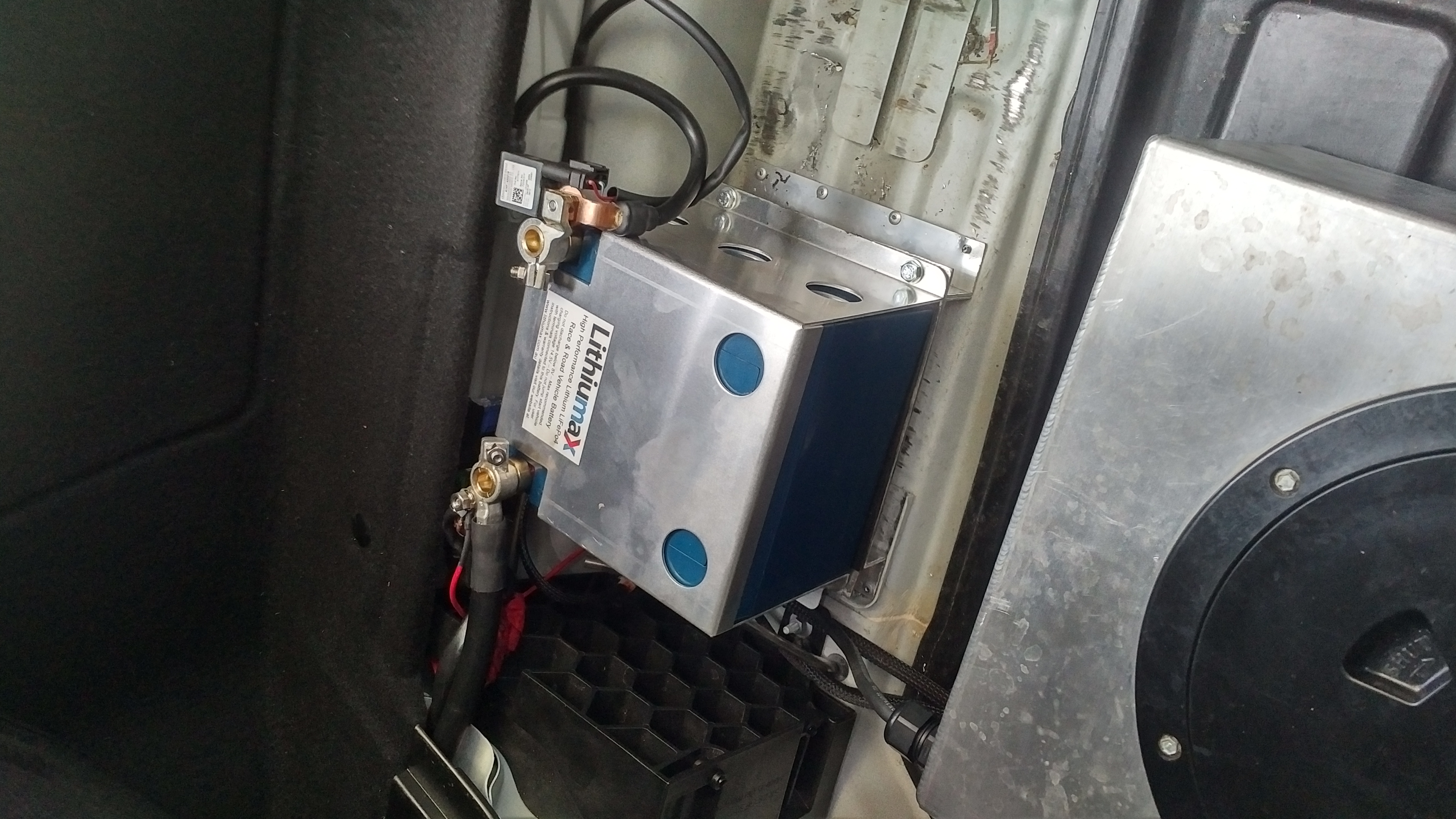

Old Sep 19, 2016 | 06:47 PM
mr747's Avatar
Joined: Aug 2012
Posts: 3,398
Likes: 371
c63
this is my version 850 CCA every day use 3 kgs
Attached Thumbnails Anyone using a Braille or lighter-than-oem battery?-battary.jpg
That is sweet. Lithium gives you the best of both worlds. Lightweight and powerful.
It works great mate
It works great mate
im probably going to go lithium too next spring....
what battery is that ?
Old Sep 19, 2016 | 08:24 PM
mr747's Avatar
Joined: Aug 2012
Posts: 3,398
Likes: 371
c63
http://www.lithiumax.com.au/

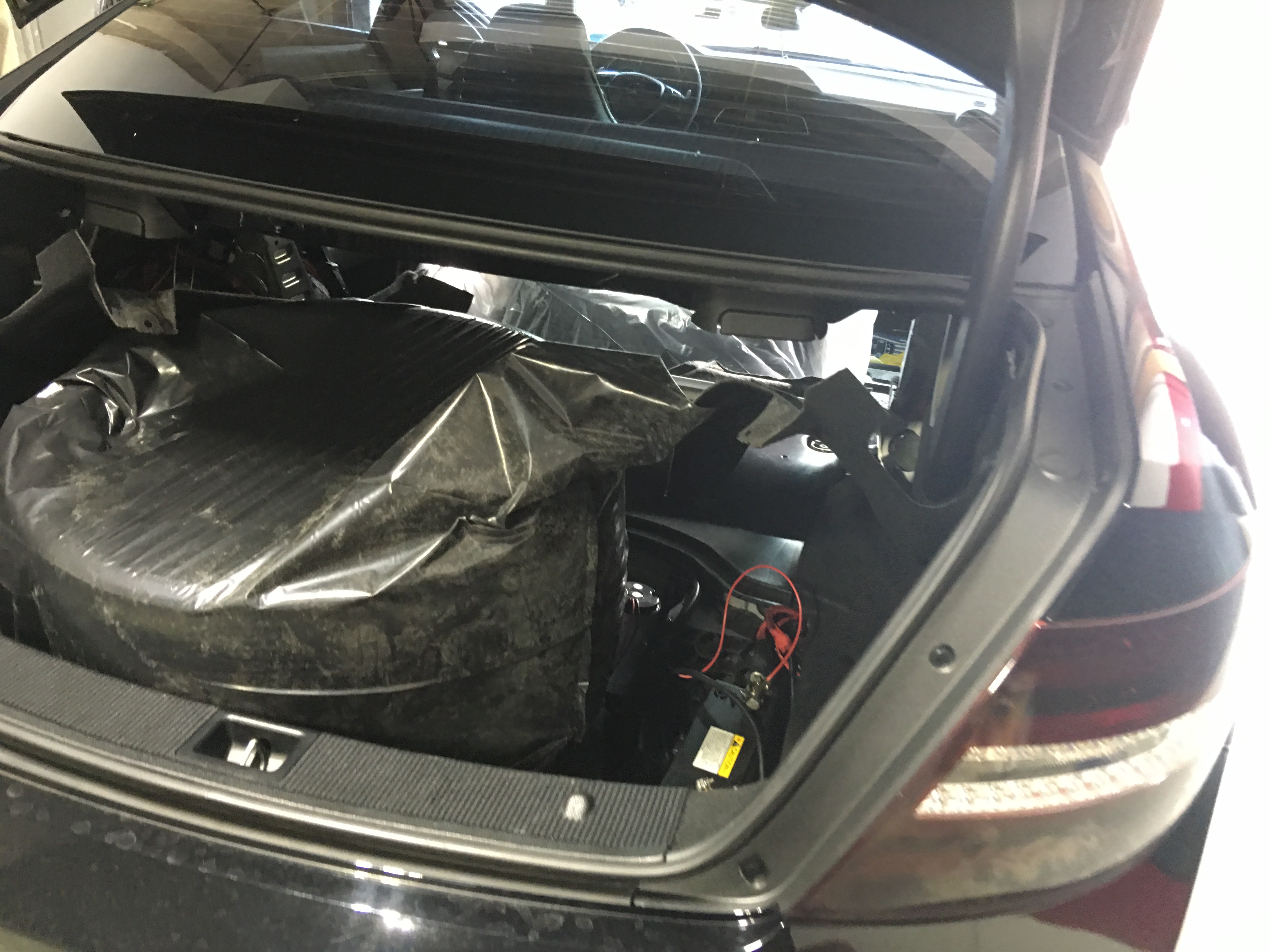

Old Sep 19, 2016 | 11:49 PM
gzim335's Avatar
Joined: Jun 2013
Posts: 660
Likes: 110
c63 coupe p31weistec stg3 SOLD,2013 C63 BLACK SERIES.
Voltphreaks 7lb,you can dd with it no problem
Attached Thumbnails Anyone using a Braille or lighter-than-oem battery?-img_0032.jpg
Where can on find this battery
Old Oct 1, 2019 | 02:59 AM
bradsm87's Avatar
Joined: Jul 2019
Posts: 45
W204 C63 Wagon
I'll give you a hint. Scroll up two posts
