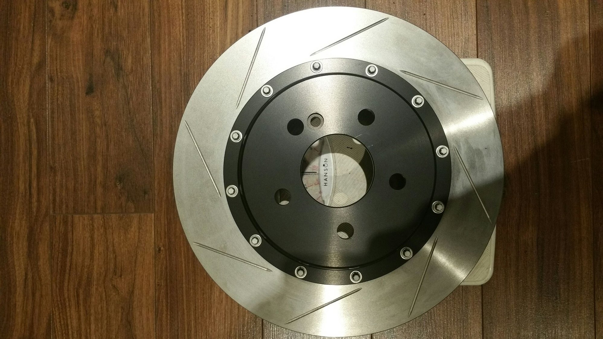

Mine is nothing particularly fancy unfortunately. It has an iron liner on the inside for the parking brake. Here's stock vs the ones that have just been fitted. Stock is ~10.5kg (although this pic shows ~10kg, i know), new is 7.3kg (according to a digital scale).
