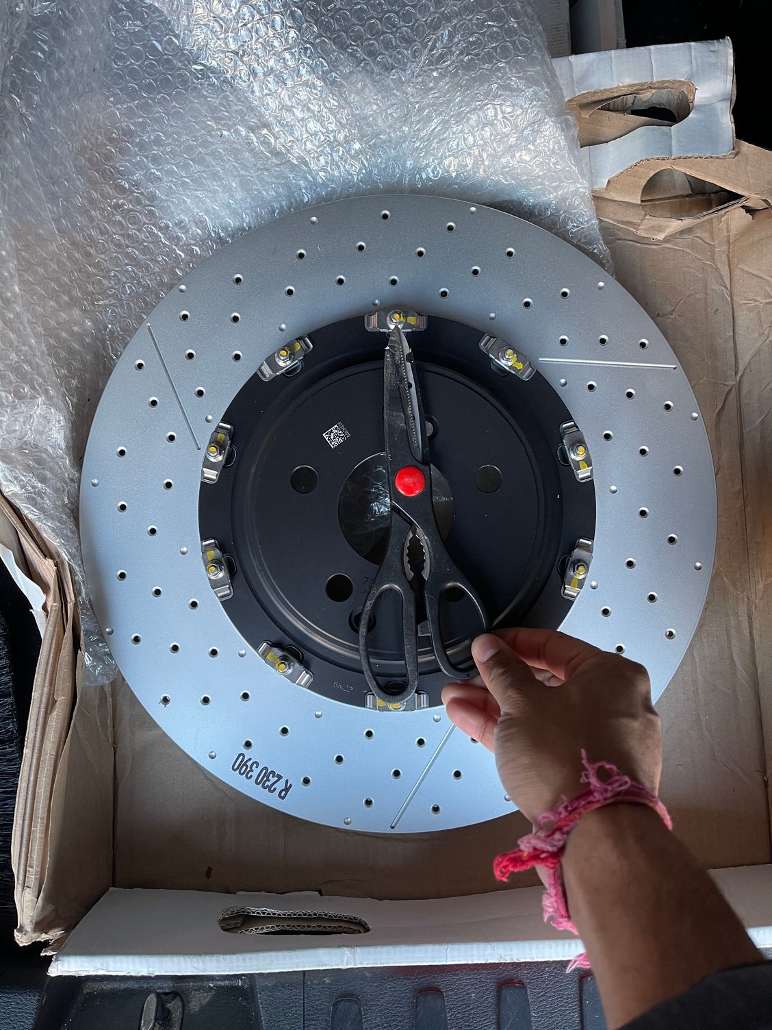

These 390’s are huge. Ordered the epytec brackets. Should be here in a couple weeks.

The epytec brackets are steel compared to the 350 aluminium Ones on eBay.
that’s probably the main reason of the cost difference.
I prefer buying the whole kit with the bolts etc. Just less things to get after with the eBay brackets.
