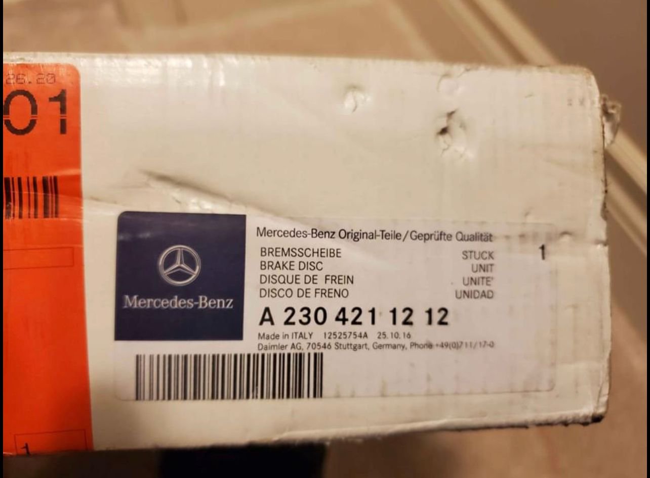

Hey guys just wanted to verify fitment before I pull the trigger on an OEM 09 SL63 rotor set for the front. Part number below. I know they are 390mm but unsure of thickness
Old Feb 20, 2021 | 02:26 PM
  #64
cm60k's Avatar
Joined: Aug 2006
Posts: 7,053
Likes: 398
From: A.D., U.A.E
They are (36mm) thickness, and fits all 63's, including BS with (390mm) calipers..

Yup - that's a 390 x 36 mm rotor used on the front of several x63 and AMG GT cars, including the C63 BS.
Old Feb 20, 2021 | 03:12 PM
  #66
Kriston's Avatar
Joined: Jan 2010
Posts: 2,276
Likes: 409
C63 AMG
thank you! So these will work on the c63 with calliper adapters.

Please help me verify:
between this and the other big brake threads, to do front and rear brake upgrade to fit my stock 507 19" wheels as well as my aftermarket 19" track wheels would take;
-The 390mm front rotors from fcp or mercedes A2304211212, or RB rotors
-the ebay front caliper brackets linked by MBNRG to get the stock 507 wheels to work
https://www.ebay.com/itm/MercedesBenz-AMG-C63-W204-390mm-Brake-Bracket-upgrade-C63-Black-Series-/324435447162?_trksid=p2349624.m46890.l49292
- 4 of the YFS Grade 12.9 70mm length bolts referenced by BLKROKT for front caliper brackets, is there any mercedes part number or link to the exact bolts needed?
-the 360mm rear rotors (mercedes or RB), can someone help.with mercedes part number to compare with RB rotor cost?
-rear Caliper - Mercedes-Benz (212-423-68-98)
-rear Caliper - Mercedes-Benz (212-423-69-98)
-and the rear calipers will mount up with my stock 507 hardware with no extra brackets or longer bolts?
Thanks for the help
-The 390mm front rotors from fcp or mercedes or RacingBrake A2304211212
https://www.ebay.com/itm/MercedesBen....m46890.l49292
Thanks for the help
I don't know if you already have some of the parts or can get some of the more expensive pieces (like the rotors Kris got) at a good price, but if you don't and are looking at replacing EVERYTHING in your list at what they go for from the usual sources, I suspect that you'd be much better off going with an aftermarket BBK setup from Brembo, Wilwood or the like. It would also be cheaper in the long run when the time to replace pads and rotor rings comes, and you'd have a much better choice of brake pad compounds.
