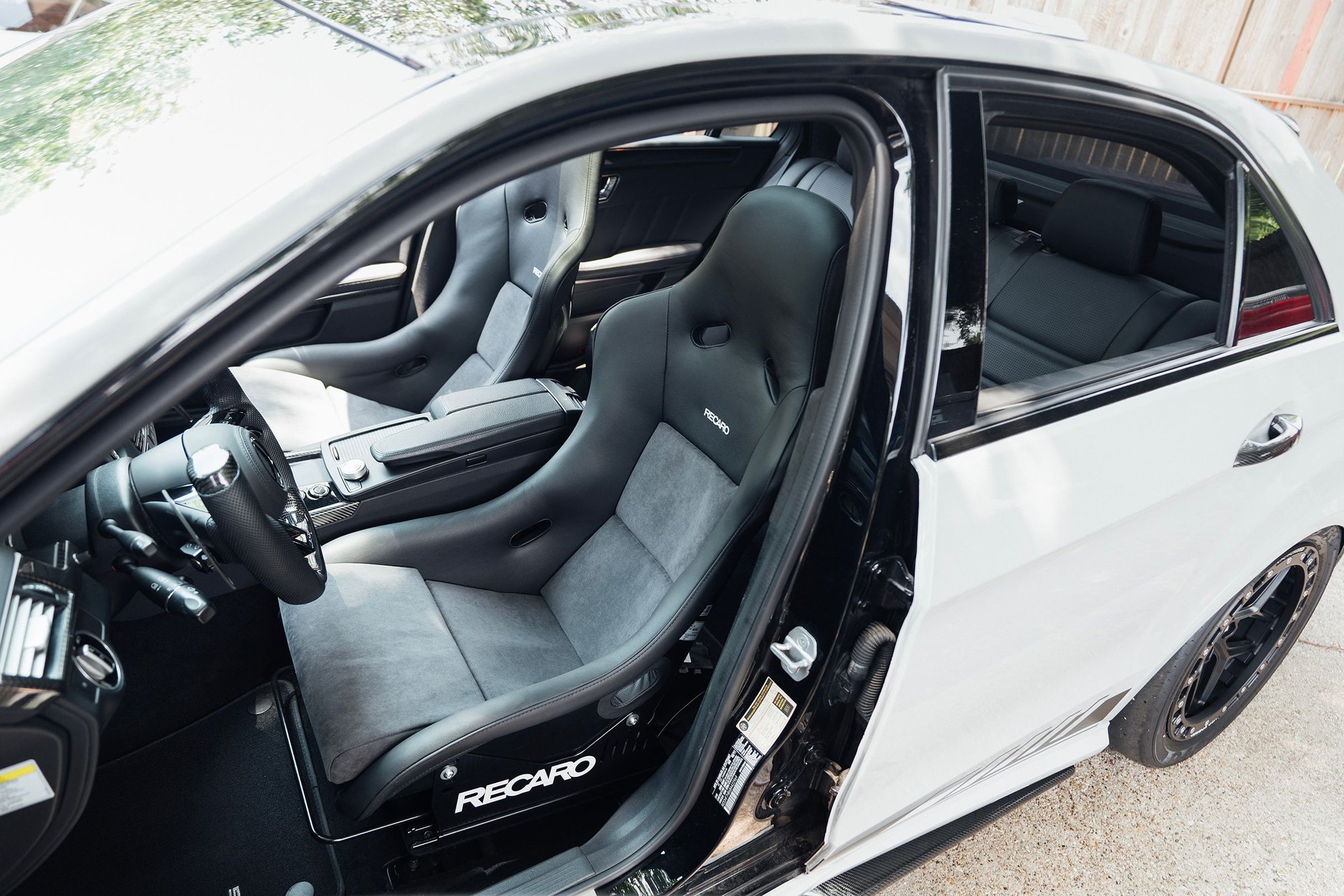

Test fit the passenger RECARO seat today - fits like a glove. I can confirm, W204, W211 and W212 all use the same seat mounting brackets.
Also weighed the factory E63 seat and it came in at 70 lbs. Swapping both seats should net around a total of 70lbs~ weight reduction.
Quick teaser pic.

Looks great, did you use Recaro seat frames or the planted ones? Will you code the errors out or use resistors? Also does the steering column not move now? (As I know it works with the seat)

Those look great. Where did your source the Recaros and the type?
Perhaps it would be worth doing a seperate thread for future reference purposes, if you have the time

Planted mounts with Recaro seat frames and sliders. I'm gonna try to code out the airbag codes with Xentry first, if that doesn't work I'll use resistors. For the steering column I believe there's a small module in the factory driver's seat that I can transfer over to the Recaro mounts to retain adjustability of the steering column.
I ordered everything from @Highline-Autos.com, he's an authorized Recaro vendor and will give you a solid deal.
I'll take some good photos once everything's installed and put together a thread for future reference.

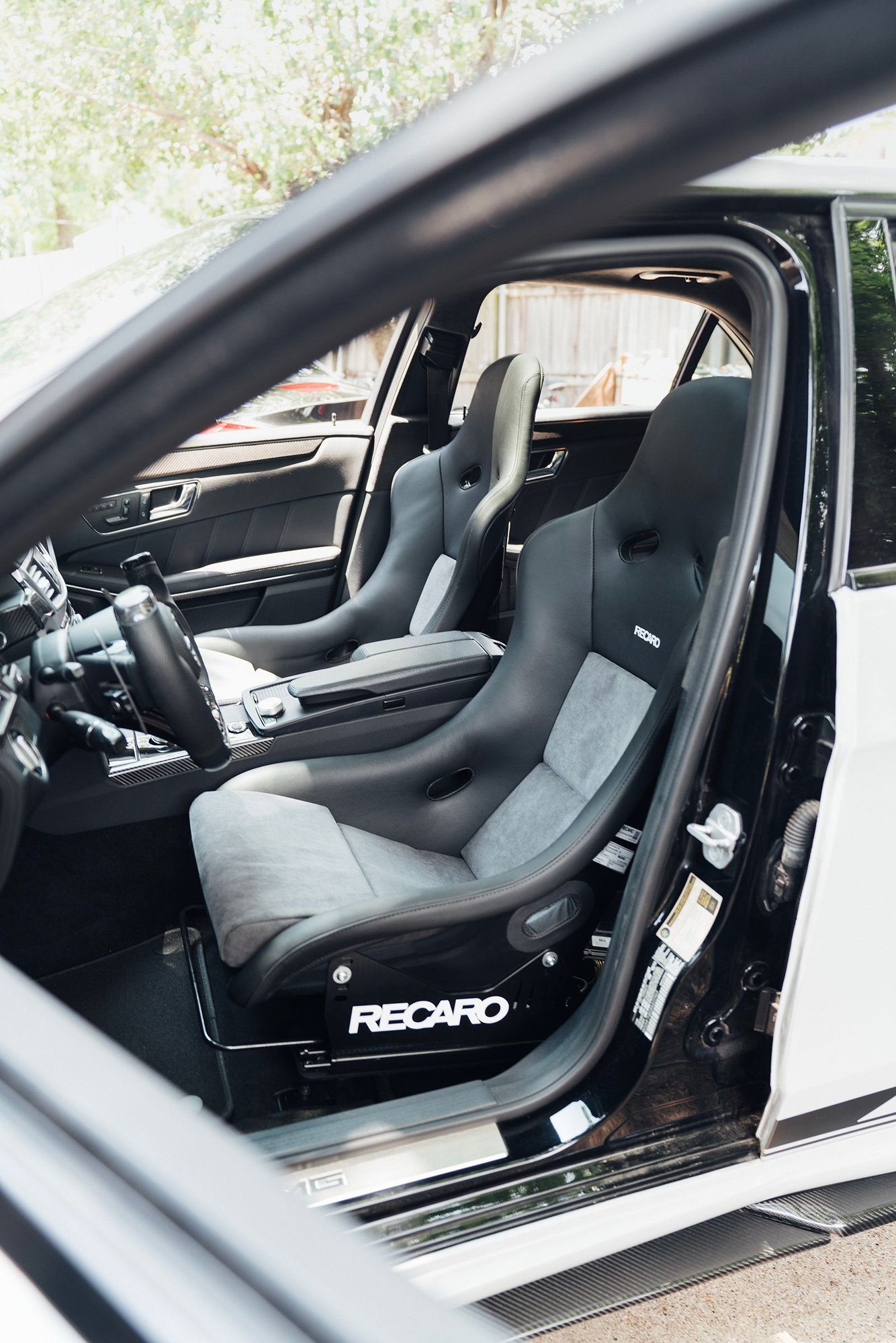

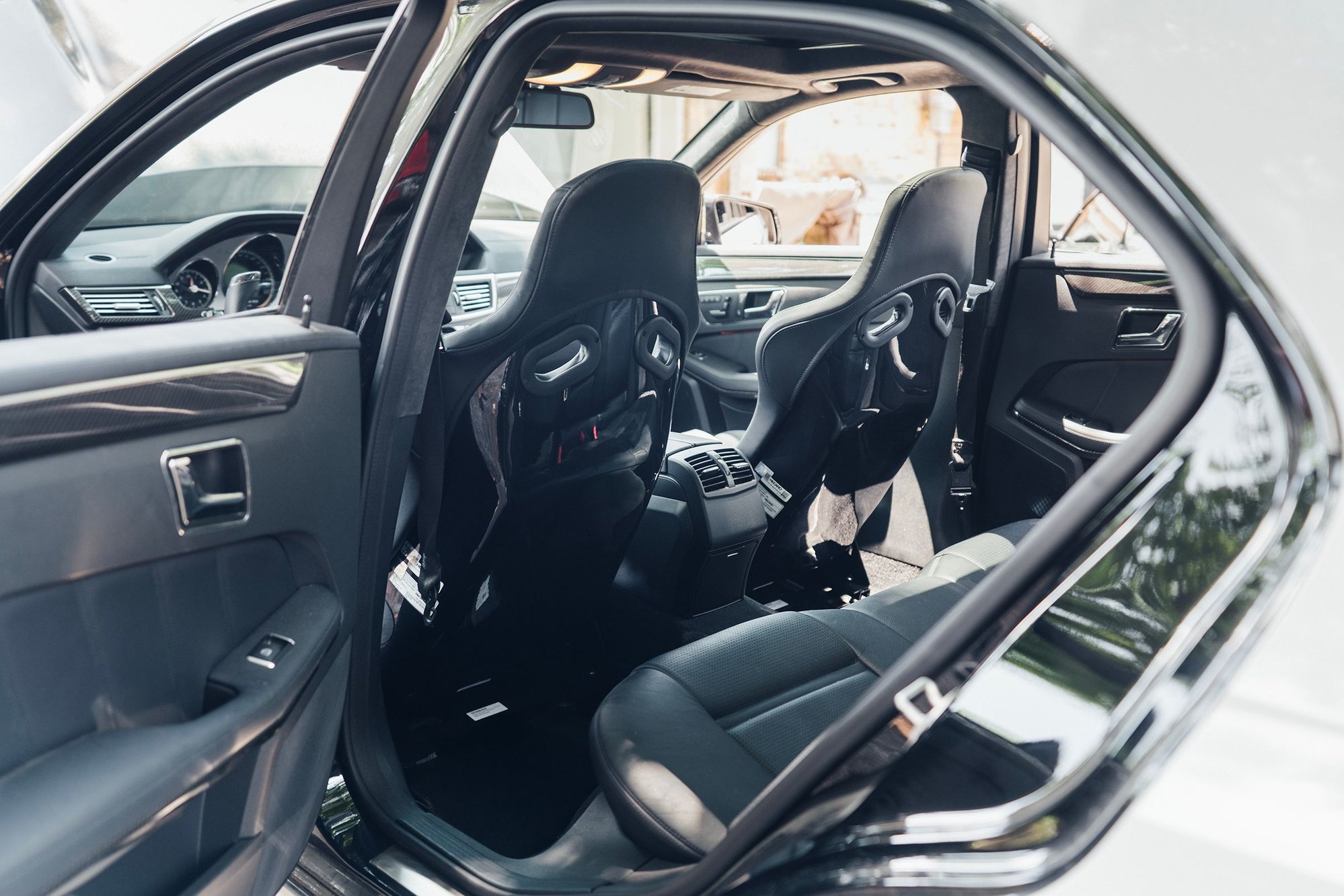

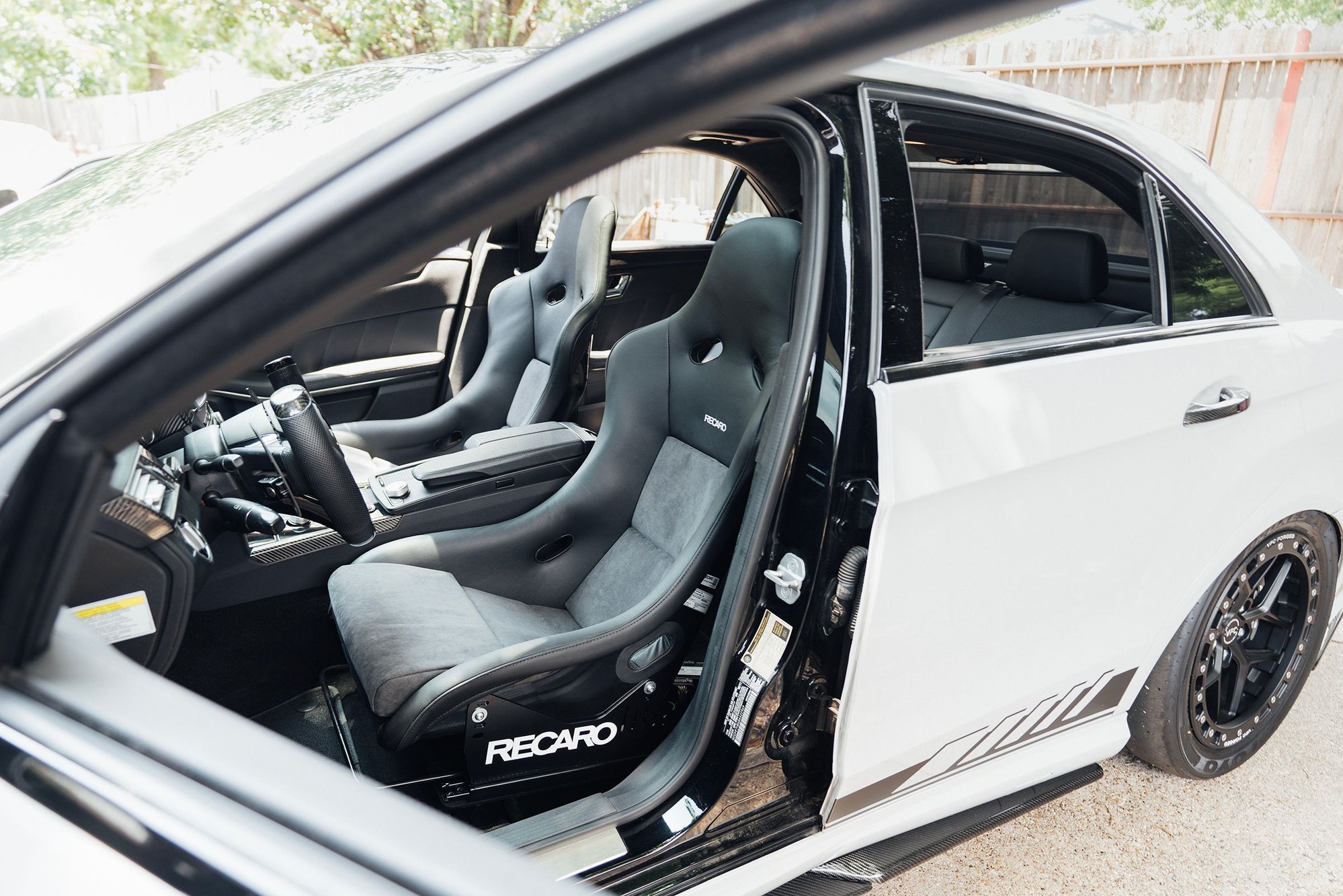

Got the driver’s seat installed today. Just waiting on a few bolts to finish securing the seatbelts, and it should be good to go.
Originally Posted by Phil_T
Let me know how you get on with the column, thanks for the other info will help loads when I get round to them.
I confirmed that the adjustable steering column module is located beneath the factory driver's seat. I removed it and secured it to the carpet with Velcro, and it works as it should.
Old Jun 13, 2025 | 11:25 PM
Seats look great & thanks for letting me know. The only difference will be the seat rails/mounts as I found Recaro makes a straight bolt in so no need for the Planted mounts.
the seats sit a lot lower than the factory seats even with the planted mounts, if you're under 6ft it might be an issue with visibility with no planted mounts.

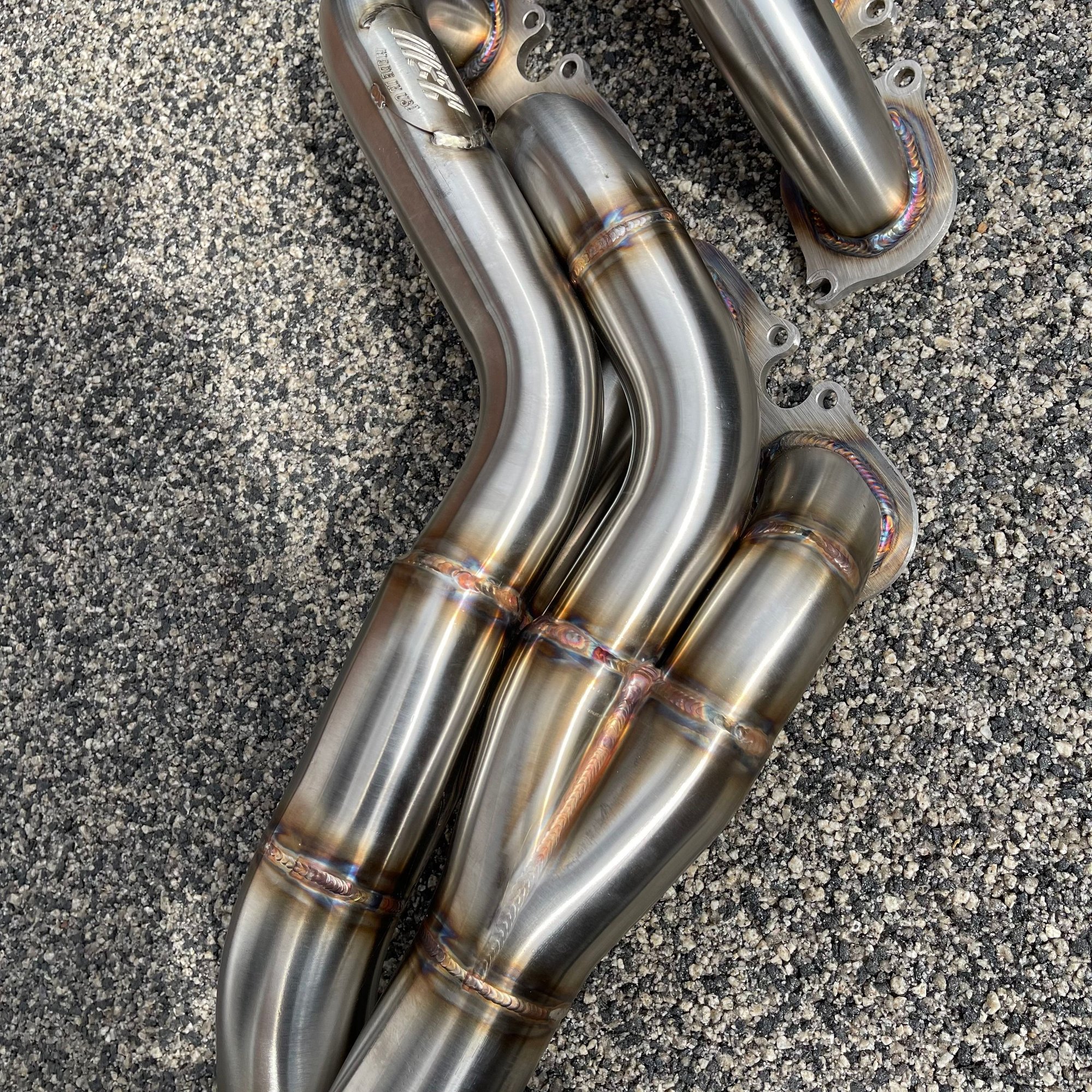

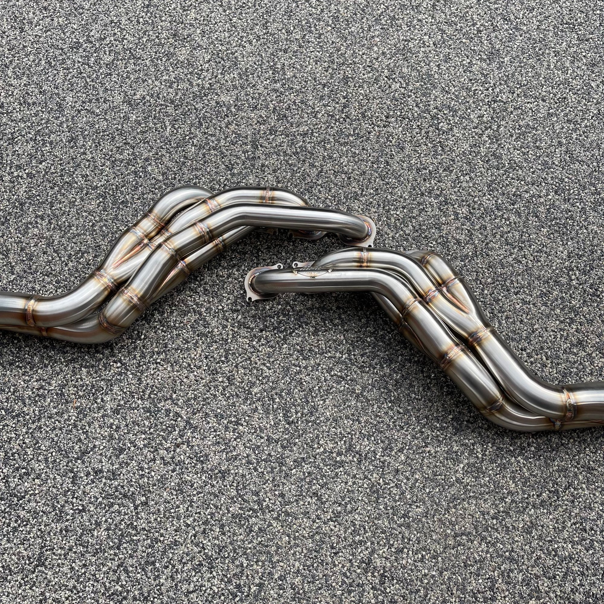

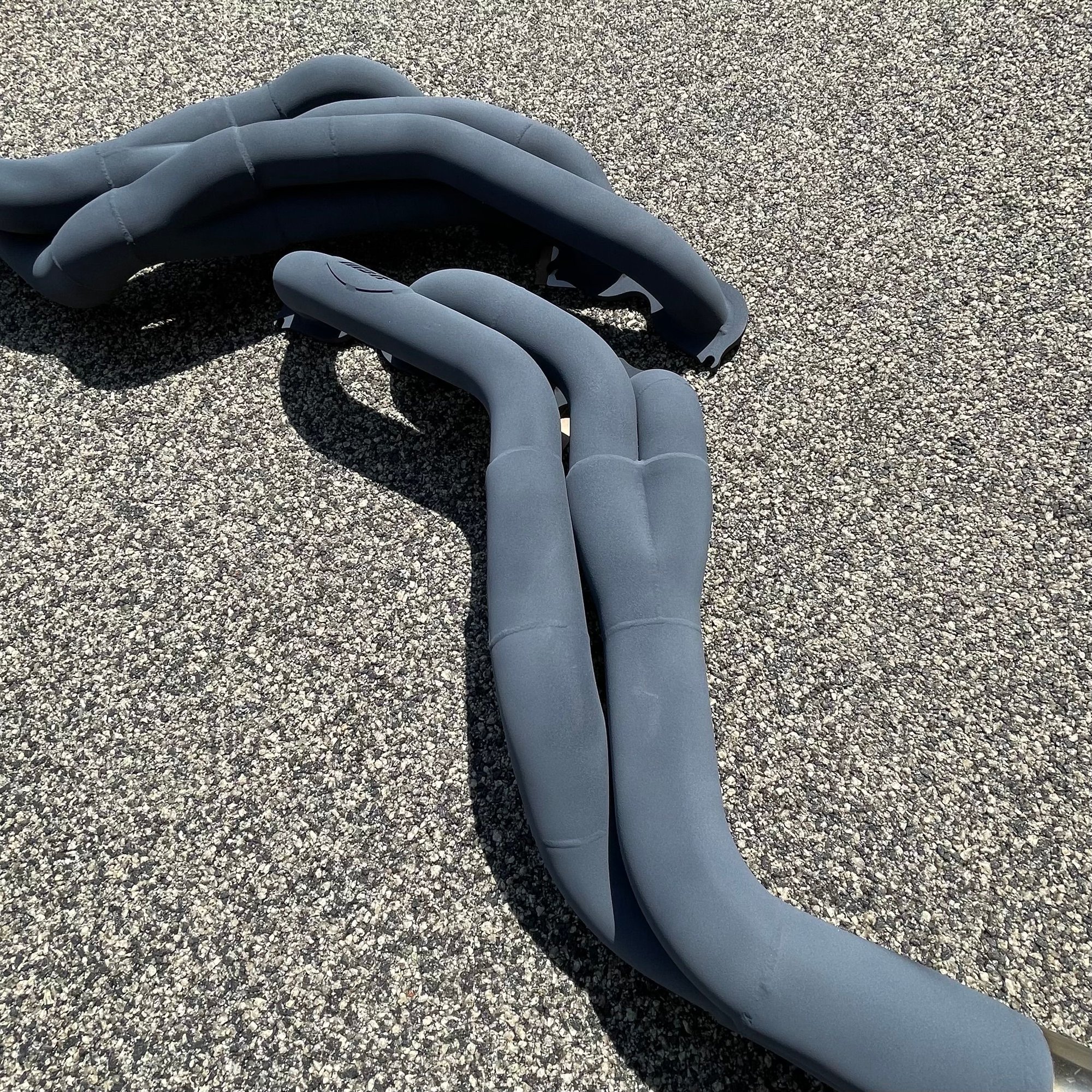

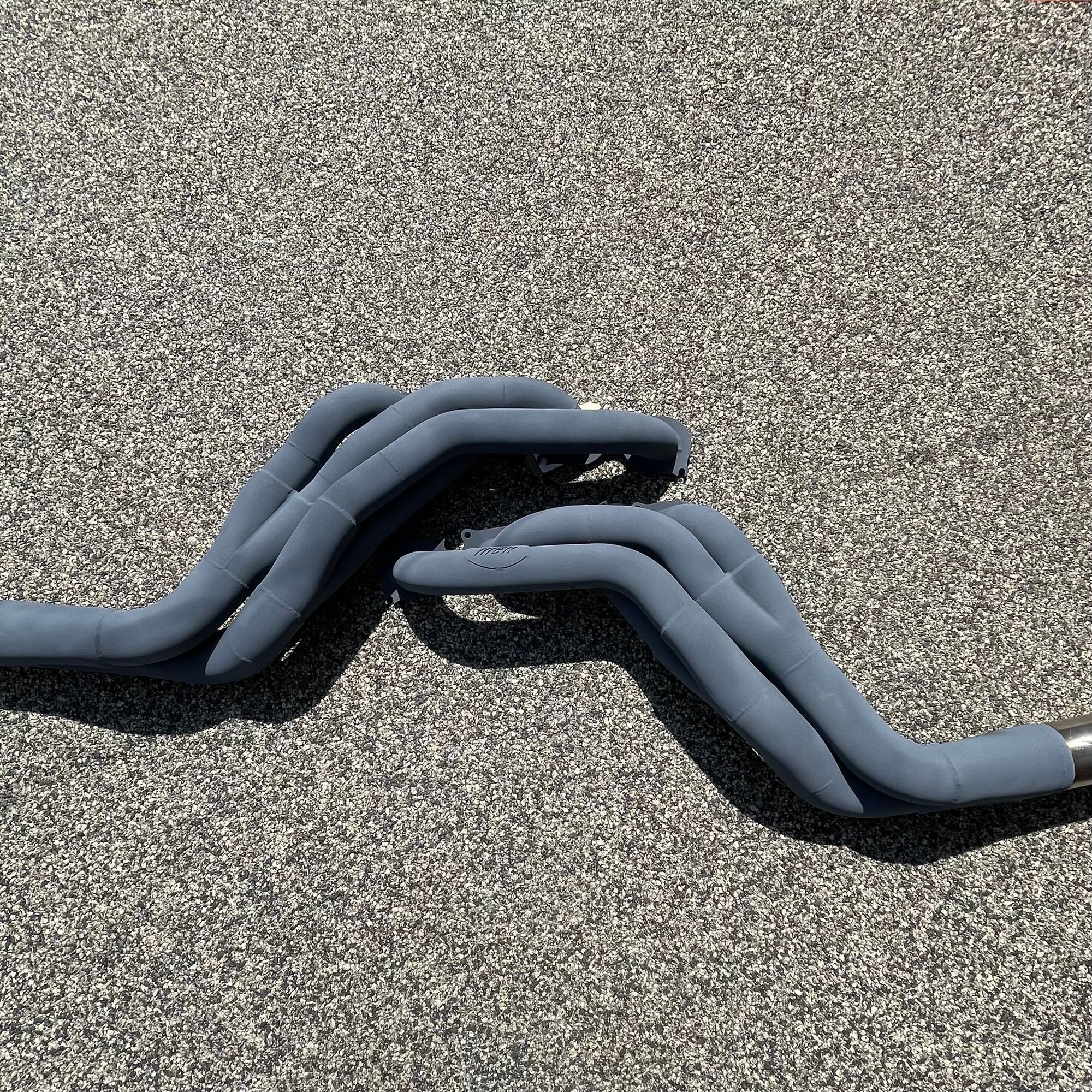

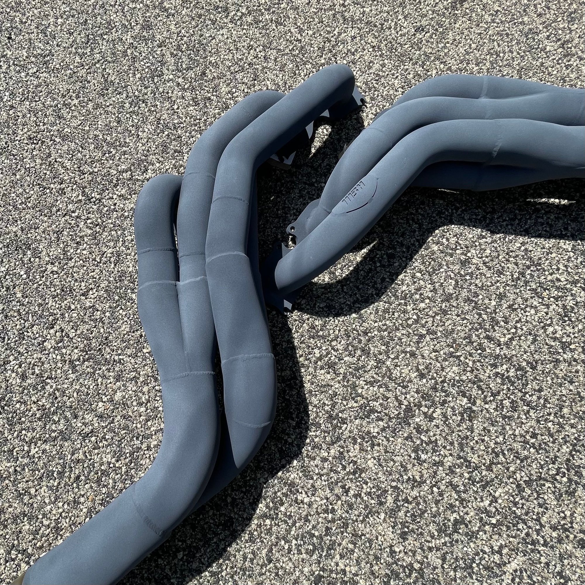

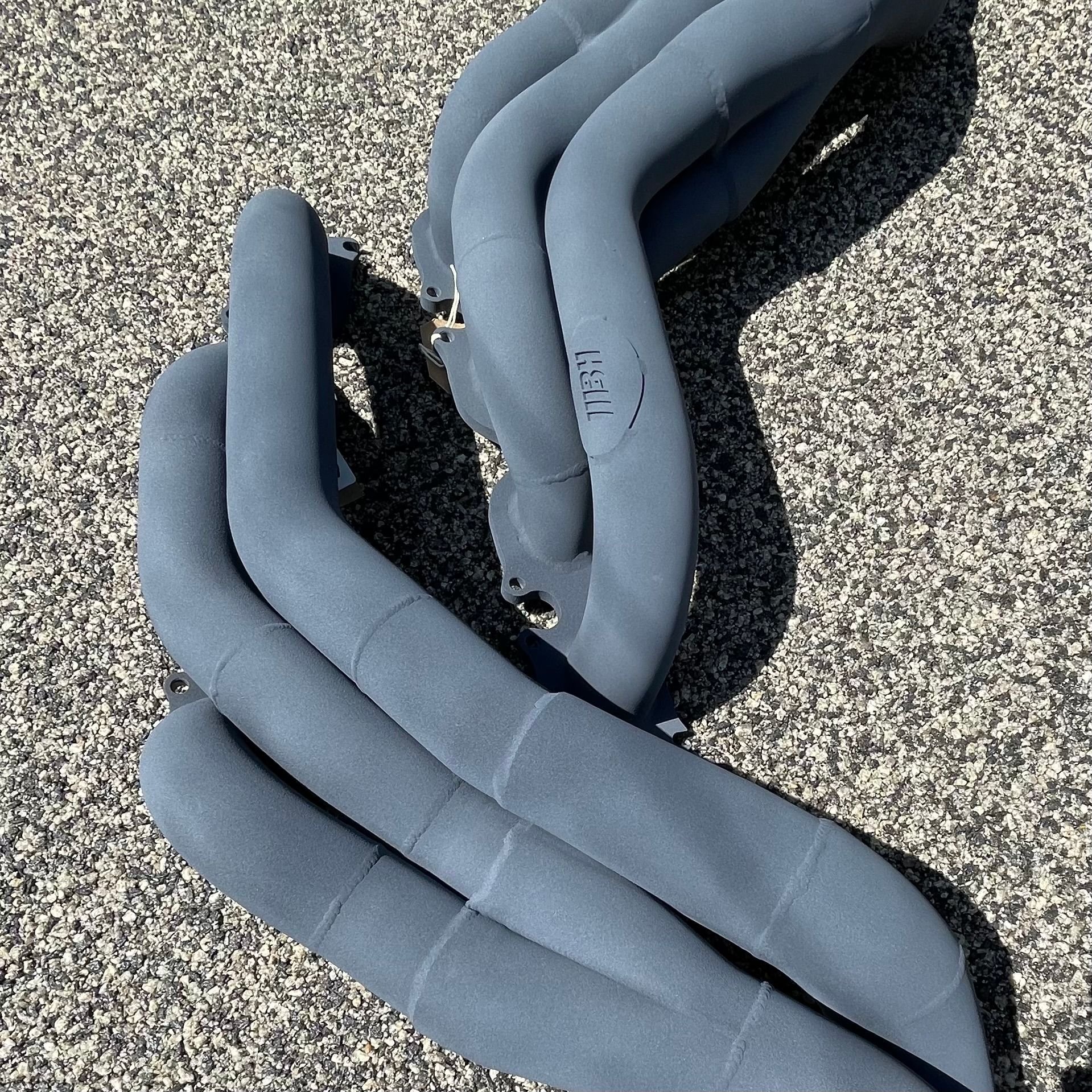

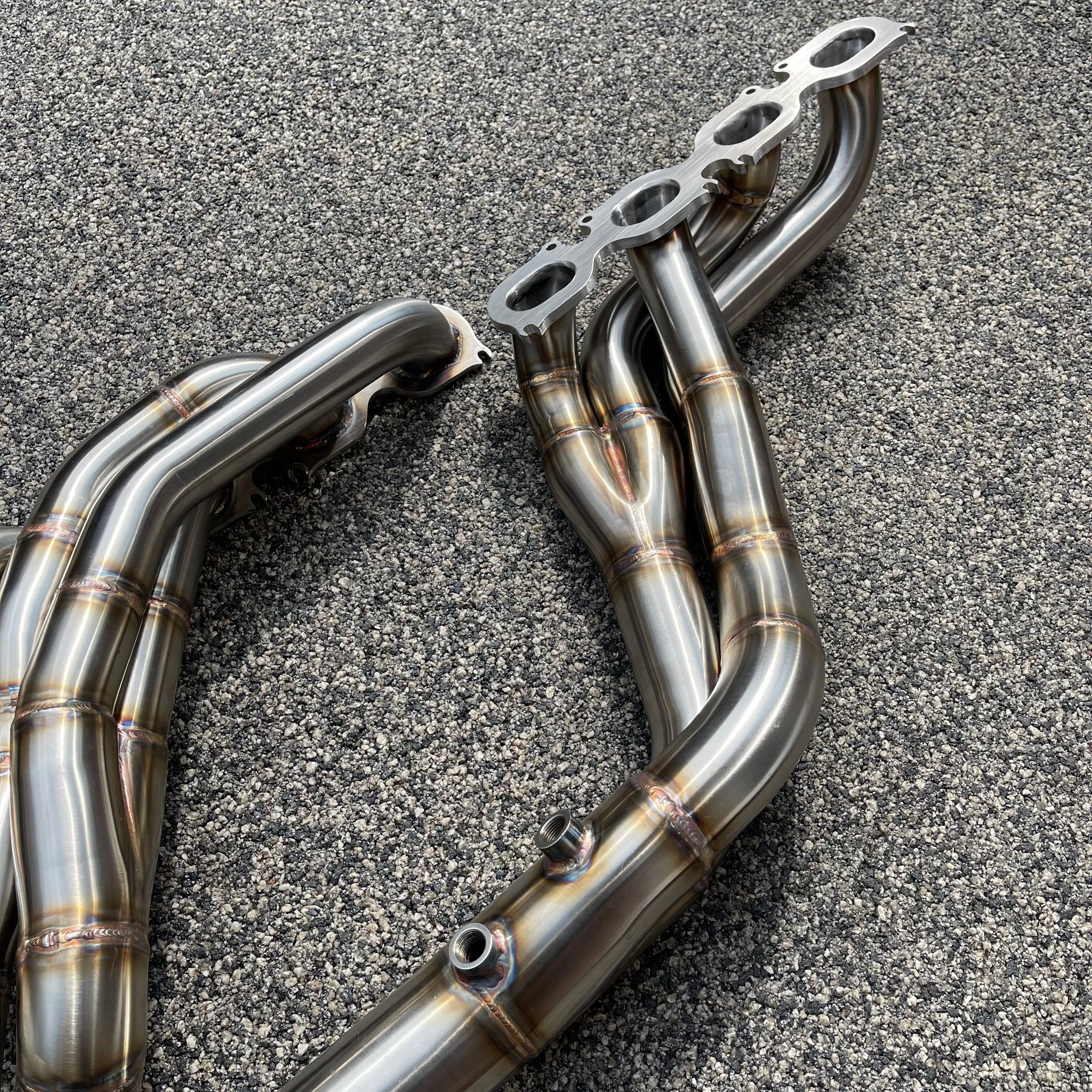

After 12 years owning the car since new and the car being highly modified I finally decided to get headers 😄 I went for MBH RHD headers which are currently getting ceramic heat treatment.

I have been considering those for my car as well. What is your impression of the build quality?
I mean look at the previous pictures, I think the quality speaks for itself, they were definitely worth the wait to be manufactured. Unfortunately they don’t look as good now they have been properly ceramic heat treated but it reduces engine bay temps by 30%, if you could see them when fitted it would be ashame as they look like a piece of art. 😄

Well I guess a 30% decrease in temperatures is worth it compared to shiny components one doesn't really see, except when looking for or on a "show" car
Yes which is why I did it, properly done using zirconia not like the cerakote which basically doing nothing for heat.
