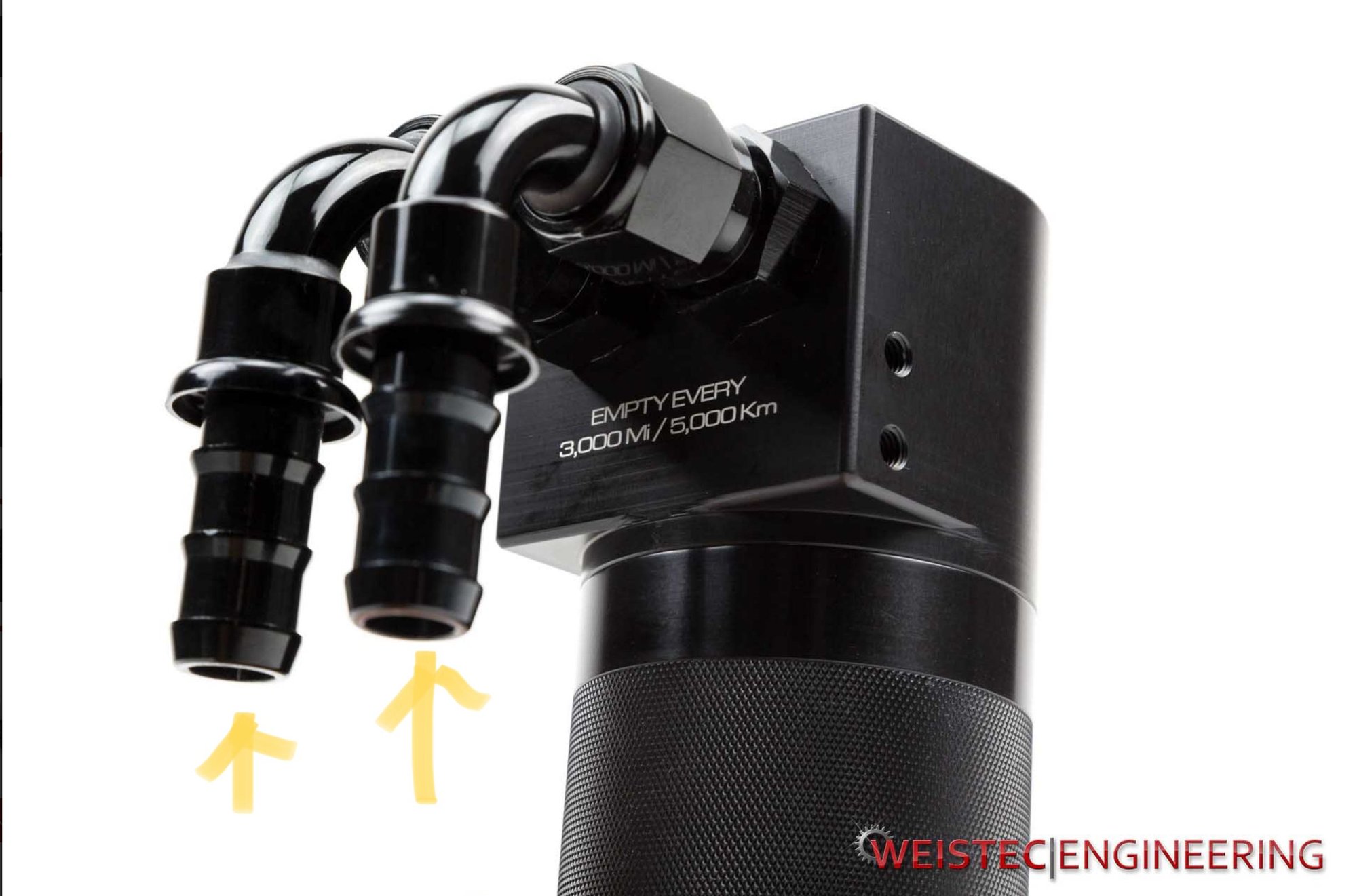

Barry, need your advice. I just replaced the PCV valve and added Weistec oil/air separator few months ago. And I keep receiving CEL light which were mixture too lean and also keep asking to add engine oil. Also I could see the oil collected from the separator after few hundreds miles and recently developing the smoke from the exhaust. (my friend told me its blue smoke). is there anything wrong with the PCV valve or the oil/air separator?

Did you hook the hoses up to the OAS backwards?

I asked if you hooked up the hoses backwards. There's an inlet and outlet on the OAS and it's very important you have the hoses in the right orientation.
Excessive oil in your intake can cause a lean condition.

Thank you Jason. Do you mean the pipe on Weistec oil/air separator , one is in and one is out?
