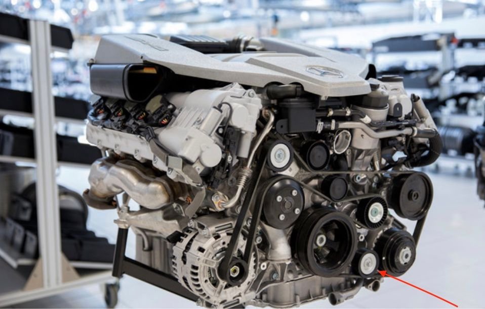

Do you have the 4th idler pulley on the motor located between the a/c compressor and crankshaft?

My belt eating problem has gone once i fitted the extra idler as you describe.

extra idler?? where does the extra idler go? do you have any pix?
Glad everything is fixed!
Red circle here https://mbworld.org/forums/c63-amg-w...ml#post8032036
See arrow, that idler is missing on pre facelift cars
I can 100% confirm it is required if you delete the AC compressor
does that idler require a bracket?
