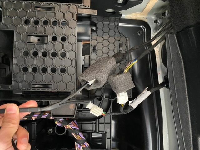

Hi . Today I installed the asr module and I don't know if I did the cable installation well. I took a photo because I wasn't sure if I did it right. If anyone can tell me if it's right or wrong, I appreciate it
Looks as it should. The connectors are male/female and you cant really accidentally swap them. Also, no other connector in that areas of the same type. I just wrapped them and made sure the module and cables don't rattle or can move.

well, it seems fine. It works very well . What I did not do is disconnect the battery from the power . I have read and this is badly done I know. But it seems that nothing happens or I hope it does not affect. I have not yet gone out with the vehicle.
no worries, nobody disconnects the battery for that. Not sure if its even hot when car is off...don't think so.

okay . not the car had 4 days without starting so good. I was a little worried but thanks for confirming. I try to upload a video but it seems complicated )
