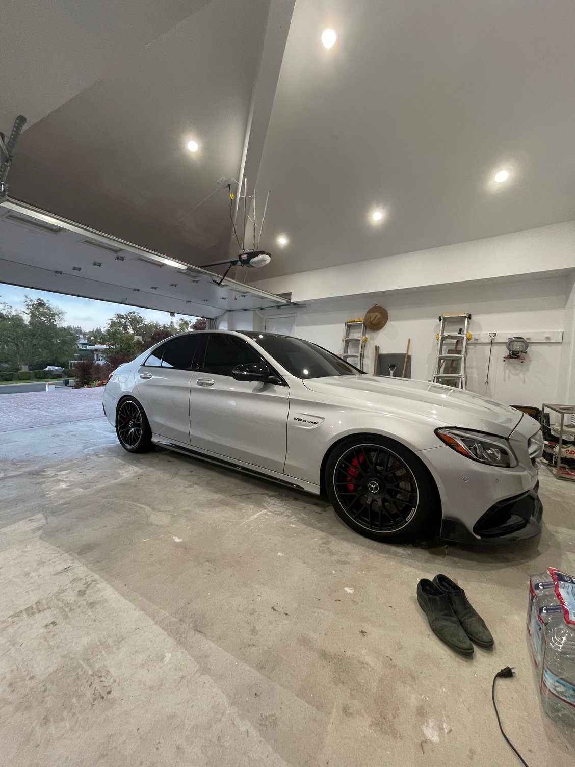

shawnraz's Avatar
Joined: Nov 2022
c63s
I have 265/35/19 ps4s on the front and 295/30/19 R888r on the rear with H&R lowering springs and no spacers on my sedan. Fitment is almost perfect and doesn’t rub. The fronts tuck a little but it isn’t flush with the body and rears are flush with the body but has less than a finger gap. I’ve been dailying this set up for 3 years around LA and haven’t broken my front lip, but I have to angle a lot. Also I tried 265/35/19 R888r in the front once. I would not recommend. The noise from the tires becomes way too loud and since they are fat tires it raised my car back to almost stock ride height.
If u have a coupe my friend has H&R lowering springs and 305/30/20 ps4s on the rears but that didn’t fill up the entire space.
car looks great, is it Iridium Silver by any chance, glad the 265 and 295 sizes work as that’s what I’m looking at, assume your fronts are et25 and rears et57?
thanks
Old Mar 2, 2023 | 09:48 PM
shawnraz's Avatar
Joined: Nov 2022
c63s
thanks
Yup it’s iridium silver.
To be honest I don’t know. I have stock 19 in cross-spoke rims. I know for these rims biggest size your technically able to run is 265 and 295. Any bigger, big name tire shops will refuse to mount the tires.
Based off google I think they are et38 and et56 but don’t quote me on that.
