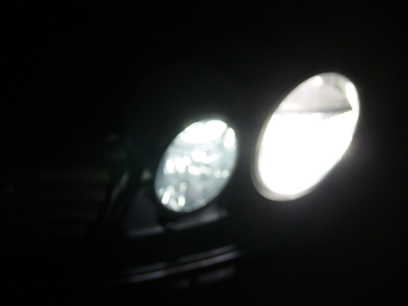

I got my AZN Optics LEDs in a couple of days ago. They're slightly bluer than my HID bulbs (Philips 85122CX, ~5400K), but they're a much closer match than the other LEDs I've tried.
I think our housing may be partly to blame. The filament bulbs look a lot browner in the housing than they do outside of it, and the LEDs look bluer in the housing than they do outside of it.
I also got the license plate LEDs (36mm festoon). They're nice and bright, and have a pure white color. They look like the stock LED license plate lights on some of the newer cars, unlike most of the bluer LEDs out there.
The picture quality is horrible, but it shows the difference in color pretty well.
