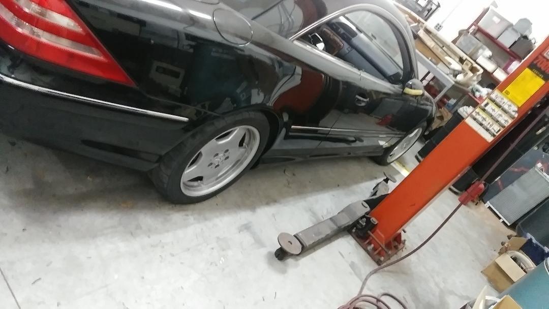

Ok, so the coils are in but I need to adjust the ride height now :/ Fortunately, it's not too hard now that I have done this.

Coils are in, ride height is adjusted:
REAR: 4.375" from bottom of lower spring perch to top of tube
FRONT: ~2.5 - 3" from bottom of lower spring perch to top of tube (I set the fronts to be about the same length as the original ones and came out pretty close for my liking.

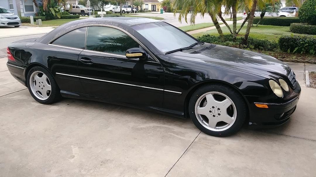

The ride height is adjusted for now until it settles, but I have it where I like it. Here it is, unwashed and filthy. I like the ride! It's totally not like ABC, but I like it. I need to adjust the rebounds for some tuning, but though the ride is "different", it's solid and connected...a bit hard, but that's ok.
Here's my advice: If you're thinking of doing a conversion AND your ABC is borked or going to be borked, DON'T WASTE A MOMENT AND DO IT NOW! However, if your ABC is in good shape with NO ERRORS OR FAULTS, leave it alone until such time as when you have a failure..because you will and it will be costly.
So yeah, it's mostly finished for now, but I am pleased with the outcome and the fact that I will never miss that ABC nonsense. The peace of mind alone is worth it. I plan to pull the pump and replace it with a W220 airmatic one in the future. And yes, I know the headlights are yellow and those are going to get restored soon.
