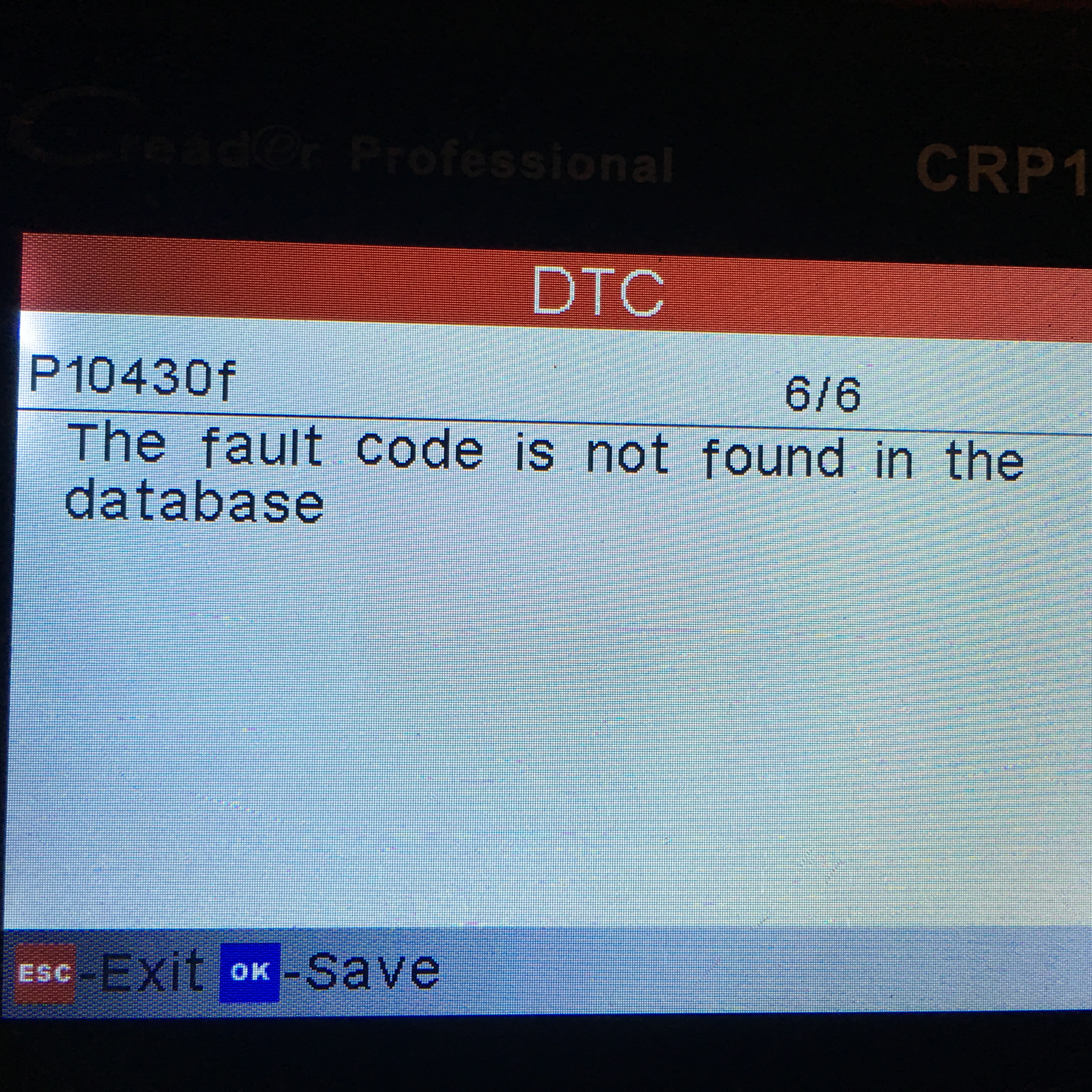

Ok, purchased a 2003 CL55 with 80k from auction. Long story short spent 5k getting it running since it has been sitting since 2009. Car is pulling some chassis codes and the front right strut is sagging. Have already attempted to delete codes with scan tool but they come right back after restart. Here is the list of codes c1034, c1200, c1200-008, c1043 and p10430f. Also message center is showing malfunction bas, abs, esp and abc. I'll add pictures from scan tool. Any help would be great. Trying to self diginose and repair.

Old Apr 8, 2016 | 05:02 PM
projectnsx's Avatar
Joined: Apr 2013
Posts: 23
2006 CLS55 AMG
Old Apr 9, 2016 | 10:06 PM
graytalon2000's Avatar
Joined: Jan 2014
Posts: 70
From: Vegas, Baby!
05 CL600
Nick is right about the brake light switch. A faulty one could certainly trigger your chassis codes. However, I have never seen any DTC code that is more than 5 characters. That power train code is interesting.
