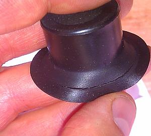

Interesting. My silver V12TT had a failed BOV, and it reacted horribly to snap closing the throttle while on boost. It shook backwards and forwards quite violently, so I got round it by only ever closing the throttle slowly, then it would never surge. Problem is it made me reluctant to floor it, unless I could be sure of holding it there.
Replacing the valves with cheap (!) MB stock valves fixed it entirely of course, and the confidence and enjoyment returned overnight.
The bit that failed was the rubber diaphragm, not the plastic housing. One of them split and had a hole in it, and the other was on the way out, and obviously about to fail.
Speedriven CL65 Anti-surge Valve (BOV) - 0-diverterdiaphragm_zps67105146.jpg
Incidentally, even when you do get access to the valve, it's not trivial. The heads of the nuts are a bit too big for the space available, so you can't use most spanners to undo them. I had to use a thin-wall socket to undo them, and used allen bolts to refit them.
