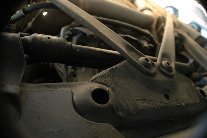

Steering Damper
Just swapped out my steering damper, pretty easy driveway job. Socket is 5/8, 2 bolts. I don't remember seeing any pics up here so here's a pic to help anyone who's thinking of doing the job. Cheers
What did you torque the two bolts at?
