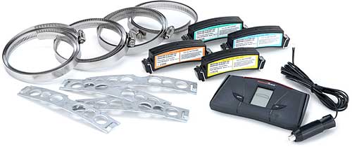

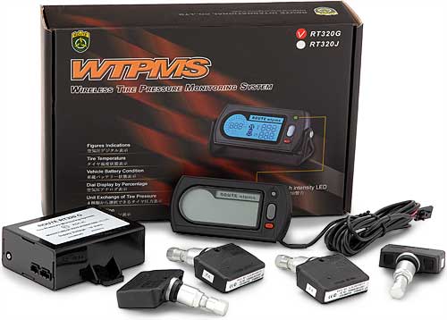

Originally Posted by AndyAMG
Is there any way to install an aftermarket Tire pressure system on my car?
Thanks in advance.
The TireRack has them. $100, $200, or $250 depending on features.
