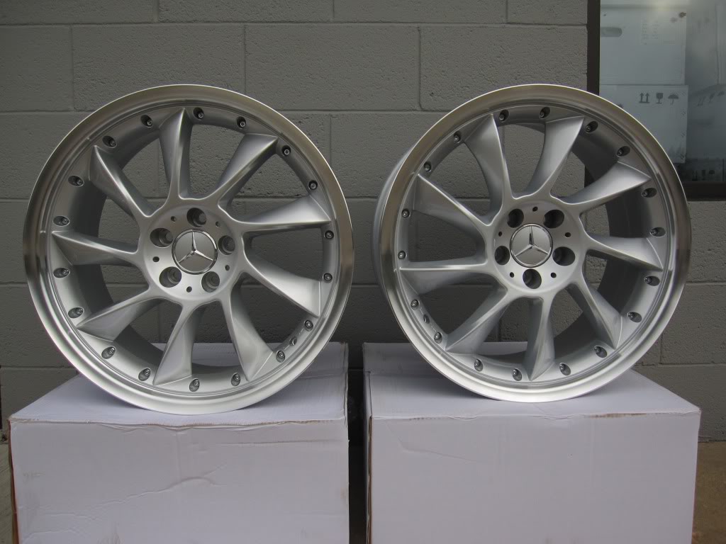

I got all excited about these SLR-style wheels at PowerWheels Pro...
***Official Wheel/tire/stance Fitment Thread***-img_3006.jpg
....but the 18's are not available staggered :-(
What do you think about un-staggered 18's on a CLK?
Old Feb 24, 2012 | 10:24 AM
  #341
Jamesbbh's Avatar
Joined: Nov 2010
Posts: 702
From: Pensacola, FL.
2006 Facelift CLK500 Cab-
I think you would end up regretting it
Old Feb 24, 2012 | 11:54 AM
  #342
eddieo45's Avatar
Joined: Feb 2004
Posts: 3,122
Likes: 222
From: Milton/Westport, MA USA
me: 2015 SL400 & 2015 ML400; wife: 2022 GLC Coupe; daughter: 2017 GLC SUV
Tech at dealer advised against too. I was hoping Glyn would chime in. Man, I love the wheel style tho'.
Old Feb 24, 2012 | 01:10 PM
  #343
Kevwood's Avatar
Posts: 4,748
From: A Canadian in Dubai, United Arab Emirates
'05 C200K SS, '05 Kleemann CLK500K, '08 Hummer H3 & '92 Z34 5sp (track car in Canada)
You'll do no harm in running matching width rims, lots of cars come with the option of staggered or single widths. A wider tire in the rear is there for one thing - added traction, no dont need it with your 350 unless you're drag racing with all season tires and a healthy shot of N2O...
If you like the wheels, the ET's are correct (30-35) and the price is right, go for it.
Old Feb 24, 2012 | 01:47 PM
  #344
discoduck's Avatar
Joined: Mar 2007
Posts: 771
From: Toronto, Ontario
W209 55
My buddy has these SLR style rims on his SLK. Great quality except they're all curbed now lol.
The SLK comes staggered from the factory and he's had no problems running the same width all around.
I say get them, they'll look awesome on a CLK
Old Feb 24, 2012 | 05:02 PM
  #345
eddieo45's Avatar
Joined: Feb 2004
Posts: 3,122
Likes: 222
the good news: Luke from Tirerack concurs that unstaggered in fine.
the bad news: Vasilli from PowerWheels Pro says they're out of stock.
I said I'll wait; don't know how long. I'd hate to think I'm just gonna curb the $hiz outta them though, disco!
