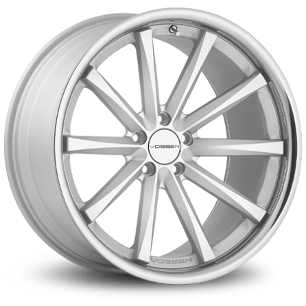

Hi all, new to this forum. Just recieved my VOSSEN CV1 19x8.5 and 19x10 with 235/35 and 265/30 rubber. H&R springs on the way, anyone forsee any problems i may have with clearance? Vehicle is CLK 500 w209
Attached Thumbnails ***Official Wheel/tire/stance Fitment Thread***-vossen-cv1.jpg
Old Mar 6, 2012 | 07:10 AM
  #362
Kevwood's Avatar
Posts: 4,748
From: A Canadian in Dubai, United Arab Emirates
'05 C200K SS, '05 Kleemann CLK500K, '08 Hummer H3 & '92 Z34 5sp (track car in Canada)
Welcome to the forum.
I have the identical rim sizes/widths (360 Forged) and tire sizes with H&R springs - I have no clearance or rubbing issues whatsoever. However, that may not be the case with you, we need to know your offset sizes. My last set of wheels (Sonic) were also the same sizes and I had a multitude of rubbing issues because the offsets were different.
Old Mar 6, 2012 | 05:16 PM

Posts: 13
CLK 500 w209
5/112+30 front
5/112+36 rear
does this help?

Rims and tyres fit no worries although the wheels studs VOSSEN sent were a little too long and were scraping,shorter studs and all good,
H&R springs are yet to be fitted to will keep you informed as to how that goes
