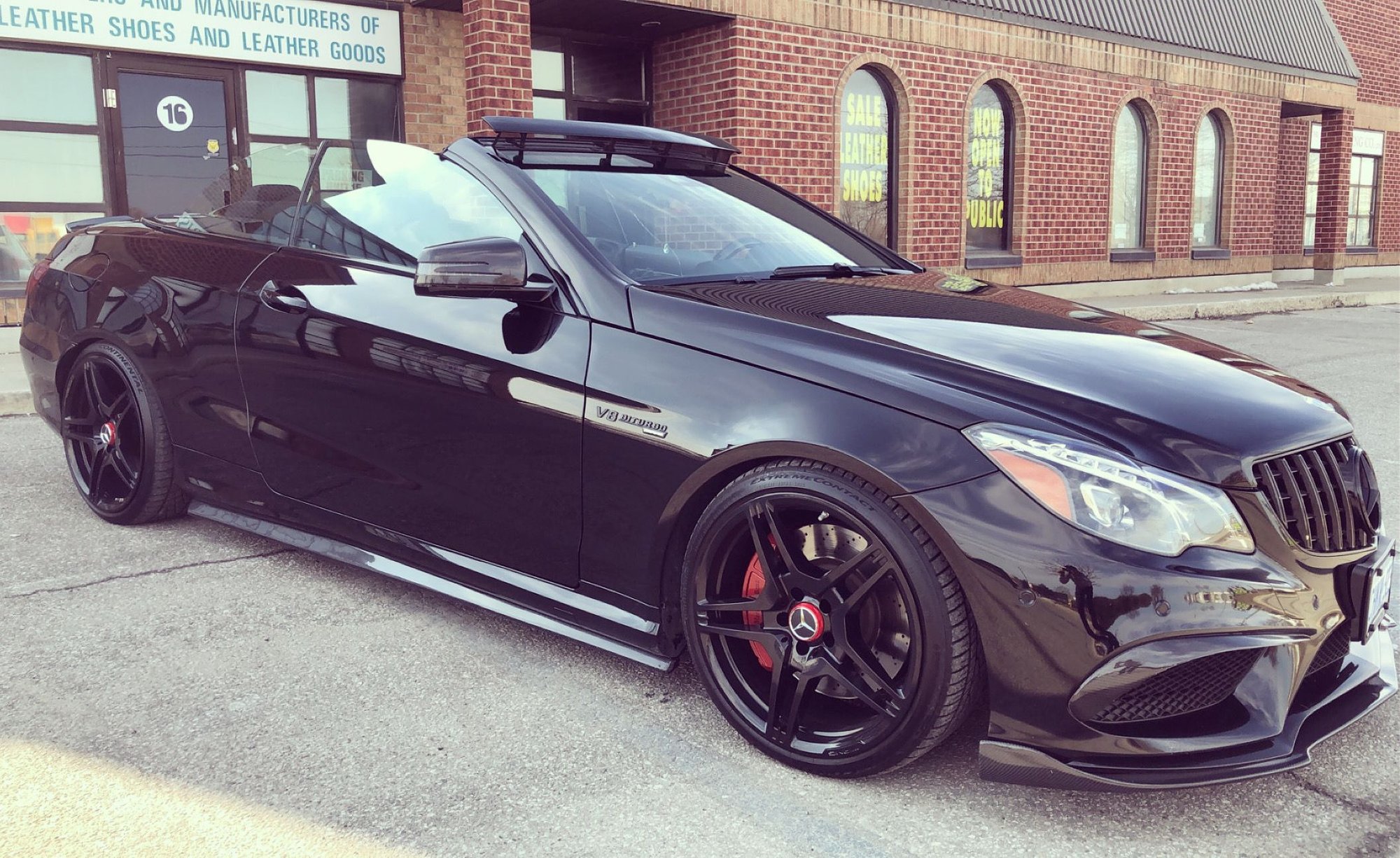

Full CF kit installed
Carbonfiber Front lip n side skirts rims getting done in Copper Chrome n gloss black
Grill n Kit done

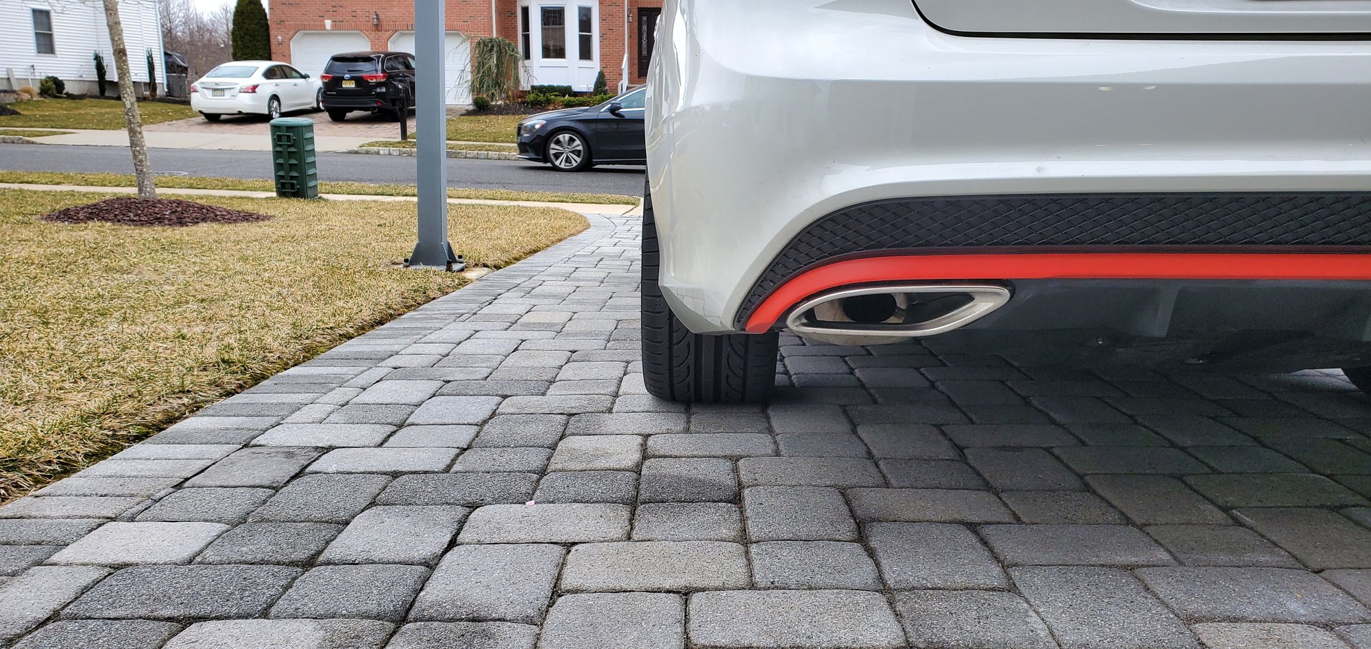

Quote: W205 C63s OEM wheels installed
Front - 19x8.5 et 38
Rear - 19x9.5 et 56
Front - Mich PS4 245/35r19 no spacer (needs maybe a 5mm)
Rear - Mich PS4 275/30r19 with 15mm spacer
Very nice fitment did you lower this? Also did you ever end up running the spacer in the front .. if so does it rub?

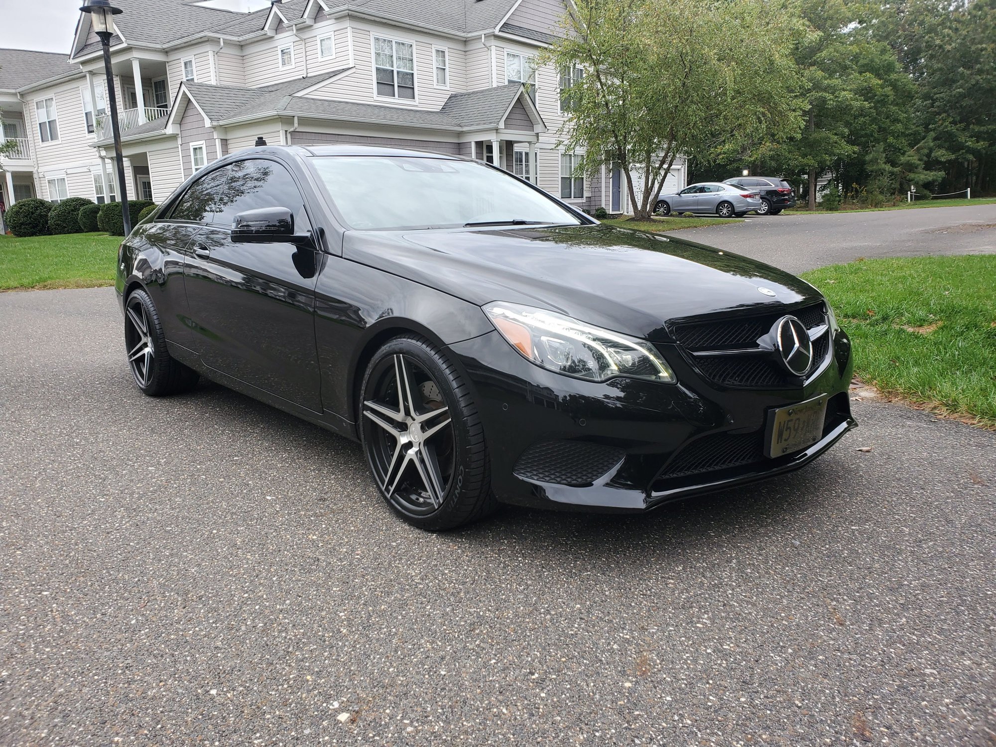

Here's my 2015 E400 With Rennen CSL 3s Front 19 x 8.5 et35 245/35/19 Rear 19 x 9.5 et38 275/30/19 I have Amg Sport Pkg with factory 10mm lowered suspension <--- Fyi.

Quote: Very nice fitment did you lower this? Also did you ever end up running the spacer in the front .. if so does it rub?
Yes lowered on H&R springs.
I didn't end up running a spacer in the front. I may consider adding a 3mm or 5mm in the future to help space it out just slightly more.

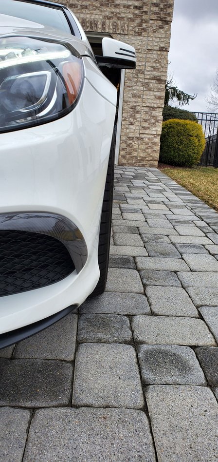

Quote: Lowered on H&R springs. I don't recall what the drop was, but it's just on the springs.
Spacers are installed in the rear to bring the tire flush with fender. I have a slight amount of rub between fender and tire, you can just see the marks on the tire from the contact. Literally would need 1mm more clearance to be OK.
The spacers you mentioned are for the wheels and not the rear springs correct?

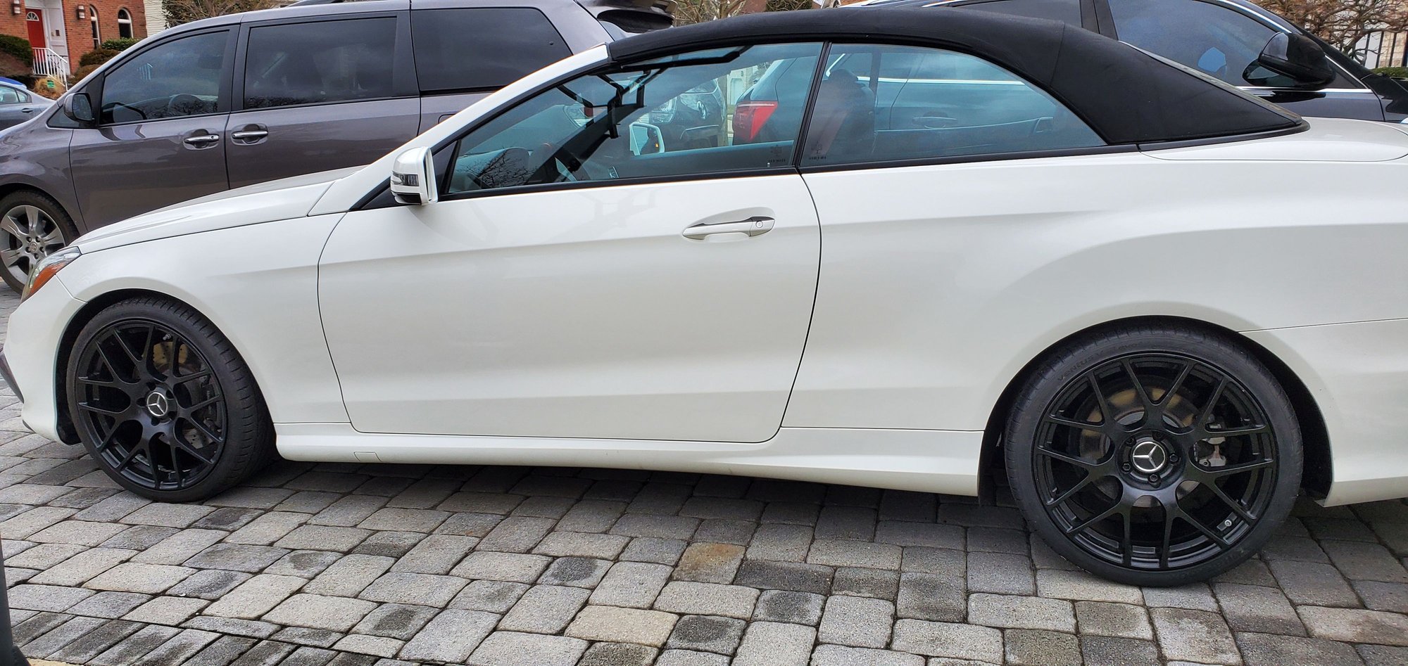

I want to buy Mandrus Miglia wheels for my e550 coupe and even though ive read this thread up and down for the "optimal flush offset", it appears 8.5" +35 front and 9.5" +45 seems to be optimal.
How would 8.5" +32et front and 9.5" +48et rear fit? Would the fronts protrude out of the wheel wells? I'm looking for a flush to slightly less than flush look
