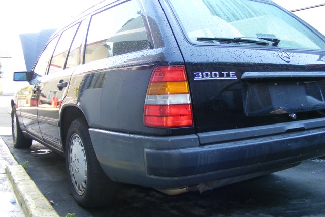

Bought an '88 300TE for my RENNTech 3.6L!
Found a clean solid black wagon with a blown engine. Owner was willing to cut his losses after a friend drove the car without water and I just removed the engine from my wrecked '87 sedan. I originally bought a non-running '90 CE for the transplant but the engine runs and the wiring is not exactly the same.

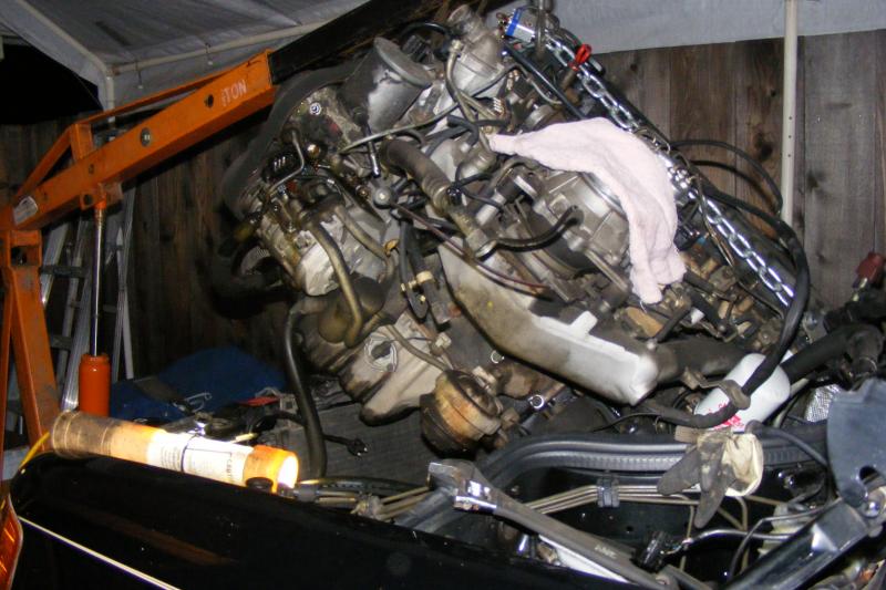

Engine differences
Boy what a job to pull then engine over the front radiator over rider. I have a cherry picker but a dirt driveway makes it difficult to move especially with no help. I had to raise it a max height but the last 5 inches of transmission still didn't clear even once I lowered the car off the ramps. I was tempted to remove the tires and drop the front end closer to the ground. The steering linkage took some weight, hopefully not damaged. I need to borrow a balance beam and a friend for the install.
I noticed differences between the engines. The engine was in an '87 sedan but it has the later cartridge oil filter so may be 3.2L block origin.
TE:
  • Power Steering pump has an extra line routed under the front of the engine up through the alternator bracket and and back to the SLS. I'll swap the pumps
  • Has oil tank and associated rear suspension components for SLS
  • Has extra line to top of water reservoir, not sure why yet
  • Routing for engine position sensor is routed differently and has a different plug. I'll use the TE cable
  • Water temp sensor has two pins, RENNTech head has three pins. I will transplant it as long as the threads are the same
  • Rear connector on head has 4 pin plug while RENNTech head has two single connectors, not sure why yet but can swap the plugs or cables
Will clean up the engine bay and engine before the install...

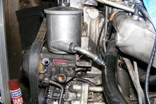

a few questions:
Cleaned up the engine a little, swapped the Steering / SLS pump, found it odd there are 4 different mounting bolts. The bottom hose insulation disintegrated, I need to buy some high temp hose sheathing. Once I install the new engine and trans mounts I should be ready to reinstall.
1) Had to swap the two temp sensors, anyone know why they have different number of pins?
2) Rear heater hose fitting is part of engine hoist bracket, anyone know the best way to remove it? It seems to be held in the head.
3) Rear heater hose has a tee with a line to the top of the expansion tank, not sure why. It's not on my '91 and aftermarket tanks do not have the fitting.
Attached Thumbnails Bought an '88 300TE for my RENNTech 3.6L!-dscf3843c.jpg   Bought an '88 300TE for my RENNTech 3.6L!-dscf3837c.jpg   Bought an '88 300TE for my RENNTech 3.6L!-dscf3833c.jpg
That's just a temp sensor for your gauges and on the 190e it has 3 pins for the fan clutch. The important temp sensor that controls the EHA is by the 6th injector. I wouldn't worry about that sensor.

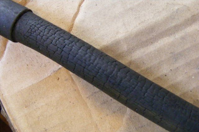

I rebuilt the $200+ SLS hose from the pump to under the front of the engine and up to the wheel well. I bought Gates 6G2 that cost $21, swapped the fittings, and wrapped it with Thermotec insulation $18 or 2x if I wrap the complete length. It's a little tricky but worth the effort, this hose is stronger. Notice how cracked the original hose got, the foam rubber insulation just flaked off.
I have to mention the truck parts man where I bought the hose told me it wouldn't work even though I said others have used this hose. He told me he would replace the fittings for $10 but when he saw the hose he explained they only work with their fittings and that mine were different. Anyway, I convinced him to sell me the hose to replace them myself.
I have replaced that hose.... 3 times.... All from the dealership.

finally got the engine installed but still need to connect everything.
  • balance bar helped but it still bent the engine hooks, it should be ~4" longer
  • should have padded the firewall, need to replace some padding
  • I dropped the engine mount bolt into the cross-member!
  • This block has a 103 part number that indicates it was not bored from a 3.2L M104.
  • The oil filter cartridge looks like it was modified to fit, not sure why
Attached Thumbnails Bought an '88 300TE for my RENNTech 3.6L!-dscf4359c.jpg   Bought an '88 300TE for my RENNTech 3.6L!-dscf4338c.jpg   Bought an '88 300TE for my RENNTech 3.6L!-dscf4065c.jpg

Haha I did the same thing with my engine mount bolt when I changed the mounts.
Even after reading GEDgagget did it too. A magnet tool got it out fine though.
