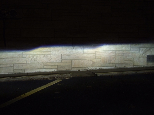

did you make yours? I have made several using E55 projector but this is my
first with the RS6. everything is out on the project bench but i've not touched
it in a month. still thinking of the best method to fasten the projector to the
Depo post mounts. am thinking I would epoxy 4 mounting points on the projec-
tors from which "Z" shaped metal tabs would protrude and line up with the
Depo posts. how was yours done?

Yes, I made my own. All I did was cut the bowls out of the DEPO projectors and fitted them onto the RS6 bowls. I did a bit of cutting and made it work.
Old Feb 24, 2008 | 10:15 PM
raymond g-'s Avatar
Joined: Jan 2004
Posts: 5,939
Likes: 178
From: Seattle WA
99 E320
intriguing...i`ve not heard of anyone doing it that way. how does it work¿ got beam shot?

I used the stencil, similar to another retro-fitter's method. The holes from the RS6 didn't match up to the to DEPO, so what I did was cut the bowl off, and then there was the cut-out, i.e., stencil. I have pictures, but not on this computer. I'll get them to you later tonight or tomorrow. It's much easier this way. It cuts down on 'from-scratch' parts.
ah...got it. you didn't mention the projector lens. did you simply reuse the
Depo lens and only swapped out the projector bowl? r-

I still use the projector and the bowl. I just cut off the bowl from the DEPO lense and use the outline for the RS6 bowl. Whatever didn't fit right, I shaved it down so that I minimized the number of cuts. I've attached for a better illustration.
Someone also wanted a beam pattern, so I attached a picture of that as well. Granted, the exposure is not at optimum settings; it's much brighter than shown.
