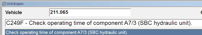

Son driving home his 2003 E320 from work on Friday got the dash brake light warning message. We had about a month ago replaced all the rotors with Zimmerman's and Akabono pads so first thing I did was hook up that C5 Star and here ya go:
test log gives:
SBC - Sensotronic Brake Control - F -
MB number HW version SW version Diagnosis version Pin
0044319912 05.2003 48.2005 0/16 9
Code Text Status
C249F Check operating time of component A7/3 (SBC hydraulic unit). Current and stored
Running the tests gives ya:
Result :
- Service threshold reached
Note :
- A warranty operation is required.
- Contact an authorized Mercedes-Benz workshop.
End of procedure

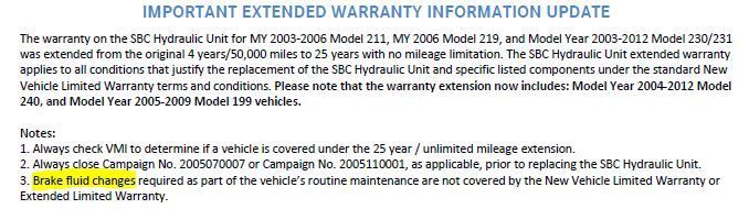

Thanks to all of you here, info on that 25yr warranty SBC is widely available, printed a copy of the MBUSA letter and have a 7am appt on Monday at the dealership. According to that letter, this is a unit replacement - not a reprogramming - so we will see how it goes.
Yes - with that star I could reprogram the SBC but heck - if MB will replace the unit at their cost - why not get the replacement unit...

For $0, what can I say other than super happy. If you get a C249F code, take it to the dealer for a free unit (until at least 2028 or more depending on your year). Gotta love that unlimited mileage 25 year warranty.

I believe when they install a new SBC, the procedure requires them to do a flush. So you have fresh brake fluid as of Dec 2019.
Old Jul 9, 2020 | 11:13 AM
konigstiger's Avatar
Posts: 15,901
Likes: 4,630
From: North Scottsdale, AZ
'71 Pinto
Dealer is only required to bleed system using STAR.
File Type: pdf

Only required to bleed system using STAR.
Foxwell nt520 can bleed the system.

Brake flush is not part of the procedure but it would be foolish to put in a new unit with old fluid. Dealer did not bother up-selling a flush to me since I told them I had just fully flushed the brakes via a positive pressure setup with MB fluid less than a month prior. I can only guess the tech saw that all the fluid was completely clean when they replaced the unit.
