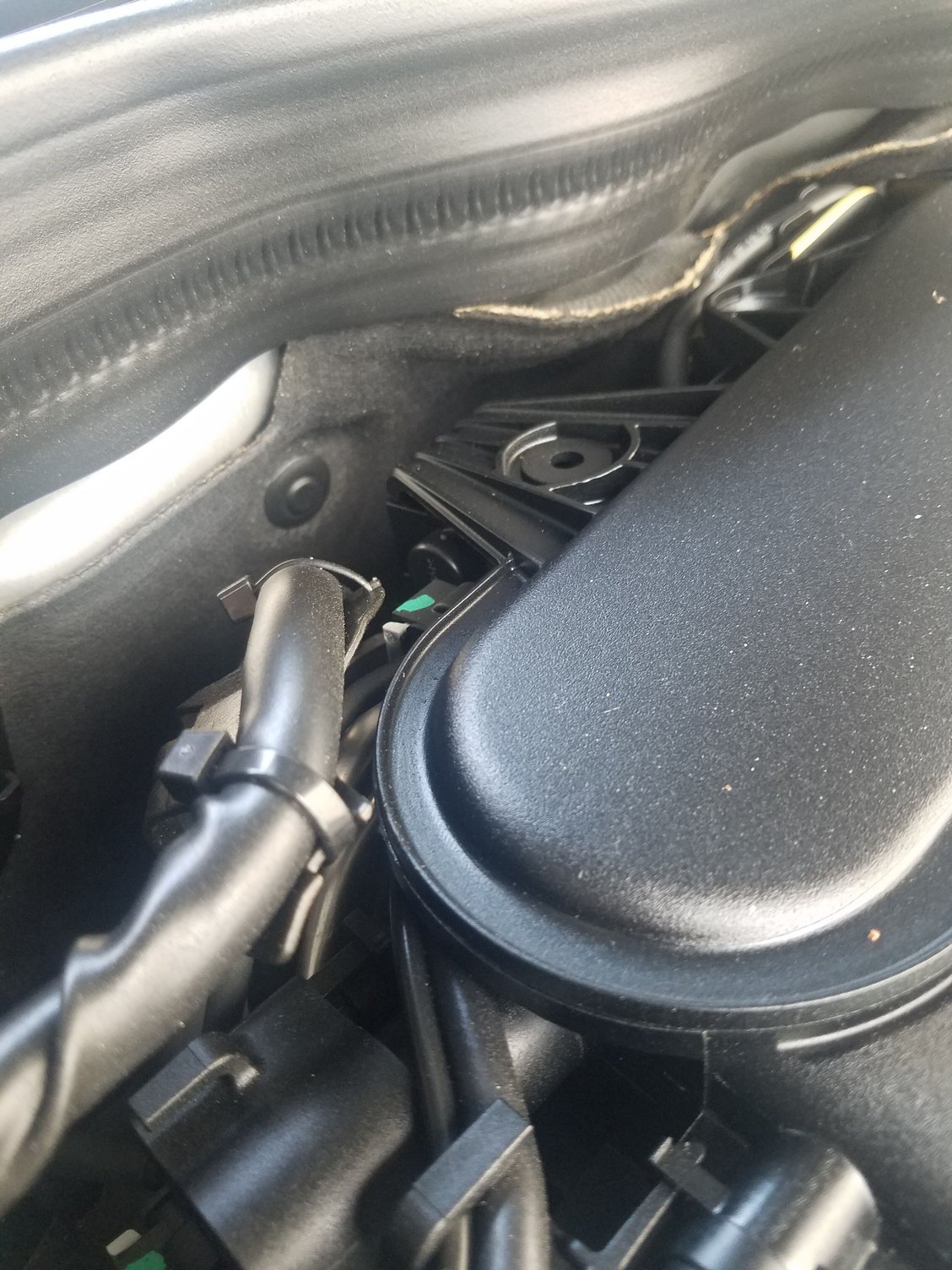

Originally Posted by LALALAND
Open the hood to check the firewall insulation behind the engine has sag. Kind of suspect that it let some engine noise into the cabin. I know that my insulation sag like around 1 inch in 2 area. Going to get the dealer to take a look at it to see if they can adhesive glue it back next time I'm in service. Maybe buy high heat resistance tape from amazon to tape it back flush against the plastic barrier/wall if the dealer won't take care of it.
I am assuming you are referring to the material shown in the picture.
It looks to be in pretty good shape to me. While there is just a tiny bit sagging forward, I cannot imagine that's responsible for the noise I am hearing.
