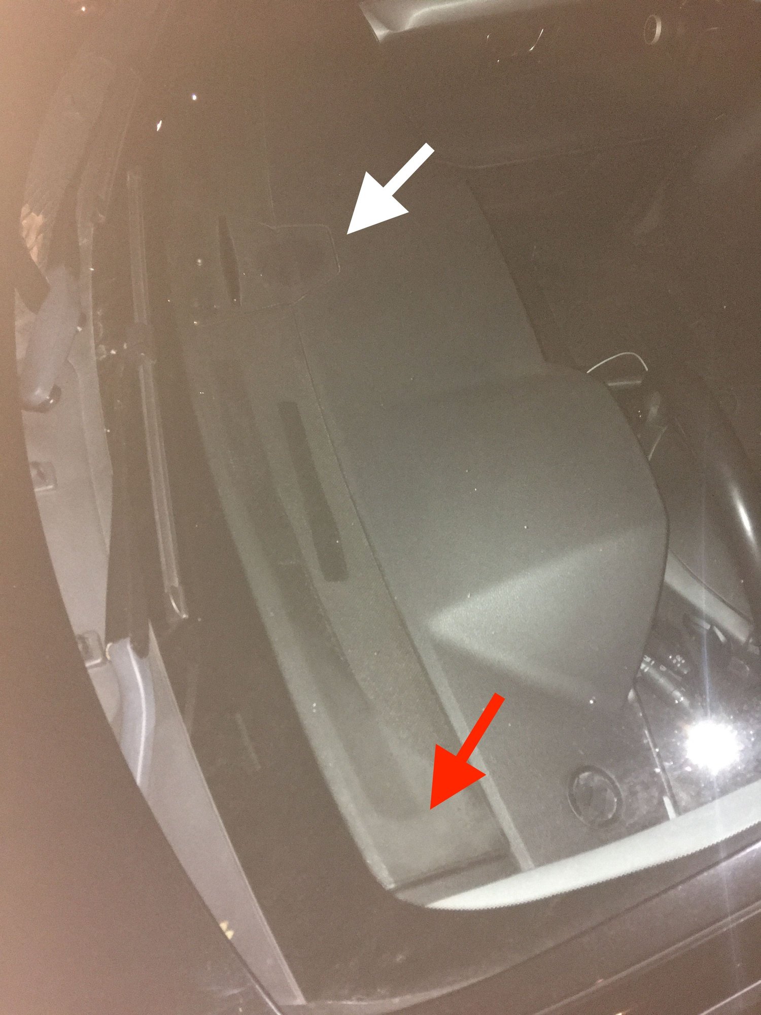

Tweeter in door no buzzing sound. Pretty sure it comes from where I put the red arrow and there in should not be any speaker don't even here music from there!
It may be a speaker in the center white arrow but not sure if this care have speaker there can not here any music.
One thing I noticed when I start car with command off it does 3 fast almost silent dunks, same if I only start command with no key in the car.
Was reading these people having problem with melted speakers but here we have like max 70F at summer most of the time 60F..
Can say its like 90% change buzz coming from where the red arrow are.

Ok guys removed a-pillar in the garage to have a better look. Started car and no sound as soon i drove car out it starts to buzz. Can it be like GPS module that are broken and pick up the noise?

Started car in garage and drove for like 20min no buzzing! As soon I did a restart utside it began to buzz.. Be tankfull if i can get pdf how to remove front galler not sure how clips are. And not hade access right now to mb WIS!

Figured out to remove front plastic was a hard one many clips few broken :/ But nothing to see there..

look for Flexx garage. This problem is related to cabin temperature sensor fan unit.
