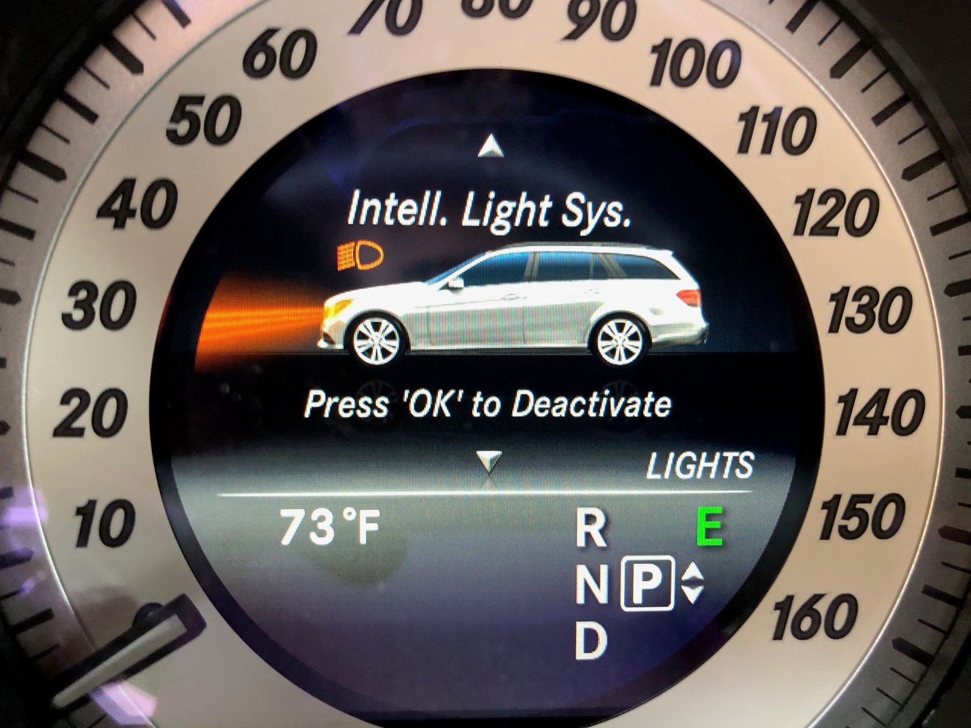

Just wanted to let everyone know that there was another successful ILS installation. In this case, to my US spec 2016 S212. Thanks Vladimir!
- Longroof
- Longroof
That's awesome, so far it seems that all of you with LED's seem happy with the results. I anxiously await to here how it goes for the pre-facelift vehicles with xenons.
