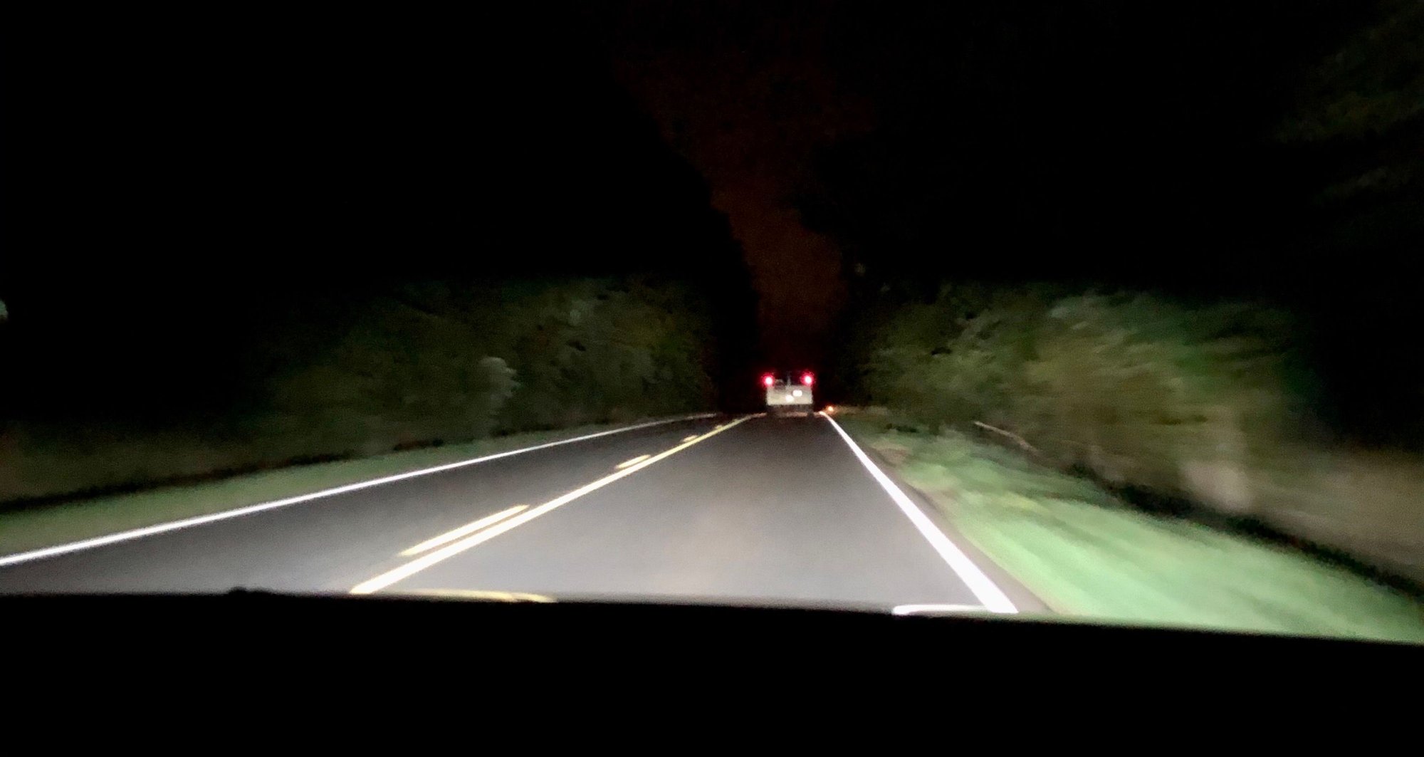

Trying to film this with an iPhone is not working out. But I did manage to capture a rather lousy photo of the car doing its thing and shielding the car in front while maintaining high beam. This is a huge upgrade in illumination and night driving safety. It works exactly as the Benz videos about the system explains. It has the enhanced fog light, the adaptive high beam assist plus, motorway mode. The lights are very active at constantly shaping the beam pattern to the surroundings. I am very happy to have this.
As I understand it, I’m the first USDM W212 to have this unlocked. This was done by Vladimir - the same one many of you have CarPlay from - and he guided me through it and was a huge help.
If you have a facelift (unsure if he can do the pre-facelift) W212 and have the ILS system, you need this. It changes night driving. And Vladimir is the real deal.
