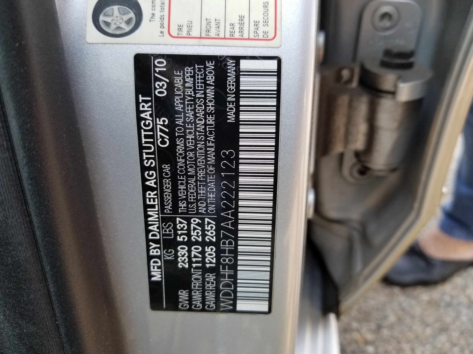

I have read everything I can on this topic and even tried the ribbon fix. The instrument cluster in this car is different than the one with the ribbon. This cluster has the "hand" indicator for the fuel level and temp, not the led on other clusters.
I am at a loss. I had the cluster out and could not see any problems with it.
All the fuses in the car are good. Everything checks out with continuity checks on the listed fuses.
Any help? Do I just need to get a new cluster and have it programmed at the dealer?
Let me know your thoughts.

eeeew. I looked up the instrument cluster for a generic 212.056 (E350 with the M272 motor), and found a bajillion PNs, depending on option codes.... your VIN would narrow this down, a lot.

so lets see... your VIN has instrument cluster A2129005004
Code: (M271/M272/M273/M276/M278)+954+461+-462+800;
eg, any of those M27x engines, plus AVANTGARDE, plus Instrument with miles display and english lettering, NOT instrument with asian characters, + YoM 19/1 (I have no idea what this last code means)
Old Aug 30, 2021 | 11:44 PM
Ding1088's Avatar
Joined: Aug 2021
2010 E350 4
Tx
Thanks for the help. Going to get a new one.
I appreciate the help
