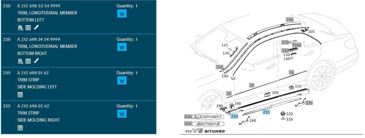

konigstiger's Avatar
Posts: 15,901
Likes: 4,630
From: North Scottsdale, AZ
'71 Pinto
Agree, EPC shows molding incompatible with with non-AMG trim even with sport AMG 'body styling' (code 772) 255 is grayed out.
Here are part #s:

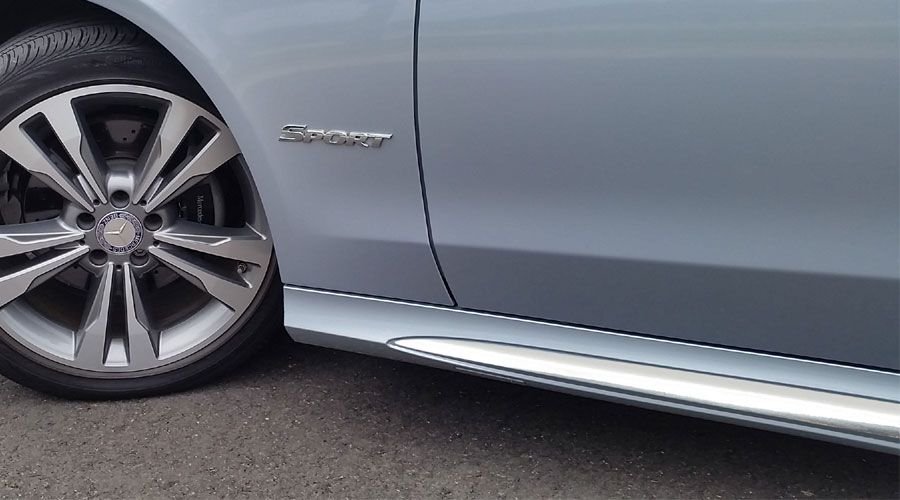

fwiw, my 2016 E350 wagon with the 'luxury' package has chrome inserts on the side skirts, came that way from the factory AFAIK
you can just see them here in this side view picture...
ah, but those strips are on the doors not the skirt.
