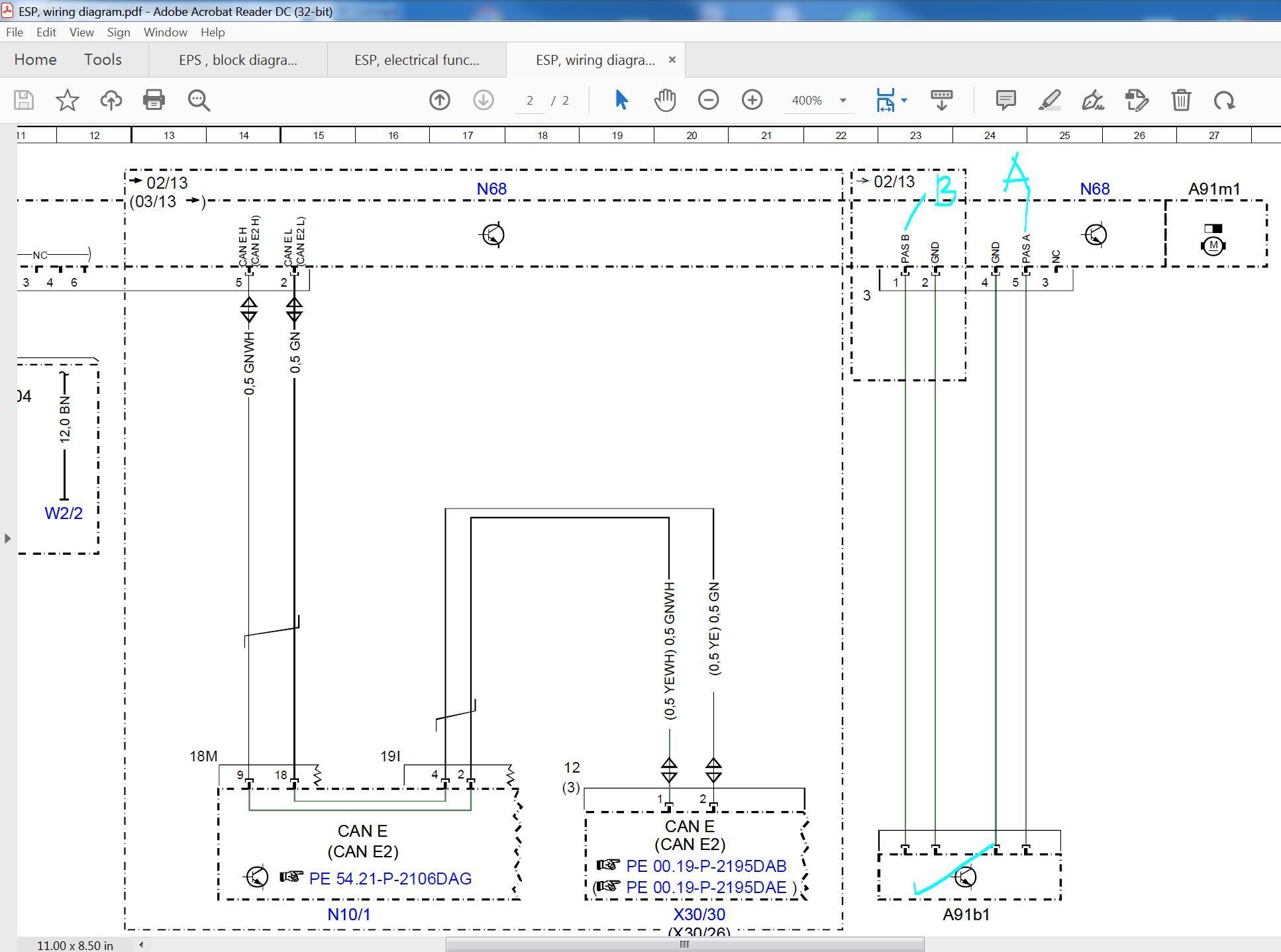

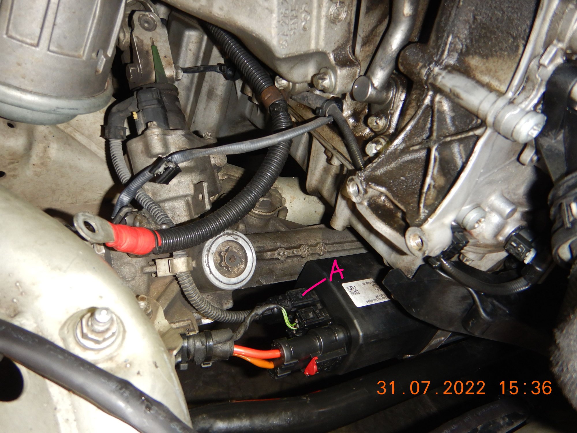

I suspect the Torque Sensor A91b1 could be the problem.
Too bad there is no Xentry test for it.
Try to disconnect it and test with engine running.
The connector to disconnect is below, I label A.
It is the same connector Cali label as 1, below
The Torque Sensor A91b1 itself is the green tick connector , but is deep inside the steering rack.
Attached all 6 documents related to EPS
The torque sensor A91b1 is the one which actually sense human steering effort and multiply it.
If say the torque sensor is out of specification and never goes to ZERO value, and instead is registering a bit LEFT value, it may do what it is doing ( whacky) now.
Example only
https://www.bosch-mobility-solutions...s%20to%20apply.
Example only
Happy troubleshooting.......
