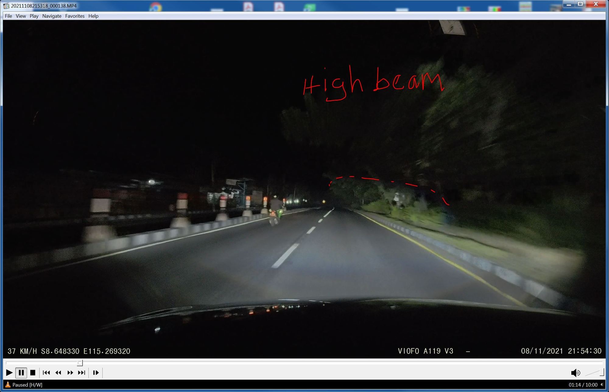

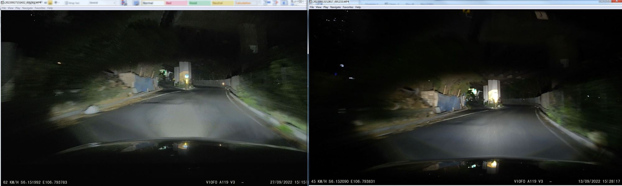

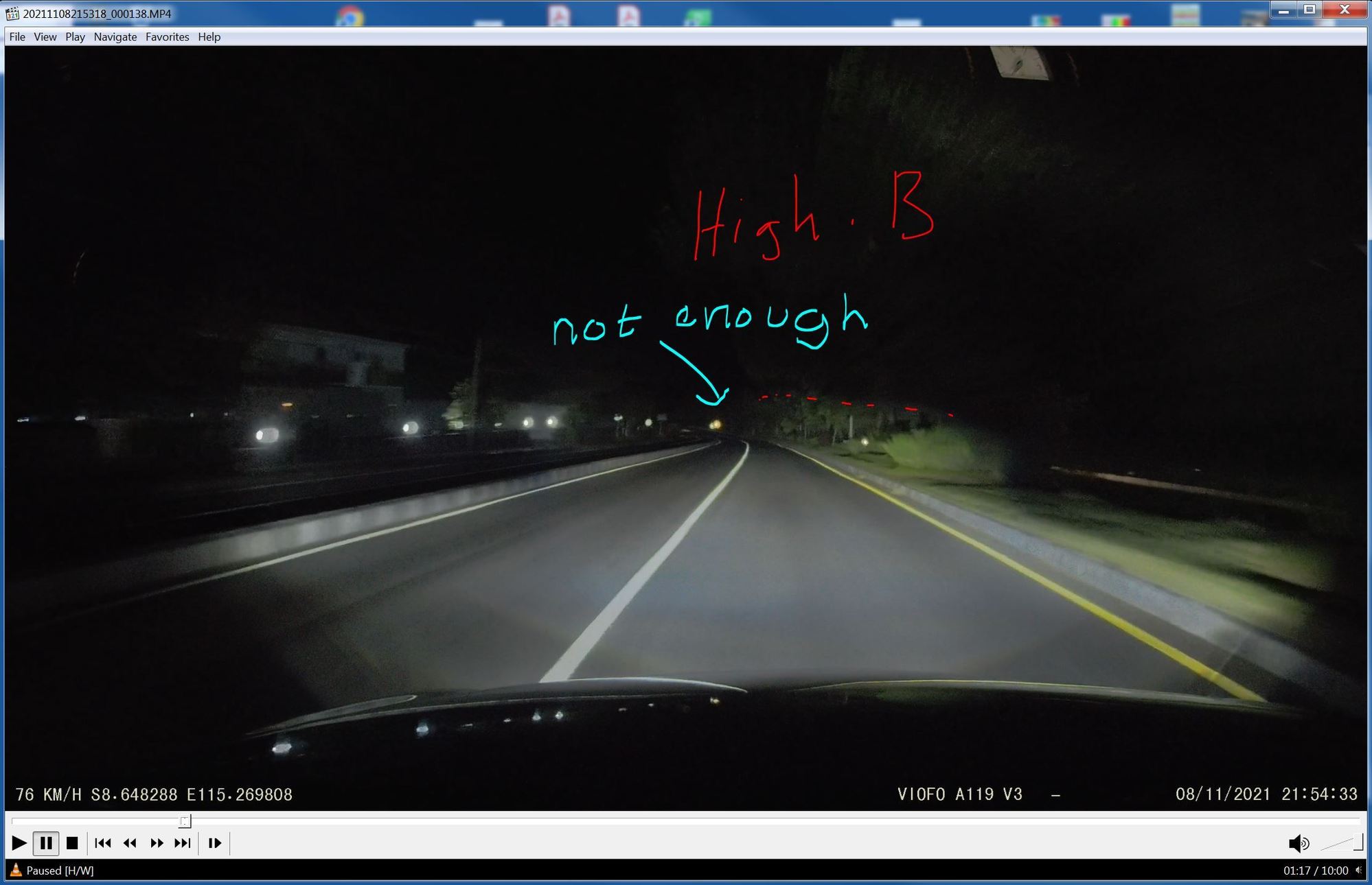

The brigthness at high beam at a distance and width of the beam ... is poor this ILS. The low beam I do not complain.
See how lame the high beam is. In Bali.
There is not enough lumens thrown at the distance since 1 headlight only is a 35 watts total, so the high beam side perhaps 20W or so.
Since this is a curving to the left the road .... at that far distance, if the light is brighter I can anticipate earlier any danger lies ahead.
If in some parts of USA big animals crossing the road is a risk, in my country it will be people and people on a motorbike crossing illegally as if a pedestrian.
Some people maybe pushing food carts or some sort of slow carts crossing the road.

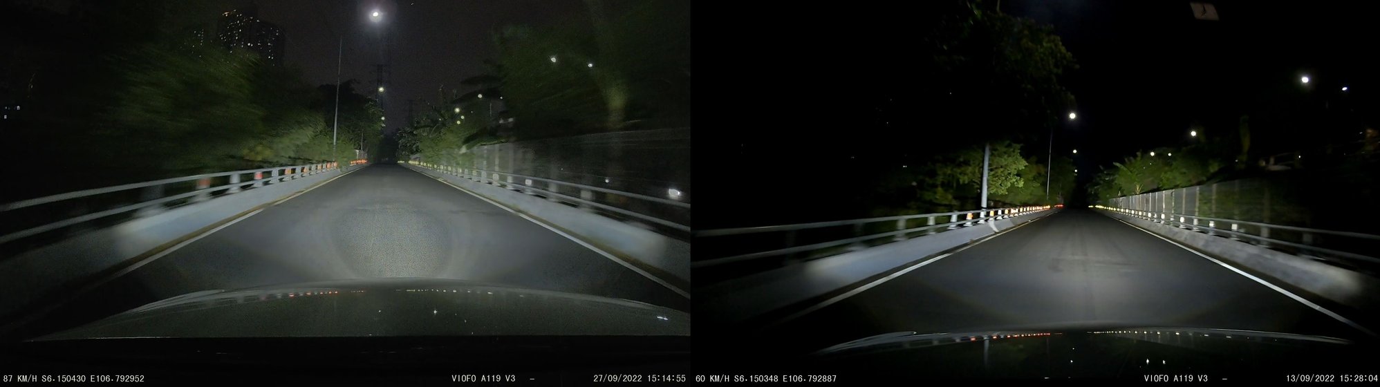

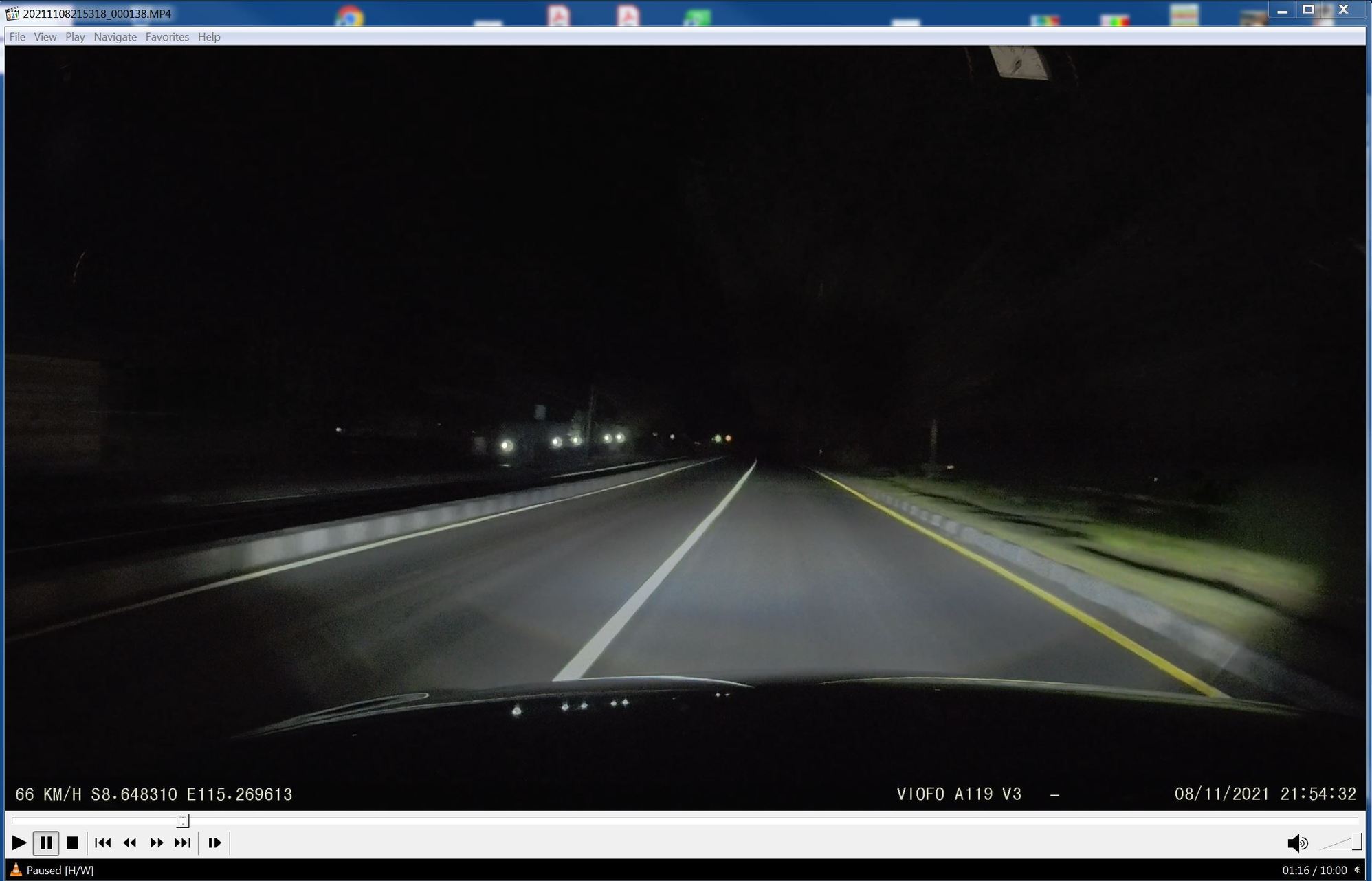

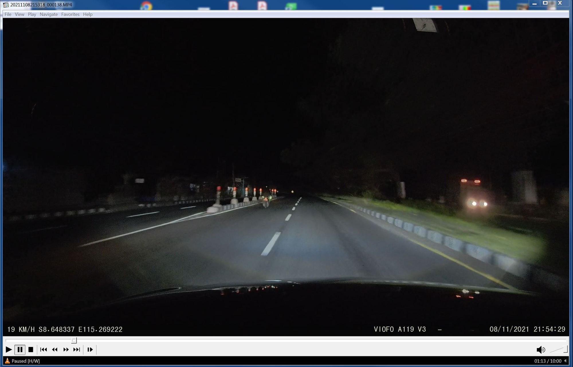

I was doing LED BAR beam trajectory calculation based on nice near 100 KM test drive last nite. This is to also stress test the engine.
Its a new highway I never tried, kinda poor road joints quality , but okey if upto 120KM/H at its worst areas, some joints is OK to do up to 180 KM/H.
This is where the Bilstein B4 front and B6 rear shine on this yoyo-jumping.jack kind of PAID HIGHWAY
Nice cops in a stationary patrol car, I passed them by at 170KM/h ( 105 MPH ) and they are cool, ignore my old-man car with no loud exhaust and I was going straight and not zig zag like a maniac.
This is what I love about Indonesian traffic cops, they are very understanding

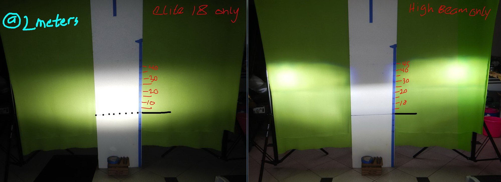

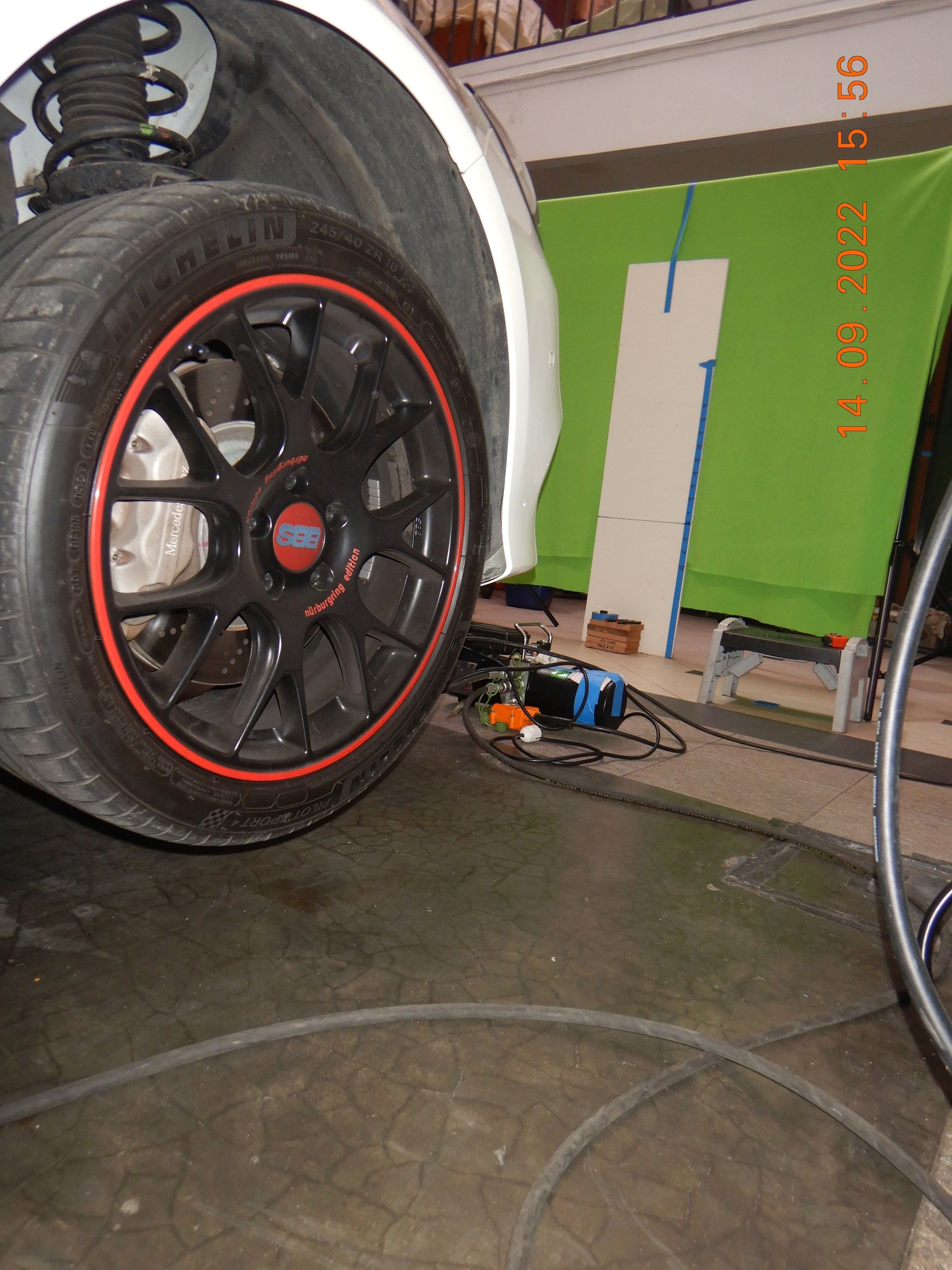

Fine tuning the beam height..........
Car on level 1 lock, Quick Jack. Approx 20 CM jacked-up height.
First installed, I set it this high :

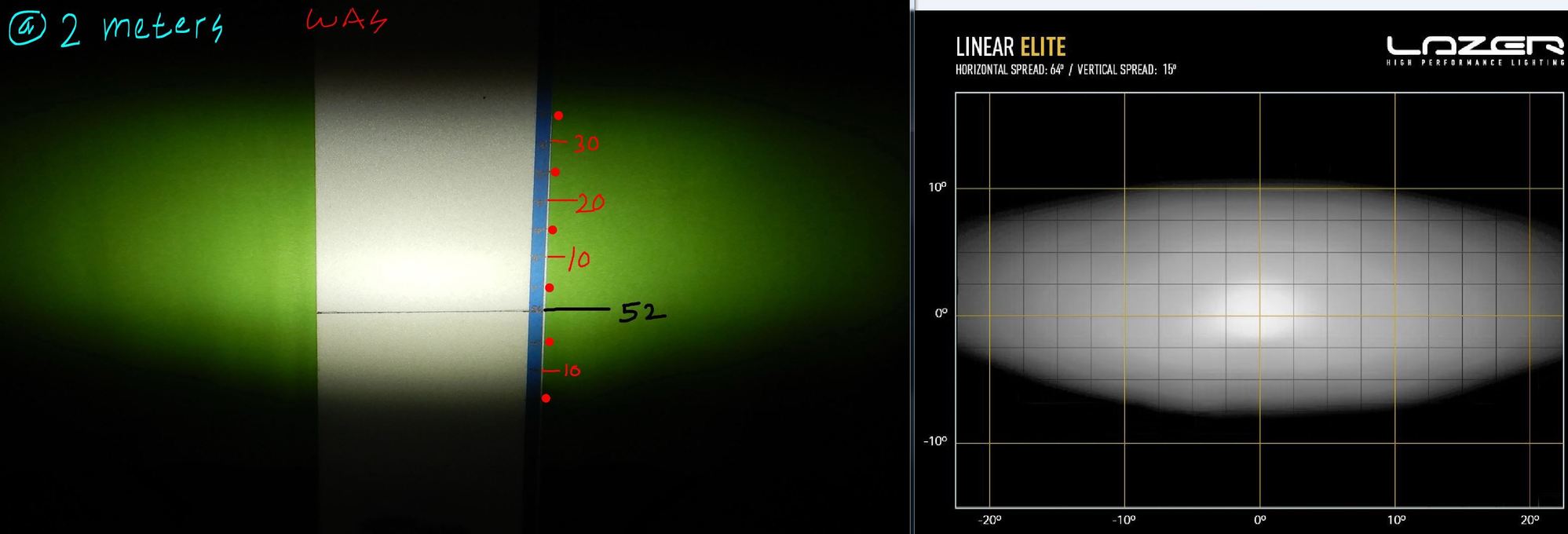

Note : LED BAR on a Quick Jack level 1 is now at 52cm above floor. On the car itself if on the ground, it is 32cm from the floor. So 20cm worth or rise by Quick Jack.
All values are in meters or centimeters.

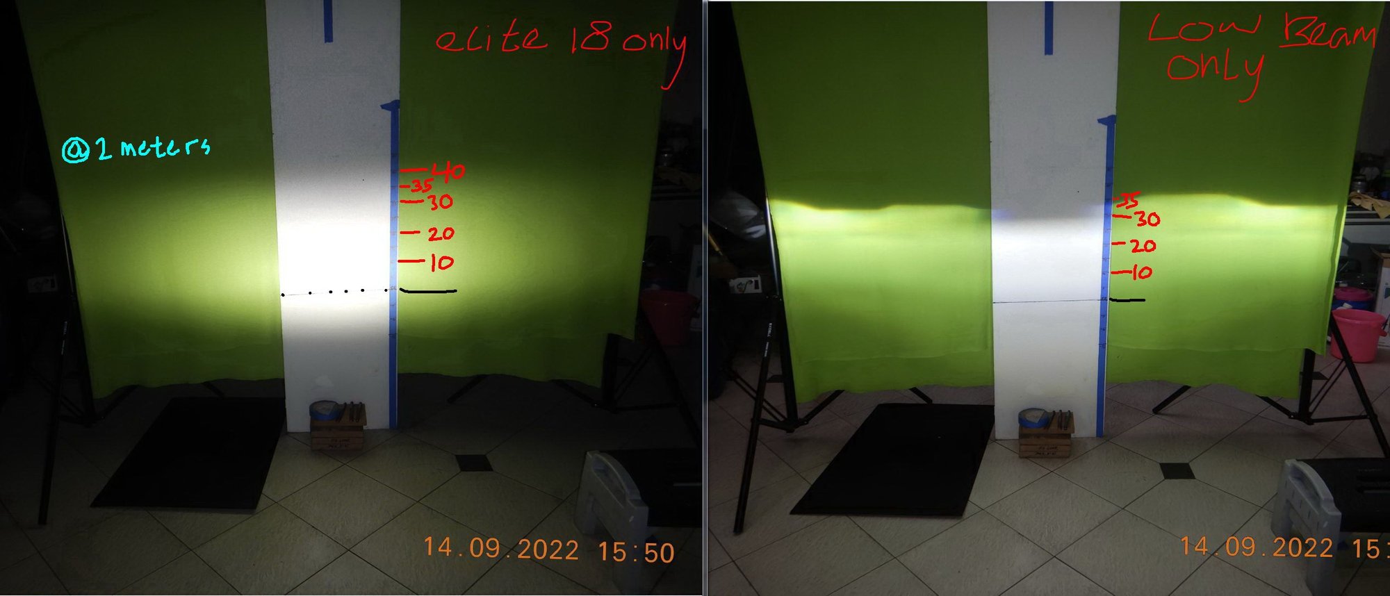

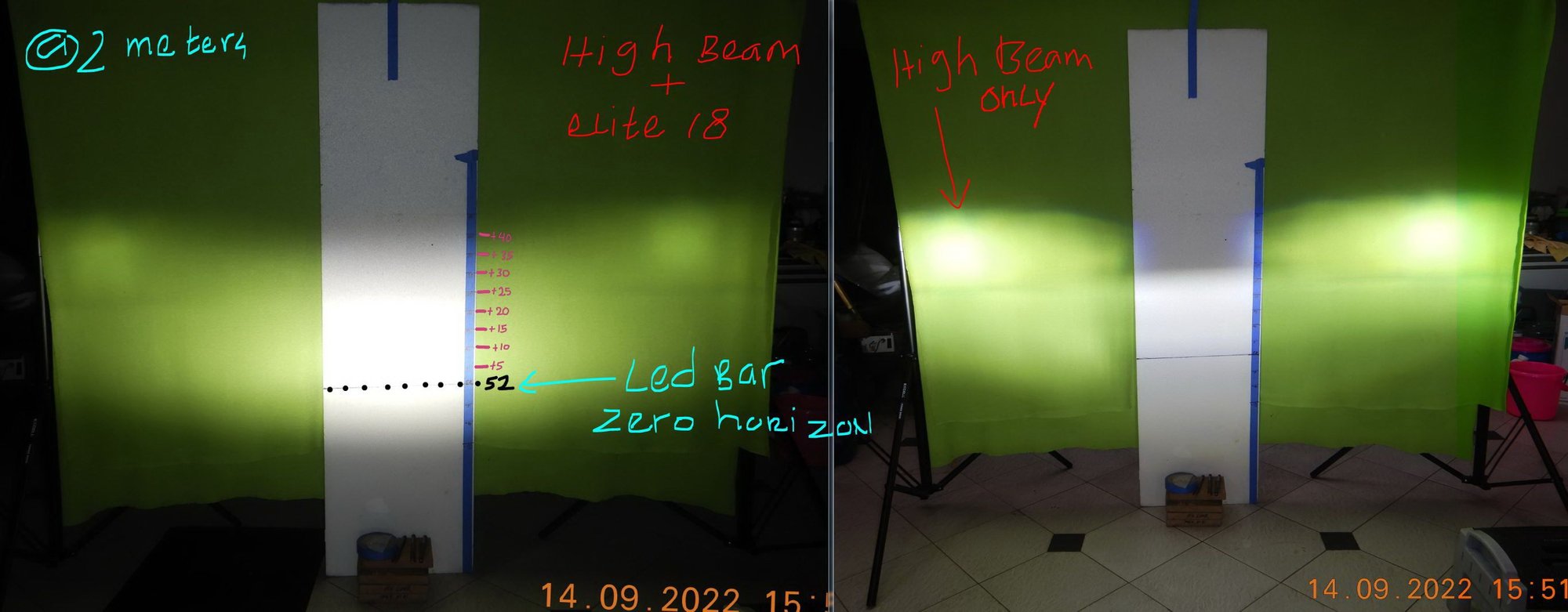

Low Beam
High beam
I manual set my pocket camera exposure to see the brightest region.
Was this high...
Its difficult to take photo of beam spread and different level brightness to represent what the eye can see. Below brighest zone is at zero to 10 cm above horizon ( 52cm black line ) as per my eye.

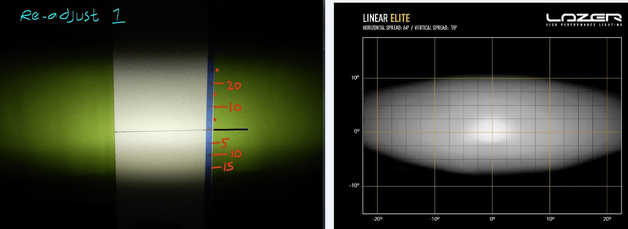

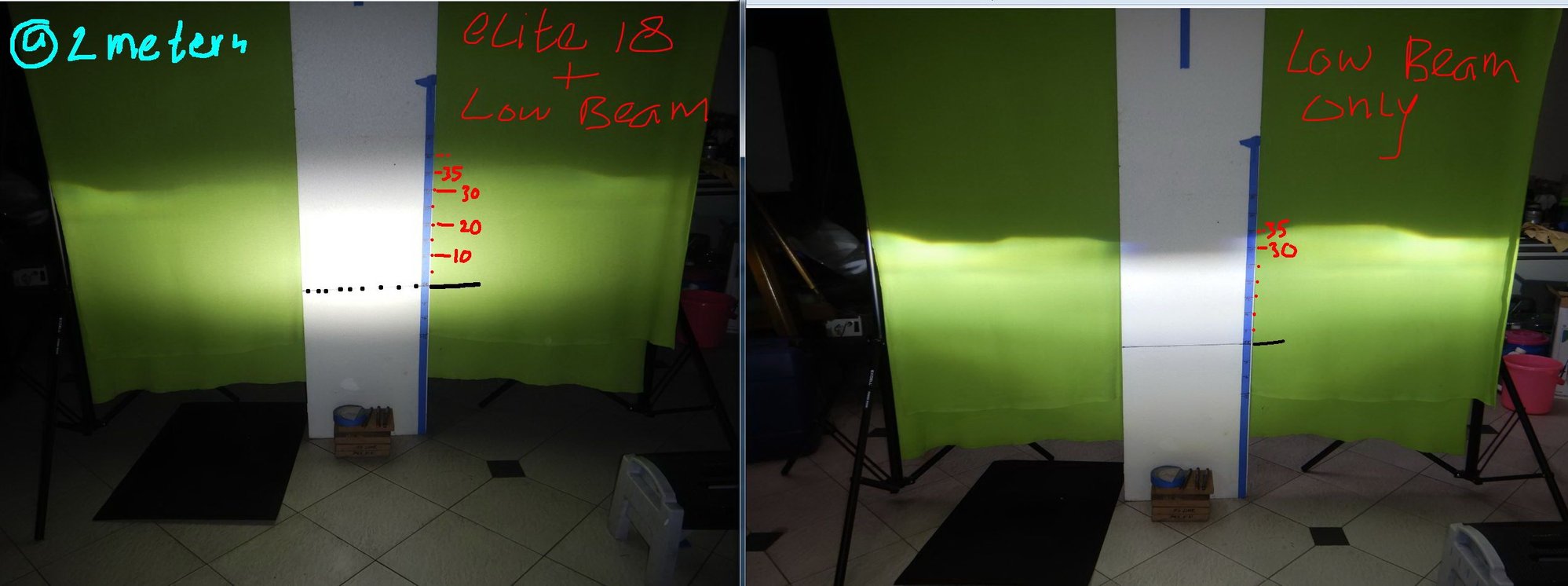

I set lower now. The brightest zone is now at +5cm to -5cm from black line 52cm LED bar zero horizon.

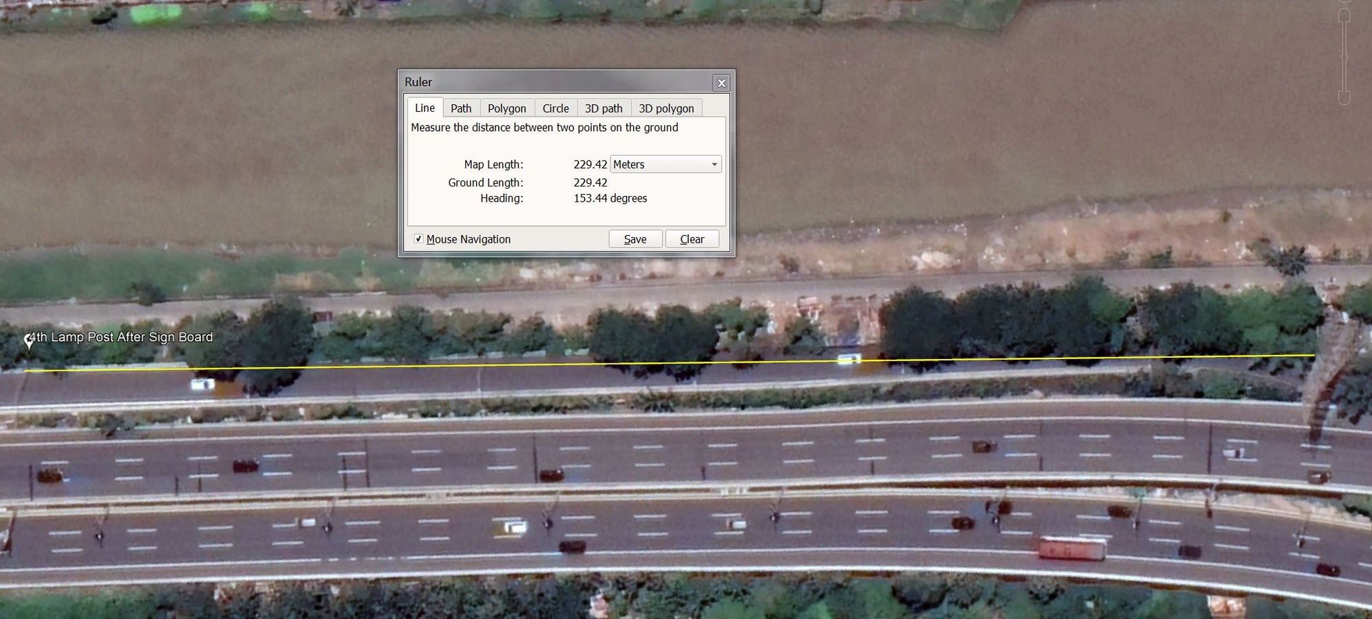

I was calculating for 200 meters distance, I must have the brightest zone be at height coverage of approx 3+ meters above a flat ground. The perimeter beam will be higher than this.
The now lowered beam overall is approx at the red zone/box and the brightest zone is the blue zone I marked. Its top side perimeter beam is about 5-6 degrees above zero horizon of the LED Bar.
The 9 degree was approx where it was initially set at.
I target 200 meters for braking from 100 MPH + 1 second response delay on my part and 25% extra safety on top of all combined distances.

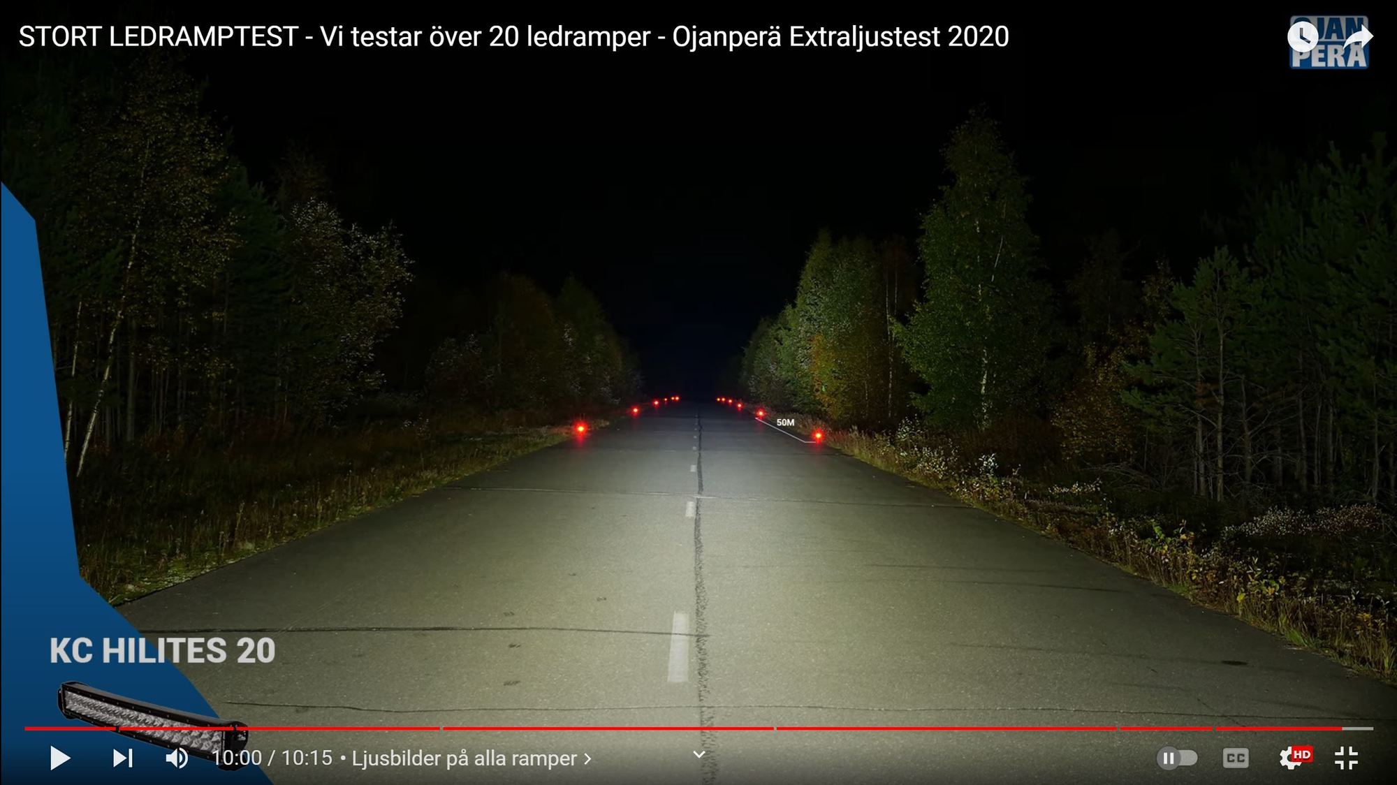

2015 Car & Driver test was on a 4 matic E400 and only 70MPH, not up to 100 MPH.

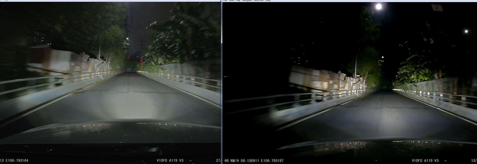

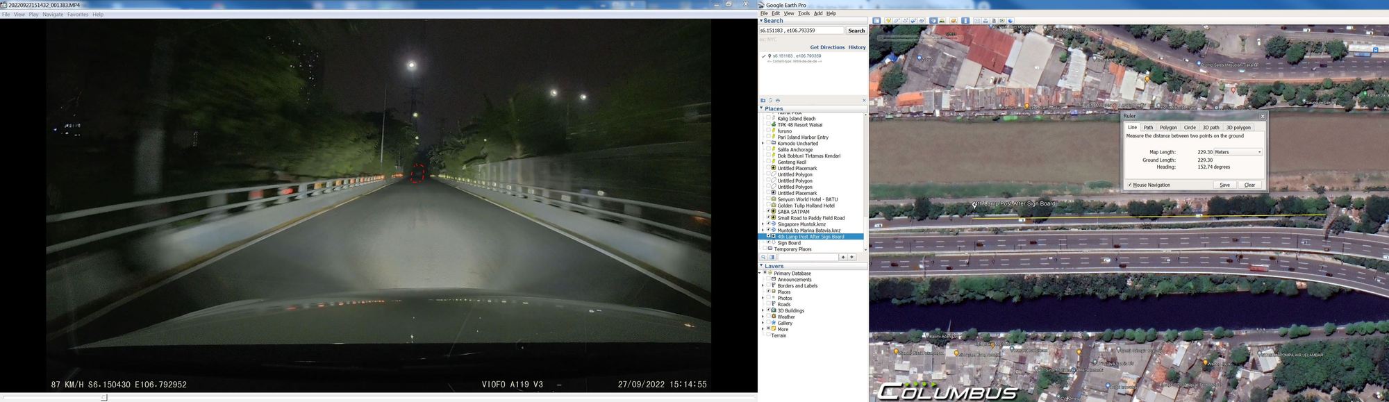

The height adjustment result, is the LEFT PICTURE.
Top picture is the adjusted height
Well, its not bad. I think if I can raise 1.5 to 2cm at 2 meters from current adjusted value, it can be better.
For now : Objective achieved, 200ish meters distance object to be visible and beam not too high
Naked eye is much better than what my camera can capture.
Note : The GPS module on the dashcam is very slow updated into the video data stream , so it is not good for positioning if car is moving above 30KM/H. If stationary, it is very good.

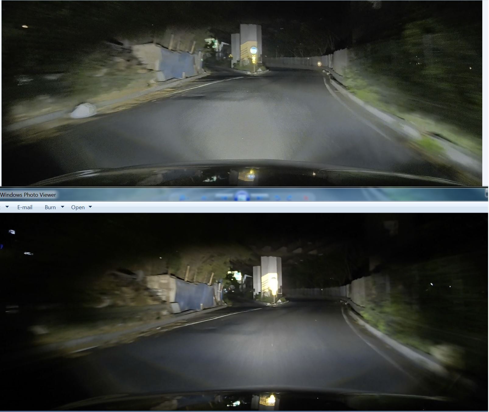

The brightness is poor for MB Dynamic ILS LED. 35 watts x 2 from a old gen LED module is too lame.
The setting MB Indonesia did for my lights is polite, very polite I agree. So I just keep it that way.
The LED bar is more for long distance driving and a RUDE version of me

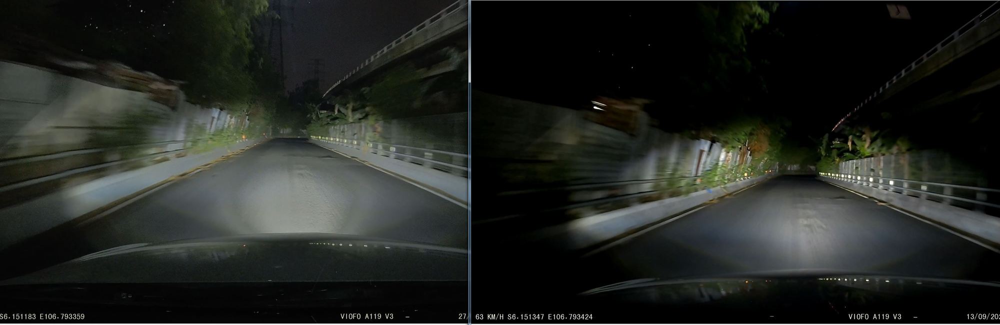

Next time in real life you should compare this Lazer 18 Elite with your ILS LED headlight when you have the chance.
The dashcam can't capture 100% of what is going on.
