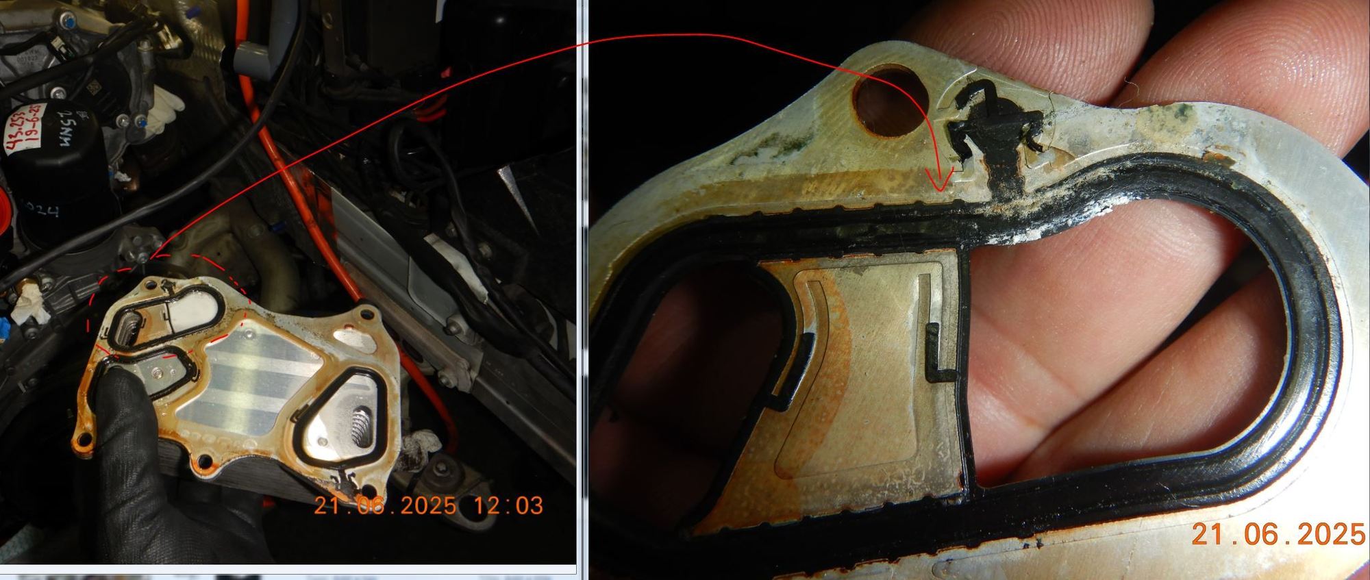

At 43,000KM by mid 2025, this is my engine oil cooler gasket.

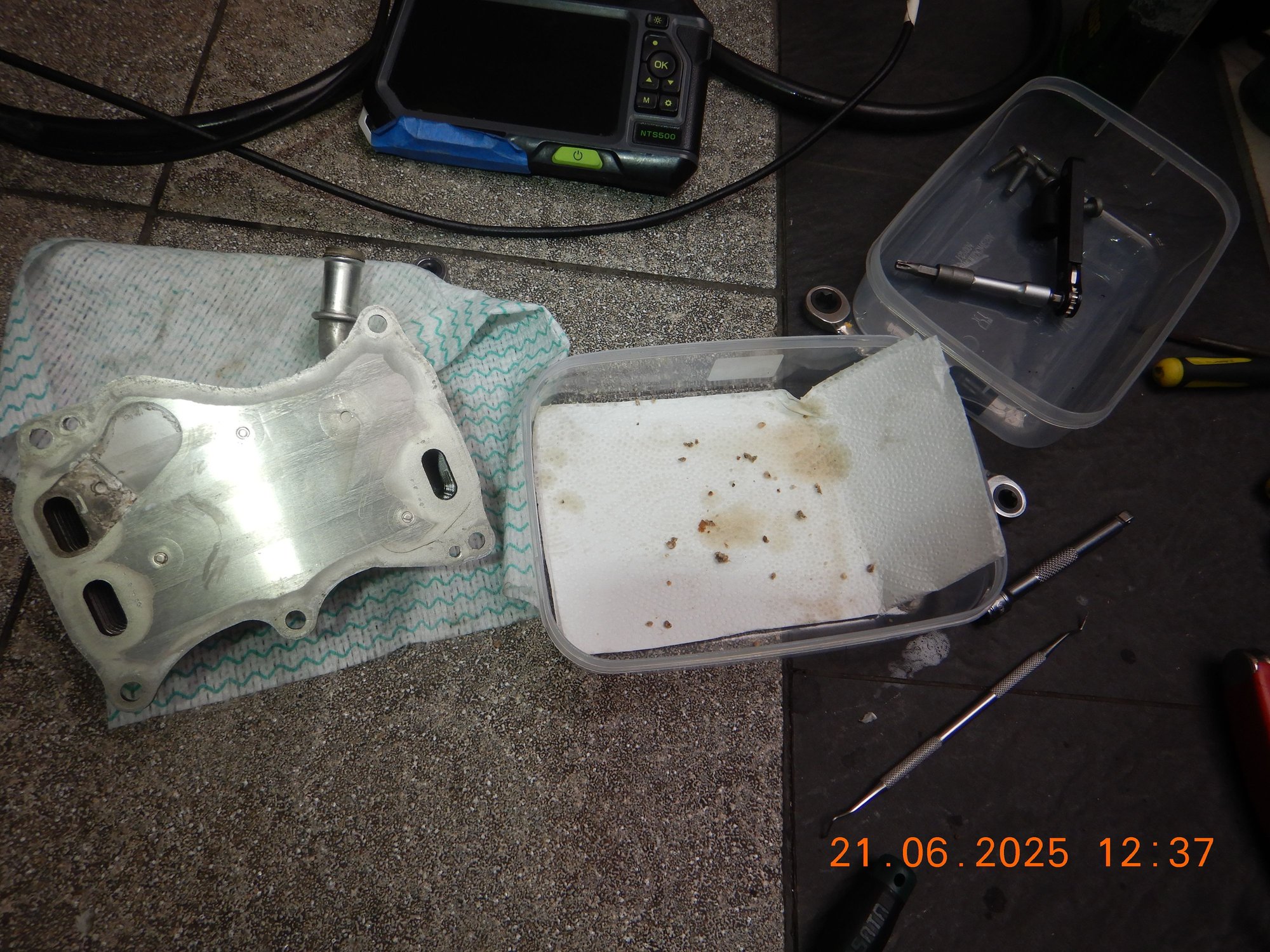

Above job is a very long story.......... in a post in late 2025. New engine oil cooler in the end, not only the gasket.
Post #33 : https://mbworld.org/forums/e-class-w...ml#post9179304

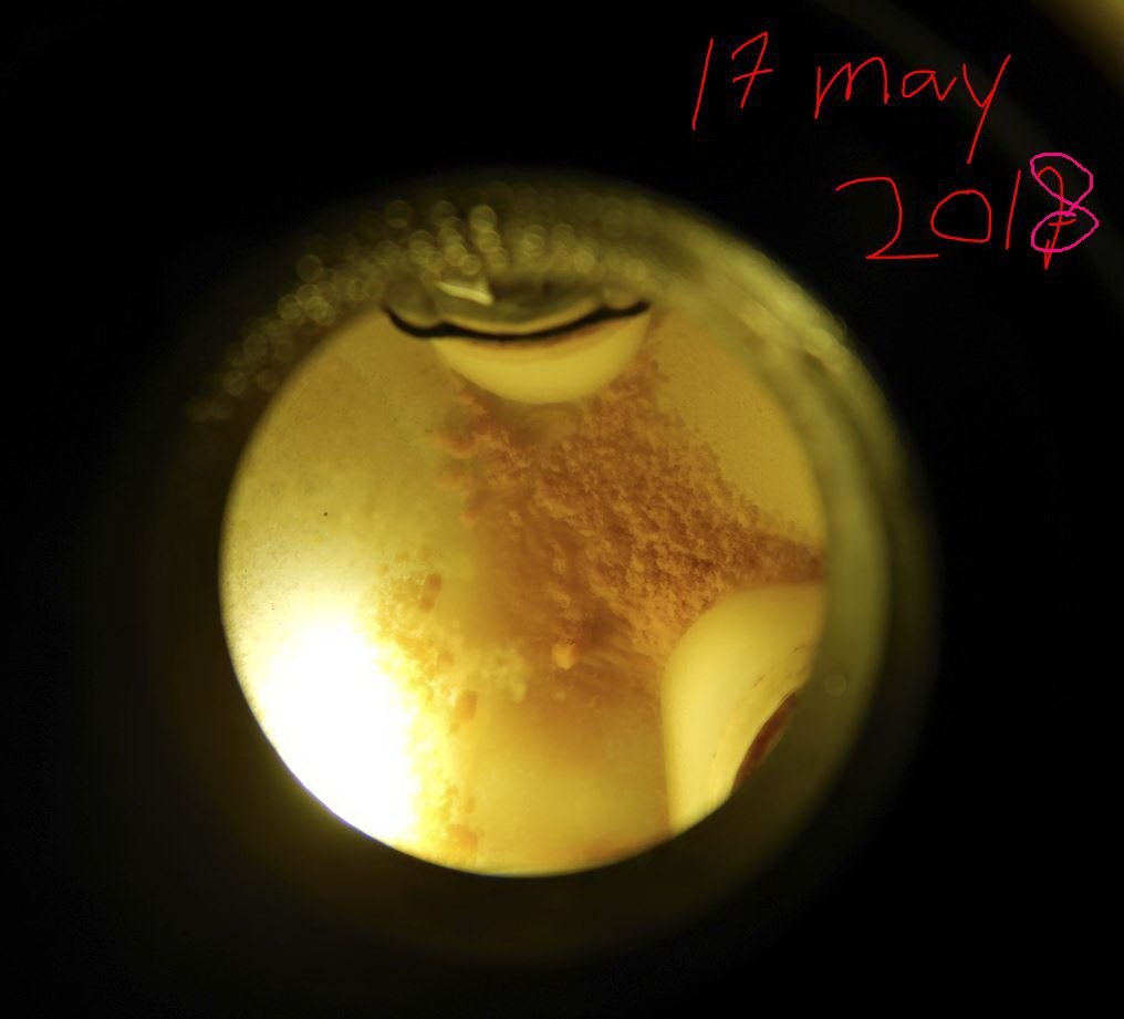

The fault lies with poor water quality MB Indonesia uses to mix with the coolant and the coolant was not 50%, my best guess is 25% at best which can make it acidic. Glycol is a complex thing.
This car original coolant was the yellow one and not even blue one, when I bought it in May 2018.
That meant within June 2014 1st owner, to my ownership in May 2018 at 10,000KM and till coolant change to blue one in Aug 2018... the damage is already DONE.
This is the story, the hand written date/s on the photos should be 2018 and none should be 2017, because I got the car in May 2018.
https://mbworld.org/forums/e-class-w...i-am-sure.html
So within just 4 years and 10,000KM only, the damage is all over the cooling system, and only known 90% of the truth in late 2025 and

But for the sake of this post intention, I am repeating : SEAL WILL GO BAD, regardless of good distilled water being used 50/50 with good coolant.
In my case the seal damage is accelerated due to scale build up.

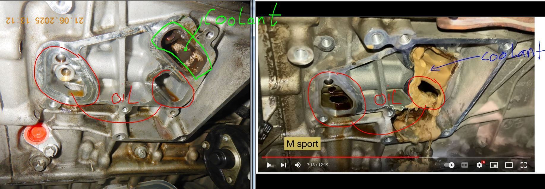

These are the actual oil and coolant path. The 2nd coolant path uses pipe, at the body of the engine oil cooler.
My own engine is on the LEFT image.
This pipe out of the engine oil cooler body as the 2nd coolant path.
