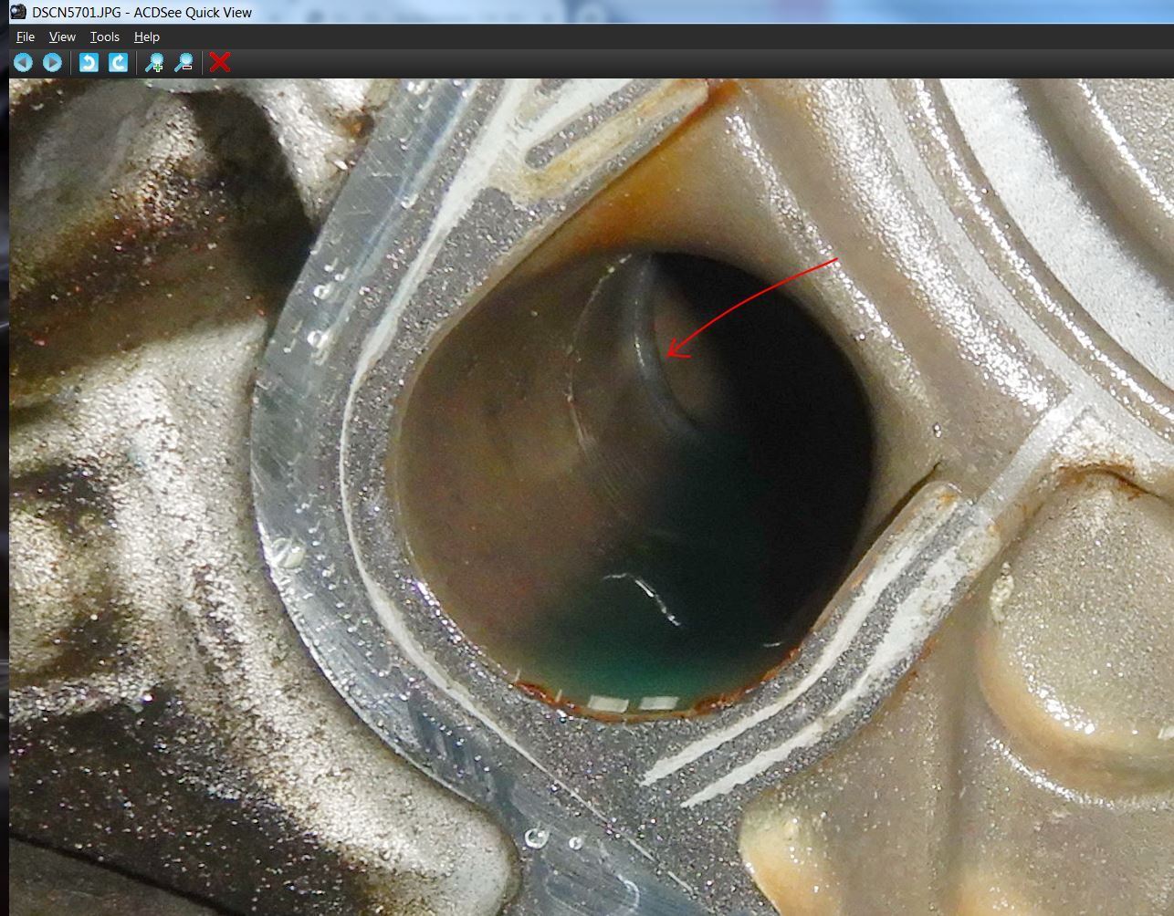

I was looking at M113K engine tear down due to DEEP HIDDEN located coolant o-rings leaking and causing engine oil dilution with coolant and I realized our
engine should have similar o-rings to allow coolant from engine block to cross the timing belt region and to the mechanical pulley driven coolant circulation pump.

Above, when one remove the mechanical pulley driven coolant circulation pump, this is how the coolant channels look like.
So the coolant circ. pump resides on the lower timing cover.
In order for coolant to cross timing chain area which is engine oil lubricated area, there is a need for o-rings for the lower timing cover to mate with engine lower/main block.

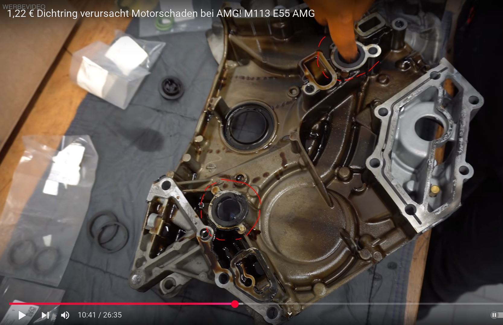

Master Tasos has a very nice complete video on a W211 E55 using M113 with this o-ring leak and complete teardown videos.
E55 W211 AMG supposedly was built between 2002 - 2009.
Tasos video was in 2021.
So oldest this engine can be is at 19 years old during the complete failure ( broken and partial lost of the o-ring ) or youngest is at 13 years of age.
16 years old as mid age.
Part 1 - steps to verify if this is a head gasket issue or the 2 notorious timing cover coolant o-rings
Part 2 - the pressure test, for the 2 notorious timing cover coolant o-rings
Parts 3 - Inspection of the failed o-ring
Here in detail we can see the front subframe removed,power steering removed, engine is hanging on engine support bar.
Plastic bumper and its aluminum bar removed, all radiator + evap + etc etc removed , in order not to do engine out job.
I spoke to my indie and he said the exact same set up to Tasos if one do not want engine out set up.
Part 4

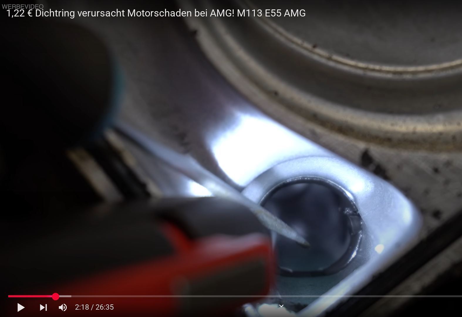

If I hear it correctly, Tasos mentioned that M157 equivalent coolant 2 o-rings are not located like M113 ( or M276 ) inside the timing chain lower cover.
It is outside of timing chain lower cover, so if the o-rings leak it is not going to go to engine oil region....that is nice.
At 1:13 ( part 4 ) He also mentioned that this M113 o-ring groove design has no inner diameter lip/flange to help maintain o-ring shape like how M157 has a bit higher inner lip.
Its true of what me mentioned, o-ring groove design in M113 is bad. Too bad MB repeat the same M113 sh-iet in M276.
This is basic o-ring groove design guideline for face seal which is the duty of those o-rings in discussion :
https://www.marcorubber.com/o-ring-g...-face-seal.htm
Notice how the OD and ID of an o-ring has to get similar support all around by the lip/flange.

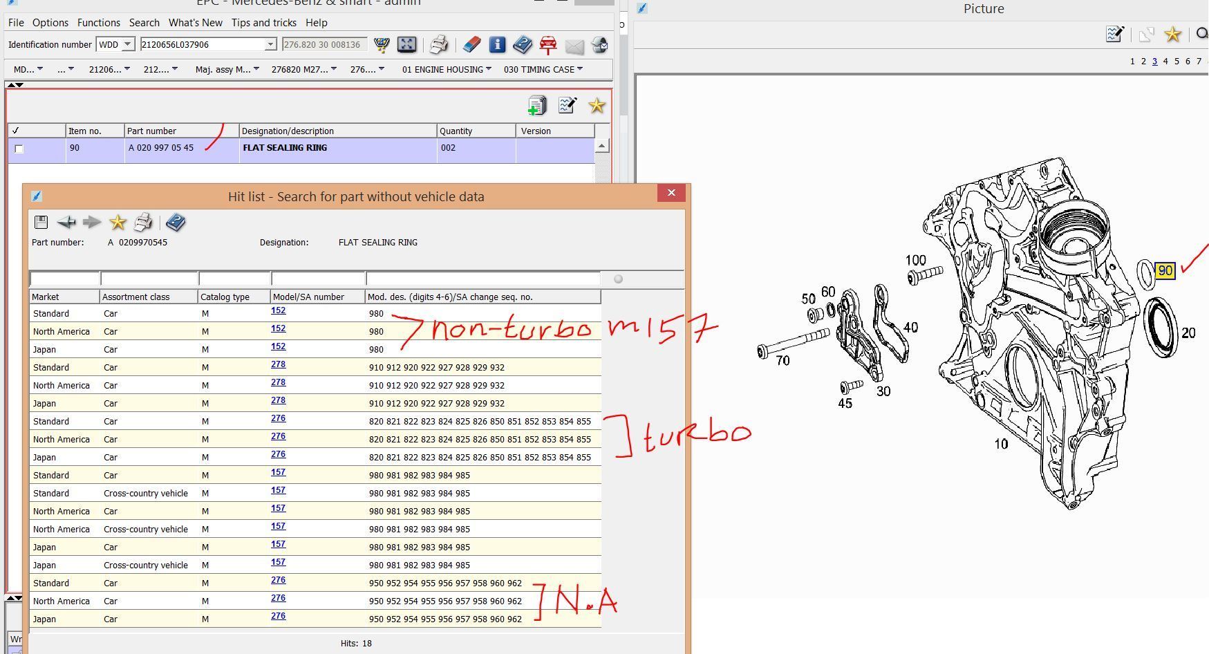

I been reading the WIS over and over again............ this 2 flat seal o-ring will need me to remove these to access :

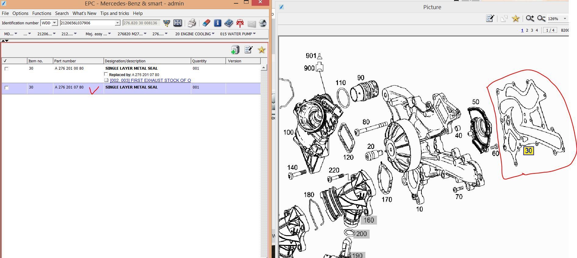

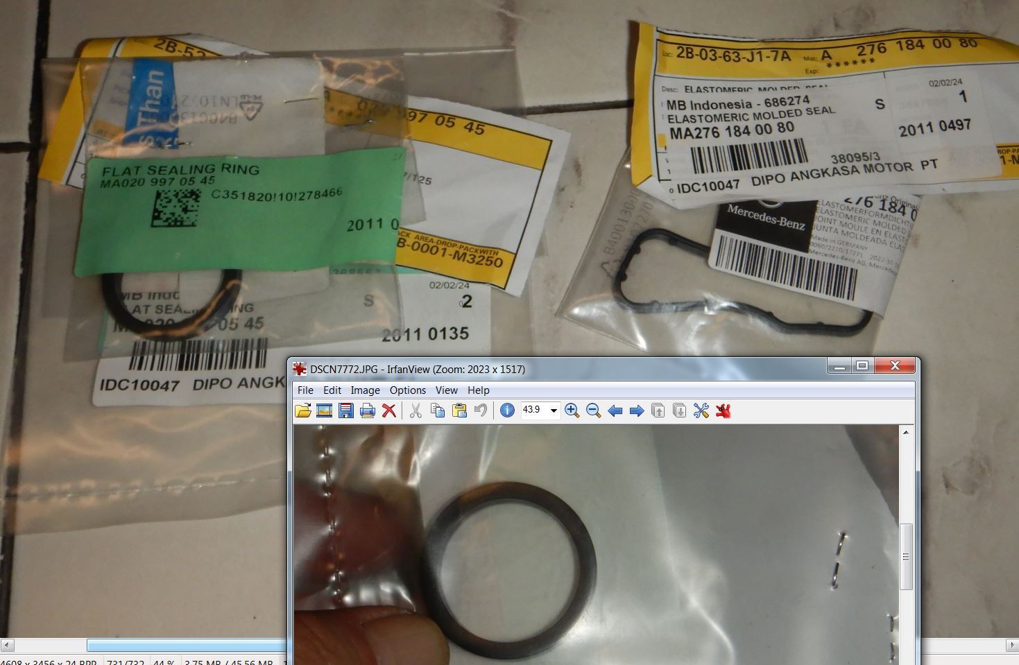

Item 16 is only US$2.00 genuine at Ebay. This is the FLAT SEAL...the big sucker !!
There was as a TSB for this similar duty seal on M278 and M157 engine. Damn. So early in 2013 ????

I am wondering : M272 has similar flat seal like M276. I mean M272 is older than M276, so probability of this seal leaking would be likely M272 owners to experience ahead of M276 owners.
I googled for coolant in oil for M272 and only get the issue with oil cooler gasket, the common one but I have yet to see the timing cover flat seal as cause of leak.

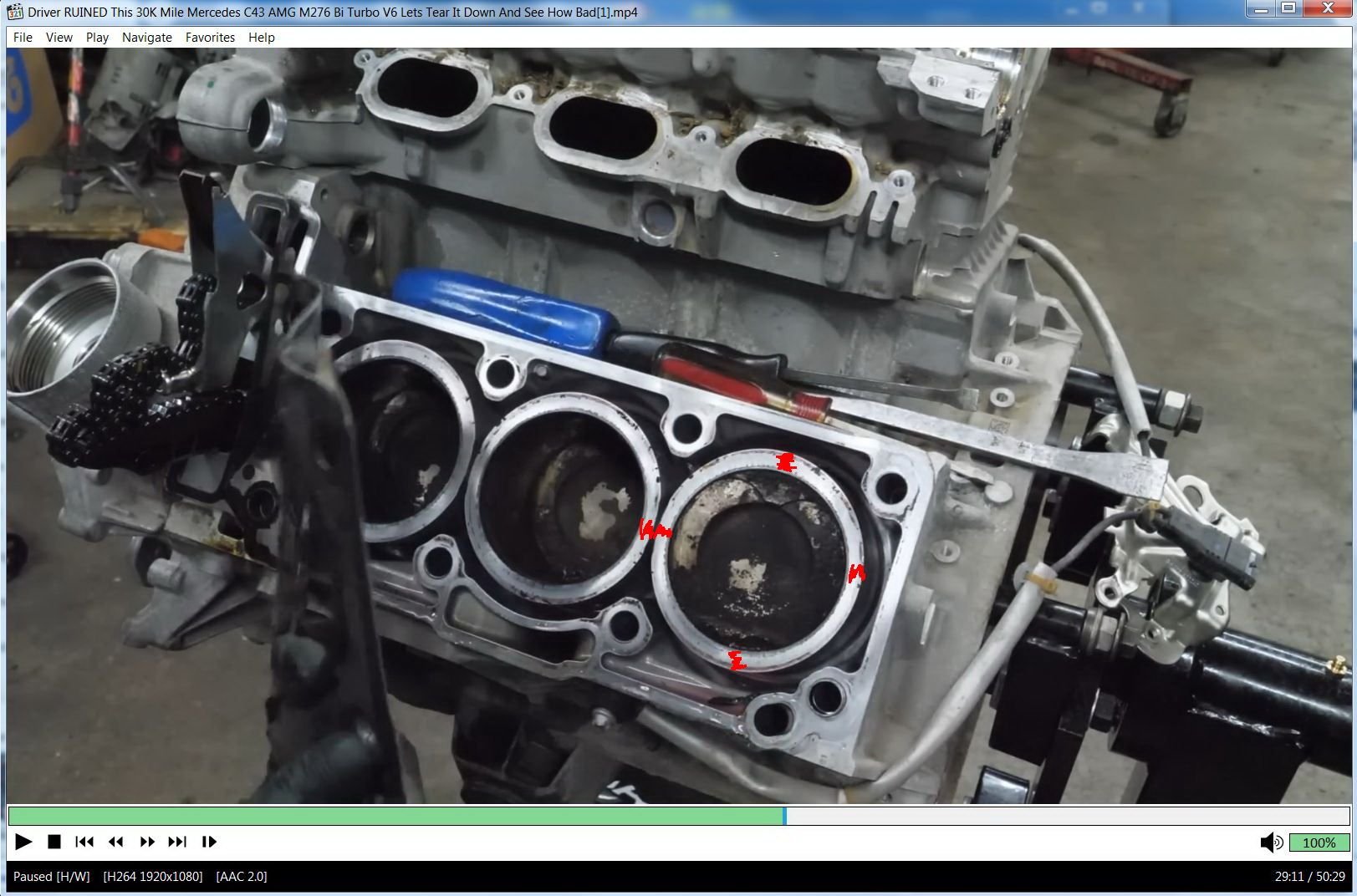

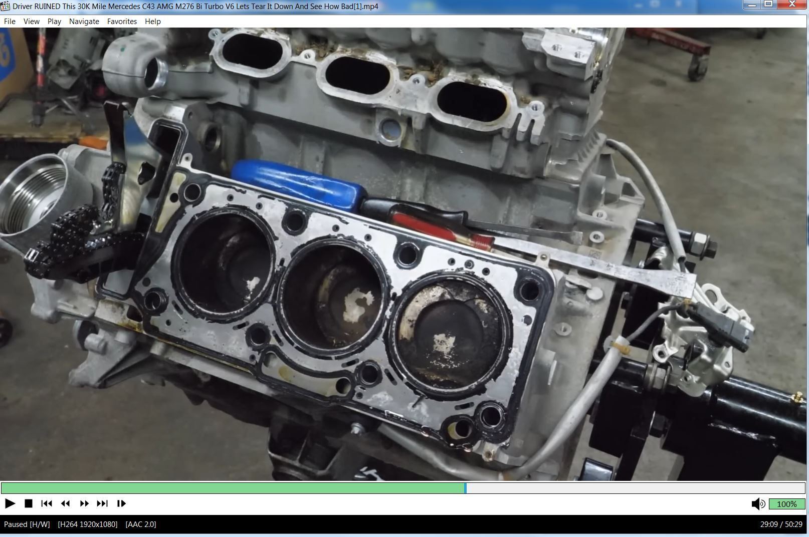

I just realized I actually need to remove both cylinder heads to access the 2 coolant o-rings inside the big timing cover.
Good think I kept watching the video over and over again....while looking at my friend's M271.8
Here is why cylinder heads must be removed.
The cylinder head gasket actually is also shared by the big timing cover.
The two bolts I circled pink/red.
.Below red line is the start of cylinder head gasket sharing with timing cover top part.
In red is the area shared by cylinder head gasket.
In blue are the 2 bolts from cylinder head interior, we need to remove the small VVT window to access these 2 bolts.
I watched the video over again because now I am too ( my Indie ) will be replacing M271.8 similar duty coolant o-ring.
My indie tech guy told me don't risk it by NOT removing cylinder head on the M271.8 Turbo, as the cylinder head gasket on this engine also over-hang to timing cover by a lot.
The M271.8 cylinder head over-hang above the timing cover is wider too than M276. So now engine is out. Waiting for stupid delayed parts.
Green is the over hang. Red is the timing cover interface area to engine block and cylinder head.
You guys owning M276 for long keep or buying old one in the future, someday will need to replace those 2 coolant o-rings at timing cover.
So be prepared.

The TSB on M278 is also the same type of seal. Item 20.
Like oil cooler/housing seal, this type of seal does not get good side support like o-ring having its own cavity.
Take a look at how the seal #20 on M278 becomes thinning and wide, because of compression and aging.
M276 3.5 NA
M272
M273
So, those flat type of seal seems to be shorter lived, by A LOT shorter than typical o-ring shaped seal.

Good news for inspection of these two o-rings.
All one need is to remove the coolant circulation pump ,gasket for it is so cheap. Radiator coolant you can drain and re-use.
I got the idea from this video, it is in German, but has English CC.
.The two holes for water pump is where the o-rings are at.
You can feel it and see if any slight expansion happening.
In coolant, this o-ring will swell overtime it seems.
Mine back in 2020. Due to MB Indonesia dumb-azz poor water quality and low coolant % mix....
YES !!!! I can see the o-ring too. Now I know how to inspect it.. Water pump removal is peanuts compared to front of engine tear down + cylinder heads and oil pan removal,
just to access the US$4.00 o-rings x 2 pcs.
This cross-over o-ring use and location-application, applies to M276 NA or Turbo , M272, and M273
M278 and M157 has its own equivalent dangerous molded seal at timing cover, as explained in post #14 above.
Engine using the same P/N cross-over seal in discussion.
Indeed FLAT seal, no circular body like typical o-ring.

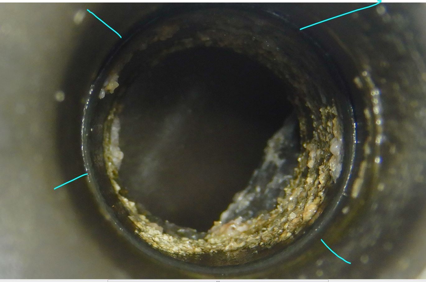

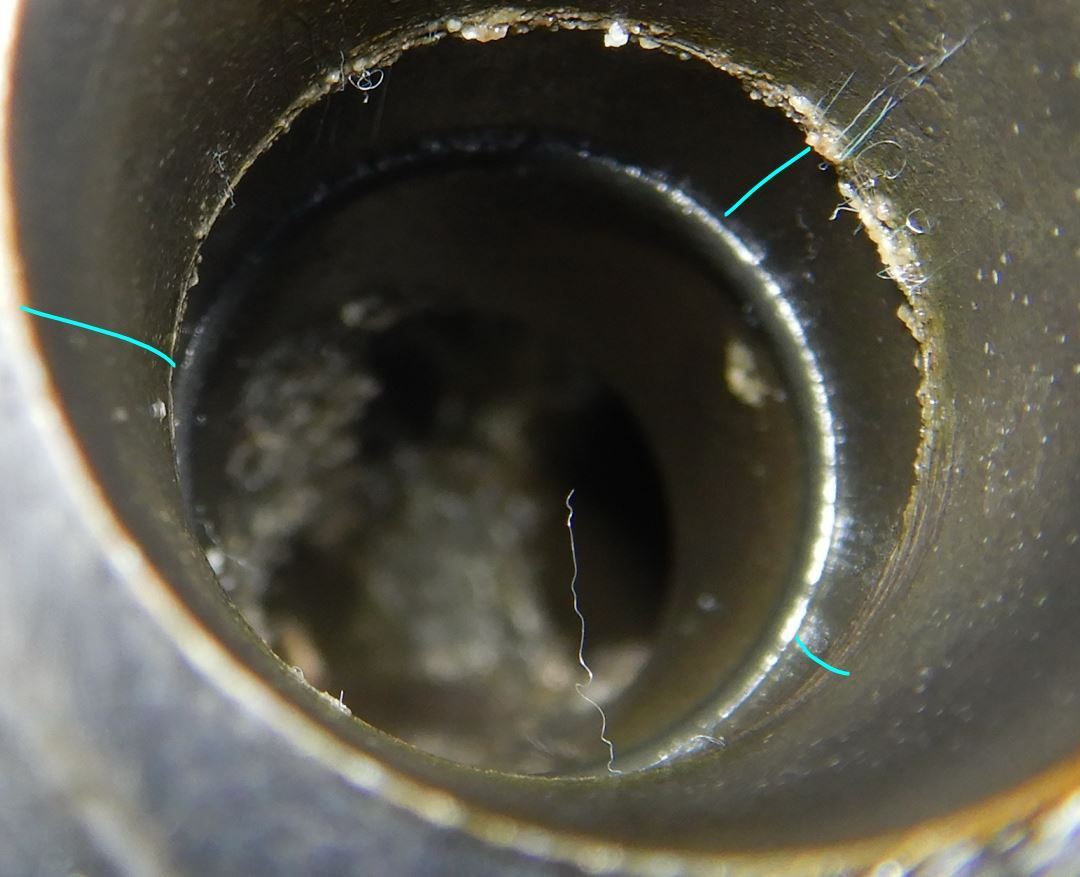

see more scale build-up at the water cooling jacket of the block. I also worry my engine's cylinder head gasket coolant path maybe having pitting corossion like engine oil cooler.
I worry of this gasket sealing region , if not the liner itself:
Anyway, back to the deadly o-rings, 2 of them :
I can see them on the late 2025 job I did. Post #36.
https://mbworld.org/forums/e-class-w...ml#post9179314
Looks decent still. BANK 1.
BANK 2
I hope when I do replace these two o-rings in 2028 - 2029, it still stay proper healthy .
