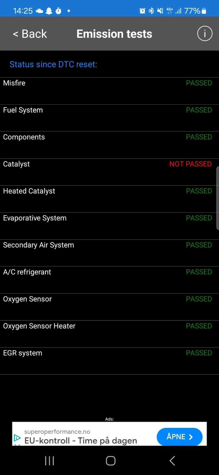

I have suspected the PCV and the cam plugs for a long time. My engine has had the tendency to drink a lot of oil, but without visible signs of leaks. I park in my garage so I would see something on the floor if that was the case. I also understand that it's not uncommon for these parts to fail on the M272 engine, which also can cause P0171 and P0172 codes,
Maybe it's unrelated, but I randomly checked emission status and got a FAIL on the catalyst.
Old Apr 14, 2024 | 01:05 PM
CaliBenzDriver's Avatar
Joined: Apr 2019
Posts: 11,923
Likes: 6,776
From: Silicon Valley
W212 MY'14 M276-3.5NA @75kMi
confirm fuel pressure yourself
You have lean faults and you reported your mechanic tested fuel pressure and intake leaks.
In addition you're getting catalytic monitor incomplete.
You're now suspecting PCV or plastic cam plugs.
At this point... I would take 5mn to read your fuel pressure for yourself before considering PCV replacement job.
Use your scanner to check fuel pressure both at base idle and also under engine demand to validate filter is not saturated by tank particulate.
You can ignore catalytic status because engine management is unable to run normally. After faults are fixed cats will get a chance to burn off contaminants better.

Old Apr 14, 2024 | 02:21 PM
Andreas B's Avatar
Joined: Dec 2020
Posts: 53
From: Oslo, Norway
W212 E350, W208 CLK320
I can't find the fuel pressure levels on my bluetooth scanner. I would like to see how the readings look because I want to solve this problem now. However, I got interested in the PCV because that can throw a P0171, P0172 code in addition to my oil loss. It is very rare, but sometimes when driving in higher speeds at longer distances I can smell a little sulphur/egg probably from the cat. Is this because there is too much oil getting burned, and the cat is unable to properly take care of it?
