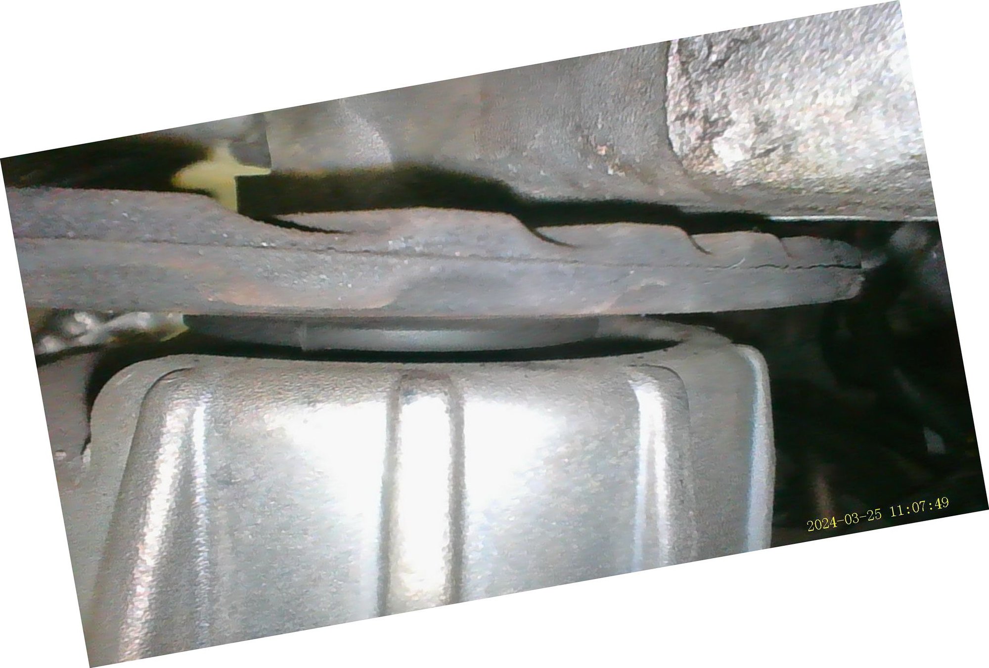

Easiest to see is tranny mount. A mirror can help, or a boroscope.
When I bought the car pre-owned, in May 2018. By August 2018 I reset the mounts, all 3 replaced.
Unloaded visual, using tranny mount mounting holes as reference to the sinking of the mount.
Unloaded, side my side.

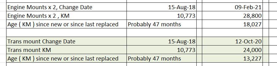

The then new one in Oct 2020, by today 15,500KM later or car mileage 39,500KM as per 25 March 2024
As per my previous calculation, I would say that maximum 25,000KM of use for best comfort will still be my target.

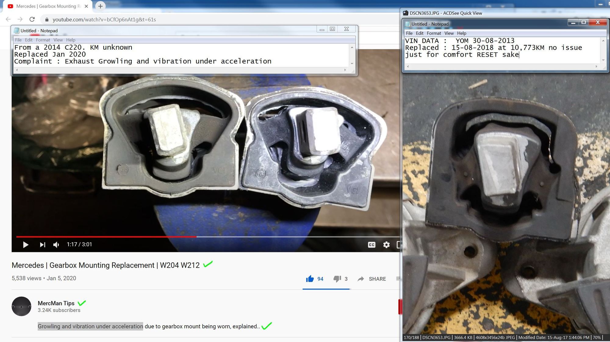

Below LEFT is a Youtube sample of a guaranteed "kissing" mount to its bottom side when loaded with tranny weight. So vibration is guaranteed.
The RIGHT side is my very 1st mount original to the car, when it was replaced on 15th Aug 2018.

My LEFT side, also 10,500 KM driven, same as RIGHT side one.
Engine mounts is good comfy to 25,000 KM too for me. I am hyper sensitive to "vibrations".
