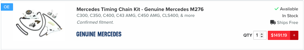

A kit from FCP Euro with all genuine Mercedes parts, minus the timing chain and cam sprockets is about $1500. The timing chain is OE. Add the sprockets for about another $2600, for a total of about $4100 for parts. $6300 for labor at $185/hour works out to be about 34 hours. I think I'd get another quote or two.
