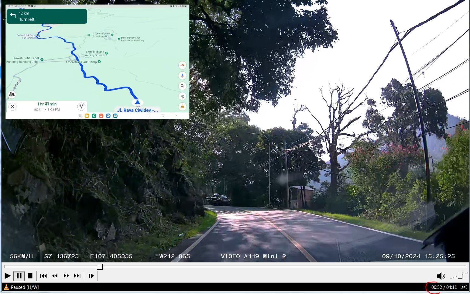

The obvious B4 good steering response one would be at these video minutes :
These 3 seconds, top image and bottom screen capture.
If your eyes is fast enough, you can see in video I was avoiding this rock from the car "shake".

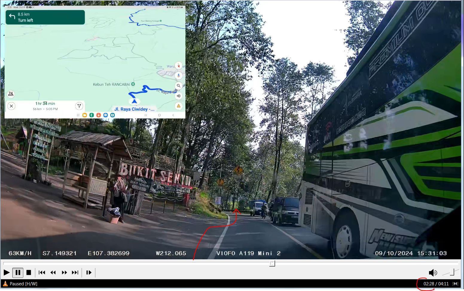

This one is smooth-quick lane change to avoid the bus, my left tire has to cross over the white line end of lane limit, no choice and I was fortunate there is tarmac there ( entry to a resort )
and not grass or rock or ditch.
After this bus, the next left corner also shows the steering response from B4 and PS5.

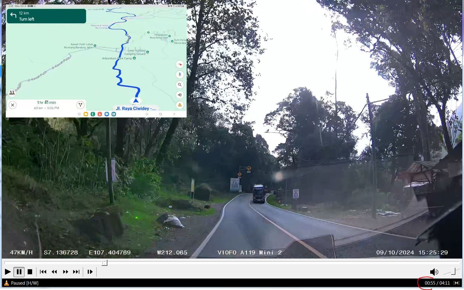

https://cimg8.ibsrv.net/gimg/www.mbw...cf80899a9c.jpg
https://cimg9.ibsrv.net/gimg/www.mbw...b8884f55fa.jpg
https://cimg4.ibsrv.net/gimg/www.mbw...5a0e195a1f.jpg
https://cimg5.ibsrv.net/gimg/www.mbw...2436e78f83.jpg
https://cimg7.ibsrv.net/gimg/www.mbw...bf52f2372e.jpg

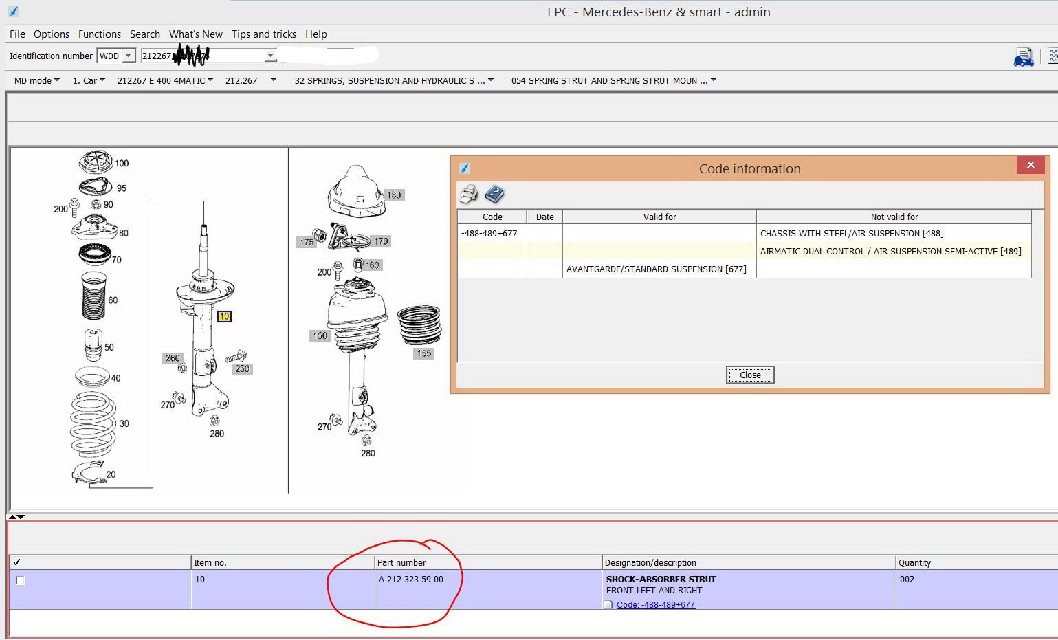

Bilstein doesn't like the E400 S212 :-( Both my country's distributor and Bilstein's corporate website do not have listings!
Give me your VIN, I will try to check with EPC
thanks, message sent...

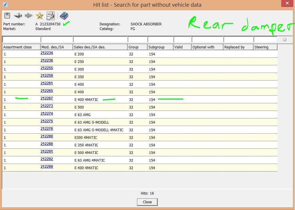

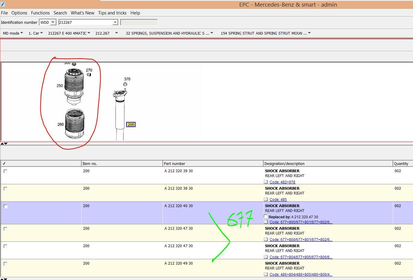

Aha, E400 Wagon for rear spring is air spring, never steel spring...wow, I never know that.
Ur model is 212.267 and suspension code is 677
Your Rear Damper A212 320 47 30 is also used on these Wagons
It is just that E400 is never sold in high quantity , as such it is often forgotten by 3rd party vendors.
Adding to this misery, USA 2014 E400 is actually a hybrid 3.5NA and mot 3.0 Turbo like in 2015. So it is confusing.
And, yours being a WAGON and a 4-Matic, that is even more rare ...I mean the Wagon part.
Here is the B4 or B6 P/N you need :
W212.267 E400 Station Wagon
If B4 24-194136
If B6 24-191128
Front Damper A212 323 59 00
If B4 22-197665
If B6 35-191117
REAR - B4
REAR - B6
FRONT - B4
FRONT - B6
The Wagon rear damper seems to be different length than the sedan.
If E400 Sedan and 4 matic.
W212.067 E400 4-matic sedan, with 677 steel spring suspension and year code 804 , 805, 806
Front Damper A212 323 59 00 <<< same as your Wagon
Rear Damper A212 320 46 30
If B4 24-194112 <<< same as E400/E350/E300/E250 Sedan RWD
If B6 24-166874 <<< same as E400/E350/E300/E250 Sedan RWD
Happy shopping........

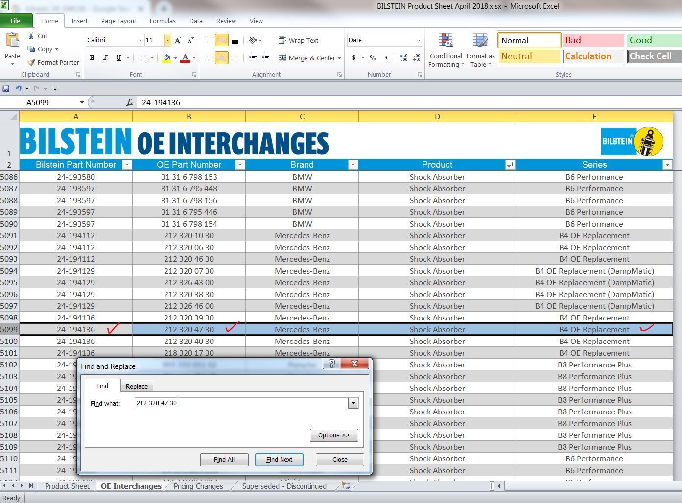

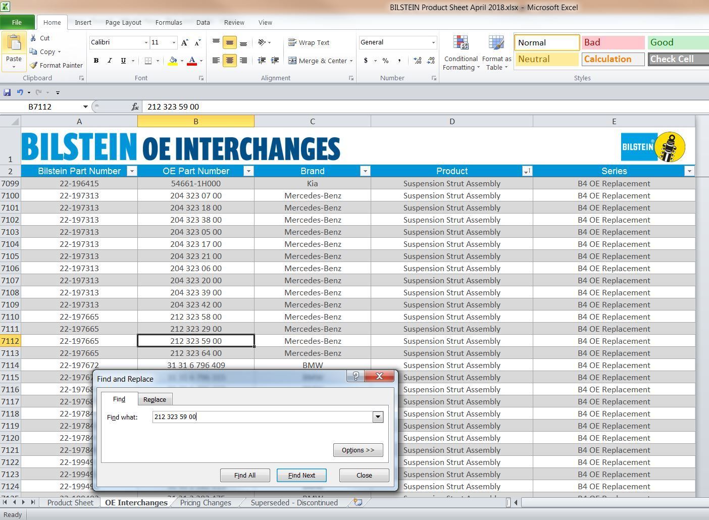

For those wanting the Bisltein file, find attached
Remember, Excel search is very specific, no space and with space makes a different.
Bilstein wrote MB part number with spaces, so you got to follow that.
Use : 212 323 59 00
and not 2123235900

Here is what comes up when I search Bilstein's International site. Still no S212 E400 so I had to query E350 fitments. The results match your recommendations except in B6 at the front. I'm beginning to think I'm driving a unicorn!
I think there is an updated P/N for front B6. Since my file is a 2018.
This is B6 based on new Bilstein P/N 22-309822 <<< I can't find this number on my 2018 file
https://www.fcpeuro.com/products/mer...17#description
Replaces Bilstein : 35-191117 ( as per 2018 file ), 22-309822
For MB P/N : 2123235800 and 2123235900
